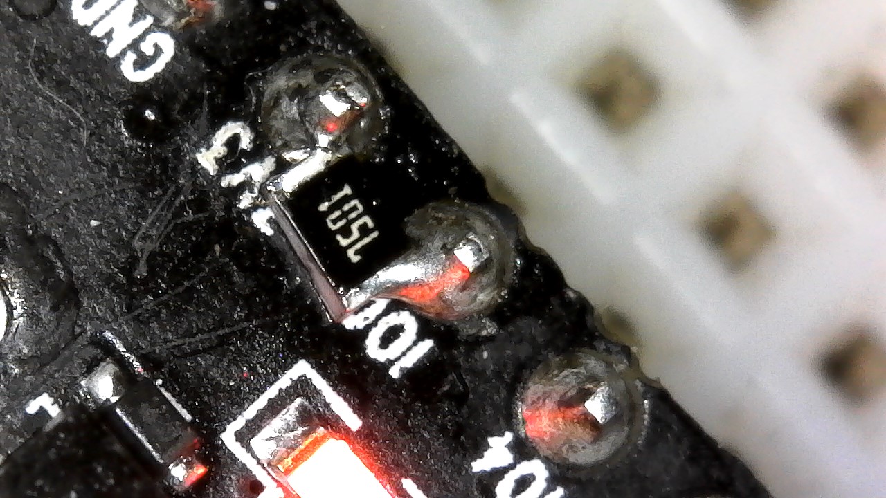

I found a solution. On other ESP32 boards there is a pull-up resistor on the EN and IO0. The EN pin on the ESP32-PICO-KIT has this pull up resistor: https://dl.espressif.com/dl/schematics/ ... ematic.pdf.
The IO0 is missing this resistor and needs to be added. I didn't have a 10K resistor, but a 7.5K worked fine for me (see attached the solution, fortunately 3.3V is next to IO0.

Thanks, for the hint. I can confirm, that this is the solution: I used a 10k resistor and it works for me too :)
