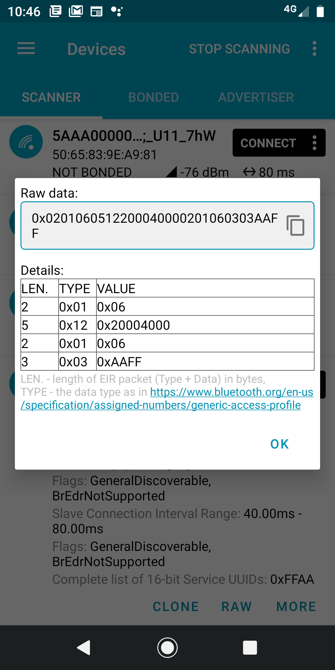

Writing a code for Eddystone beacon, but the hardware is advertising something else. Board is ESP32 Eval Module, using https://github.com/nkolban/ESP32_BLE_Arduino.
Attached a screenshot of the scan:
Complete code here:

String product_url = "bit.ly/Brizo64a";

  BLEAdvertisementData oAdvertisementData = BLEAdvertisementData();
  oAdvertisementData.setFlags(0x06);    // GENERAL_DISK_MODE 0x02 | BR_EDR_NOT_SUPPORTED 0x04
  oAdvertisementData.setCompleteServices(BLEUUID(beaconUUID));

  oAdvertisementData.setServiceData(BLEUUID(beaconUUID), std::string(beacon_data, url_length+14));
#ifdef DEBUG
  Serial.println("Service Data set!");
#endif
  pAdvertising->setScanResponseData(oAdvertisementData);
