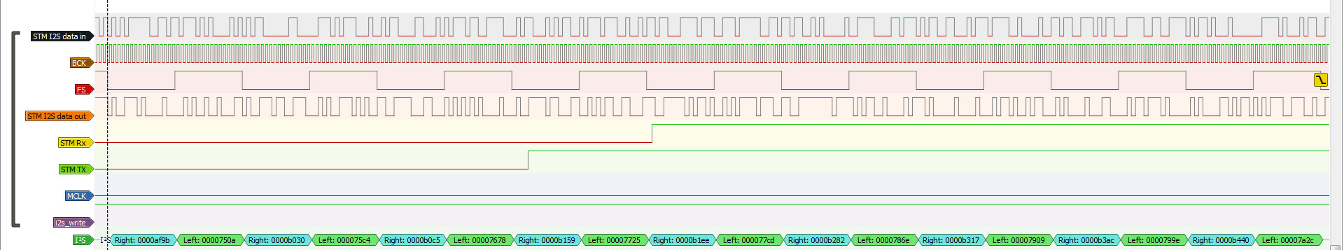

I want an ESP32 to output I2S data with its I2S0 interface in slave mode.
I'm finding that with the I2S interface in master mode, the Tx data is correct. However, with it in slave mode, and the BCK and WS (FS) clocks supplied from an SAI interface (configured for I2S) in an STM32F767 MCU, some of the samples appear as zeros.
This can easily be seen with the i2s_adc_dac example in esp-idf/examples/peripherals. Here are the signals. The top trace is the data from the I2S interface:
Master mode:
20181006 2154 ESP32 I2S Master.jpg (222.65 KiB) Viewed 77572 times
Slave mode:
20181006 2154 ESP32 I2S Slave.jpg (228.41 KiB) Viewed 77572 times
Note the zeros in the decoded I2S at the bottom of the second (slave mode) image.
Note also that the zeros replace samples; the zeros are not inserted. (I've tested this by outputting an incrementing integer. I found that 450, 451, 452, 453 typically becomes something like 450, 0, 0, 453).
I can see nothing in the esp-idf i2s.c driver file that could cause this problem. When slave mode is requested, it simply configures the IO pins appropriately and sets the I2S peripheral to slave mode.
Section 12.3 of the ESP32 technical reference says "When ESP32 I2S works in slave mode, the master must use I2Sn_CLK as the master clock and fi2s>= 8 *fBCK." I don't know whether that is relevant or not. In any case, which master is it referring to, given that if the ESP32 I2S interface is configured as a slave then the master is likely elsewhere - somewhere that it cannot use I2Sn_CLK?

Given that excerpt from the technical reference manual "When ESP32 I2S works in slave mode, the master must use I2Sn_CLK (MCLK) as the master clock and fi2s>= 8*fBCK.", I tried outputting the ESP32 I2S0_CLK to IO0 and using that to clock the STM32 I2S (SAI) interface.
Zeros are still present.
However, now every other sample is zero, as opposed to seemingly random ones.
In both the following diagrams, the ESP32 I2S interface is in slave mode, and the STM32 I2S interface is in master mode.
Here, the STM32 I2S interface is clocked from a PLL on the STM32:
ESP32 I2S in slave mode with STM32 I2S clocked at 11.3 MHz from own PLL.png (36.85 KiB) Viewed 77545 times
And here, the STM32 I2S interface is clocked from the ESP32 I2S0_CLK (MCLK):
ESP32 I2S in slave mode with STM32 I2S clocked at 11.289 MHz from ESP32.png (32.16 KiB) Viewed 77545 times
Note that in the second diagram, every other sample is zero.
So it seems that the ESP32 I2S interface in slave mode is indeed affected by whether the external BCK and WS (FS) clocks are synchronized with its own I2Sn_CLK (MCLK) clock (which is produced by its APLL). However, even when they are, even when the STM32 I2S master is clocked from the ESP32's I2Sn_CLK, and when freq(BCK) is an eighth of freq(I2Sn_CLK) as in my case, things are still not right because zeros are output on every other sample.
Any ideas?
JB.

The sample zeroing problem appears to be sample rate dependent.
To recap: I have the ESP32 configured as an I2S slave and an STM32 an I2S master. I have configured the ESP32 APLL to generate the I2S MCLK for the STM32 I2S master. The STM32 supplies the I2S BCK and FS clocks to the ESP32.
When the sample rate is set to 44100Hz, I found previously that every other LR sample from the ESP32 I2S slave is zeroed. I also found that minor changes to the phase of the BCK and FS clocks causes errors, which is incorrect.
I've since found that if the sample rate rate is set to 16000Hz or 22050Hz or 24000Hz or 36000Hz, the I2S data from the ESP32 slave is completely correct. I also found that minor changes to the phase of the BCK and FS clocks is then not critical, as expected of I2S.
If I it set to 40000Hz or 44100Hz or 48000Hz or 60000Hz, the zero / phase problem returns.
I get the same results if the ESP32 APLL is not used (though there's noticeable timing jitter when the APLL is not used).
All the results so far were with a 240MHz MCU clock frequency. They are unchanged with a 160MHz MCU clock frequency. I've not tried changing the main crystal frequency.
I don't know what to make of these findings.
Ideas and suggestions welcome.
JB2050
Posts: 9
Joined: Sun Feb 11, 2018 4:23 pm
Re: I2S: Samples incorrectly zeroed when I2S interface is in slave mode but not master mode
Postby JB2050 » Sun Oct 07, 2018 9:59 pm
Possible solution
Setting bit I2S_TX_DSYNC_SW in I2S_TIMING_REG using this:
SET_PERI_REG_BITS(I2S_TIMING_REG(0), 0x1, 1, I2S_TX_DSYNC_SW_S);
appears to have cured both the unwanted zeros appearing in the ESP32 I2S slave output data, and the phase sensitivity of the BCK and FS signals into the ESP32. I've not tested this solution thoroughly yet.
The technical reference says of this bit: "Set this bit to synchronize signals into the transmitter in double sync method.". I've not found any other information about double synchronizing.
It is still necessary to clock the remote (STM32) master I2S interface from the I2S0_CLK signal of the ESP32.
