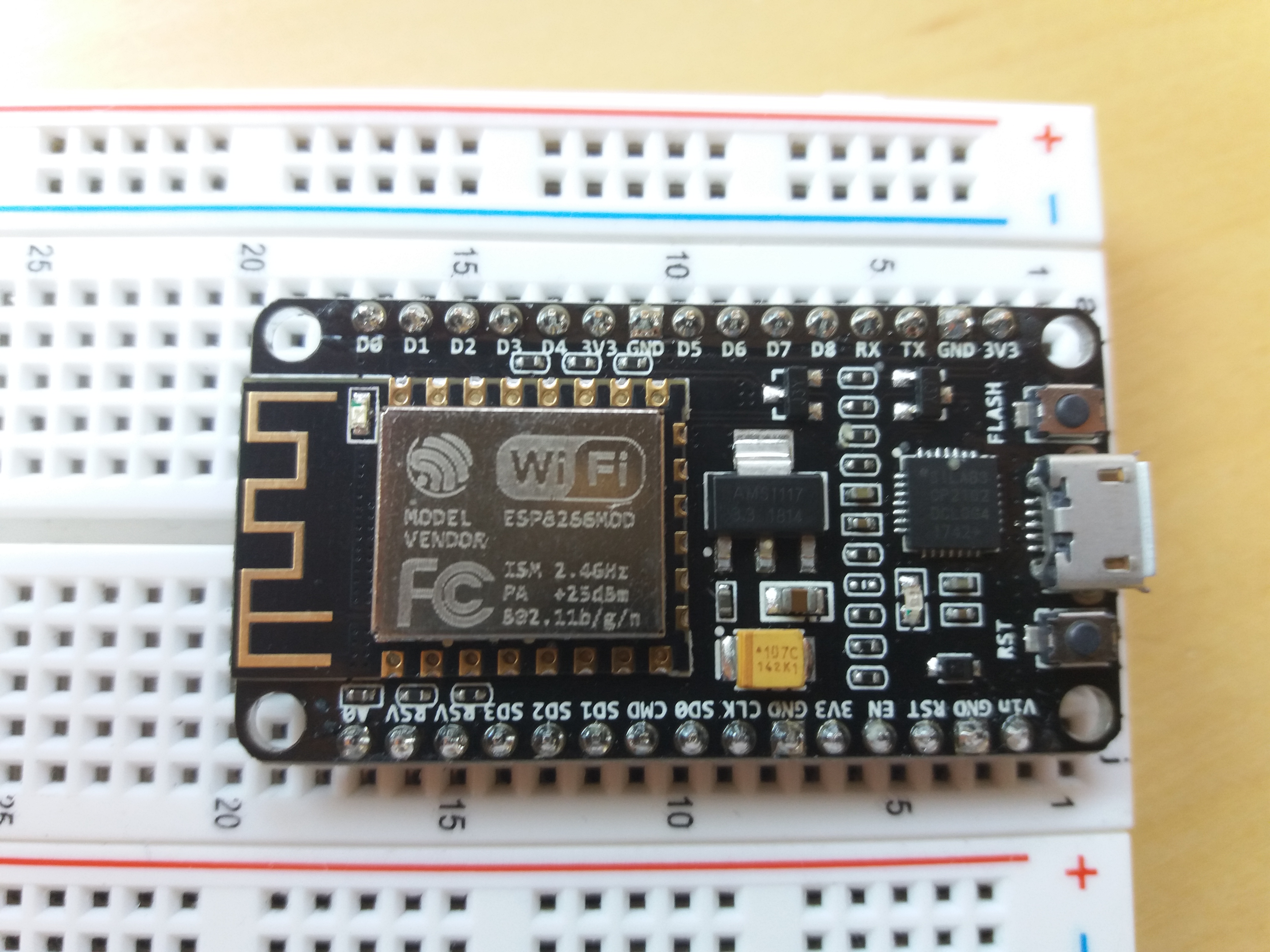

I have this Board here (NodeMCU-ESP32) :

When I upload the simple code mentioned there, I get these two errors:
If I'm looking over the serial Monitor, the ESP-32 Module shows me all available WiFi-Networks in a never-ending loop.
The AT-Commands don't work, I can send for example "AT" (and you should receive "OK") but the ESP-32 doesn't respond on it, it still keeps going its program searching for WiFi-Networks.
Does anyone know what I've to do to get my module working?
To go a bit more in detail, i want to use the ESP Module with a Arduino Uno R3 to program it over WiFi and control it for a project with a self-driving RC car.
Thanks in Advance for any suggestions to solve my Problem!
fcn200
Posts: 10617
Re: Problem with Programming the NodeMCU 32 Module with the Arduino IDE
Postby Sprite » Mon Mar 25, 2019 3:46 am
That's an ESP8266 module, not an ESP32 one.
