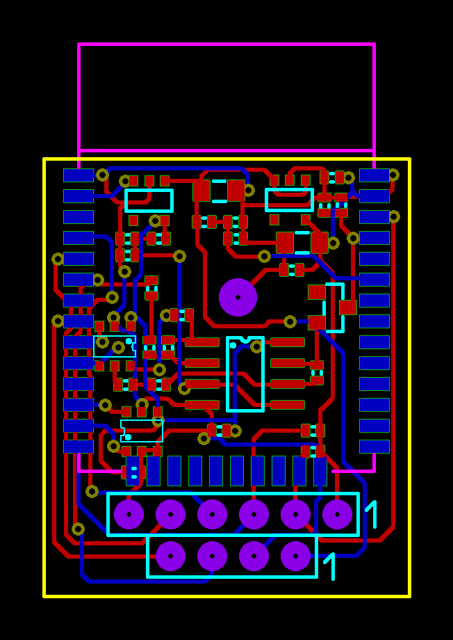

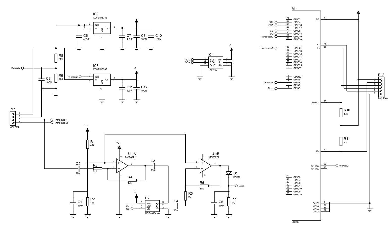

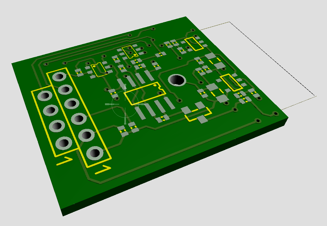

Re: ESP32 on Batteries - your setup
Hi Guys,
Just an update on the oil tank level monitor mentioned in an earlier post. The batteries have finally expired, they are now down from 4.5v to 3.8v and the sonar I'm using for depth sensing no longer works although it is still transmitting telemetry every hour.
So that's an ESP32 + sensors running almost 16 months on 3 * AA batteries.
Not too bad at all.
Not too bad at all.
@woofy, can you post detail on your project ? Type of dev / board you are using, component list etc. Appreciate it.
Here's the schematic and pcb. I'll try to find the firmware when I get home tonight.
- pcb-t.png (74.38 KiB) Viewed 11769 times
- pcb.png (20.54 KiB) Viewed 11769 times
- schematic.png (116.07 KiB) Viewed 11769 times
