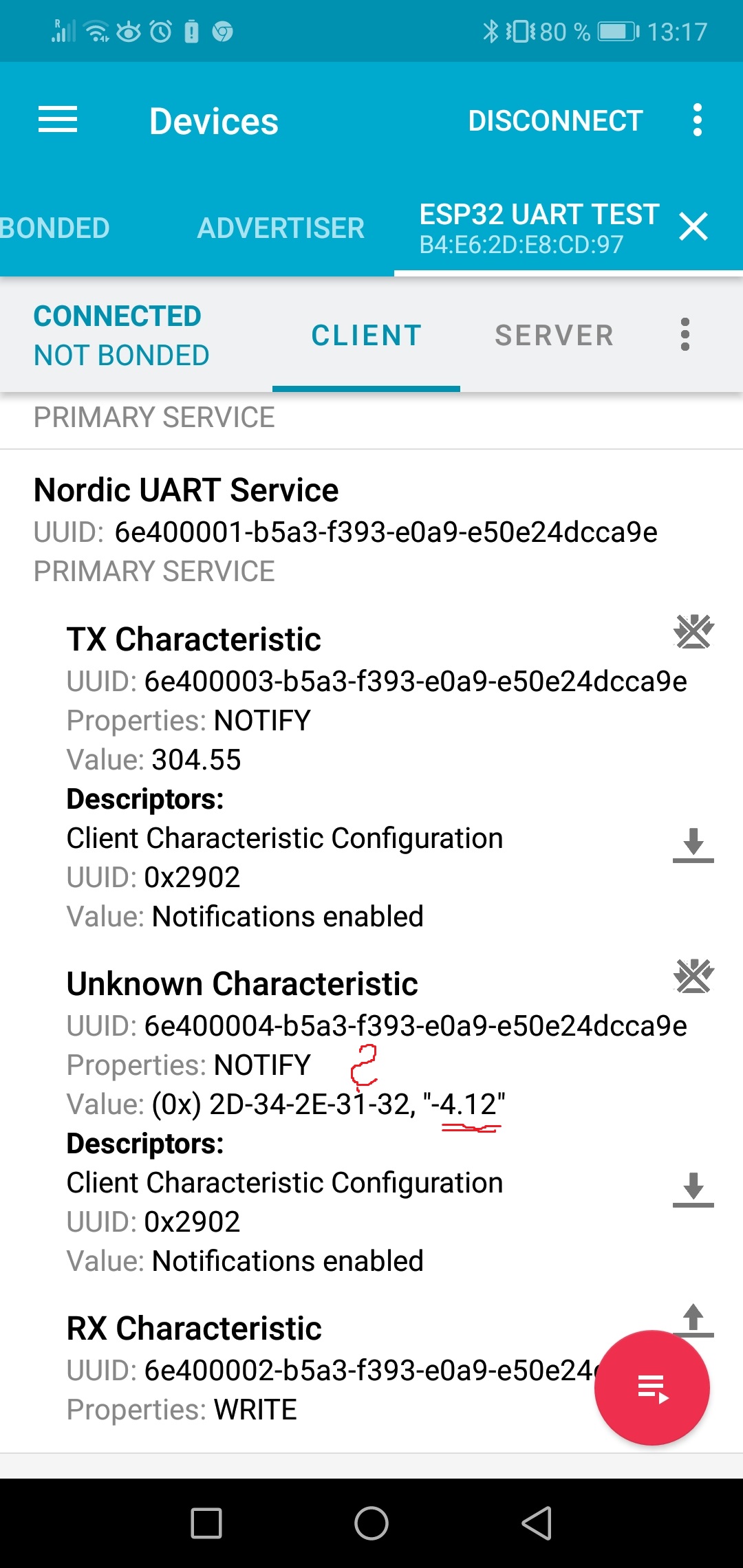

Hello guys,
I am trying to make a BLE service that provides 3 characteristics from the attached accelerometer (pitch, roll, yaw) - in the attached code, I implemented Yaw and Pitch only. My problem is that when I try to advertise, the "TX characteristics" outputs good values but the custom one (Pitch) outputs data in HEX (I suppose) and afterwards the real data in the quotation marks.
This is a sketch I put together:
(Check also an output of the nRF Connect App (attached SS))
    Video: https://www.youtube.com/watch?v=oCMOYS71NIU
    Based on Neil Kolban example for IDF: https://github.com/nkolban/esp32-snippets/blob/master/cpp_utils/tests/BLE%20Tests/SampleNotify.cpp

Thanks to everybody for taking your time and giving out valuable advices.
Boris
underlined is the actual Pitch data.
