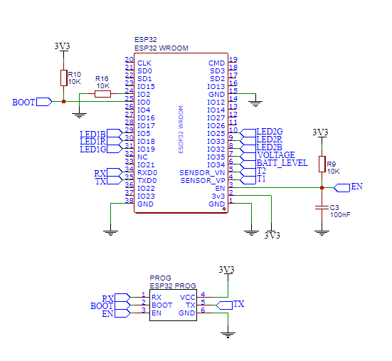

I am building a project based on a bare ESP32-WROOM-32 module (not a devkit). So far I was able to hook it up to and boot but when I want to flash it, it won't enter DOWNLOAD_BOOT mode.
My setup:
GPIO2 -> 10k pulldown to GND
GPIO0 -> 10k pullup to VCC
EN -> 10k pullup to VCC and 100nF capacitor between EN and GND
TX and RX connected to FTDI chip

So the module works, but I got the same result even when I connect GPIO0 to GND and do the reset - I would expect it to enter DOWNLOAD_BOOT mode but it still boots as usual.

Here is schematic of my wiring:
I think I have everything wired up correctly, can it be something with built-in firmware?

Both IO0 and IO2 must be low to enter download mode. Are you sure you pull IO2 down, not up? It's pulled down in ESP32 by default.

Each strapping pin is connected to its internal pull-up/pull-down during the chip reset. Consequently, if a strapping
pin is unconnected or the connected external circuit is high-impedance, the internal weak pull-up/pull-down will
determine the default input level of the strapping pins
Remove R16, is not needed. AS GPIO2 is set to the correct state per above.
You need to ensure that your performing the Program Mode scenario properly.

The uploading starts via serial data. EN is just really the reset pin. So you can just press it and release it quickly. The important thing here is that IO-0 is held low just a bit longer after EN is released. That is what puts it into programming mode.
1.1 Ensure IO-2 is Grounded.
IO-2 must be low to enter bootloader.
Sort of true. If nothing is connected to IO-2, it will be in the proper state internally. Only if say you connect something like a pullup resistor or something else that pulls it up will you need to insure its low first.
