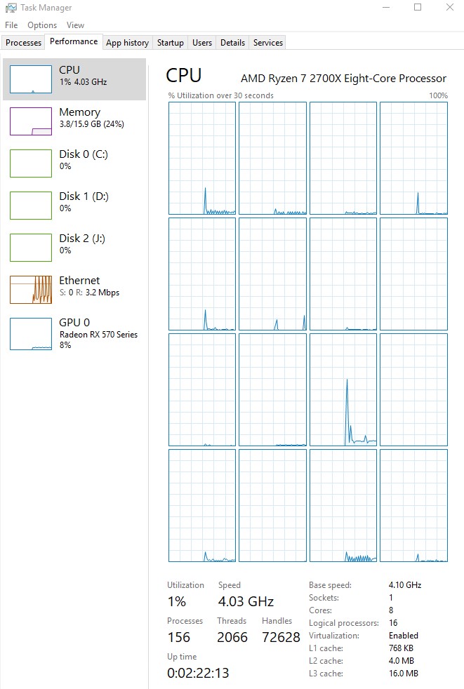

Re: ESP32 compiling time is way too long!
Strange, -jx should make a great improvement. Just to be clear your not actually typing "make -jx" right ?- using -jx or not, didn't change too much.
your instead doing something like "make -j8" or "make -j16".
You should open task manger when you start the make, and ensure all your cores are being used.
I'm using IDF v3.1.3 and the make system under MSYS32.bonmotwang wrote: ↑Thu May 16, 2019 9:11 pmHi John
That's encouraging!
It's very strange on my computer then.
I just installed ESP-IDF follow the CMAKE get started turorial.
idf.py build is so fast!!!
2 seconds if nothing changed.
Are you using CMAKE?
Thanks
Paul
John A
