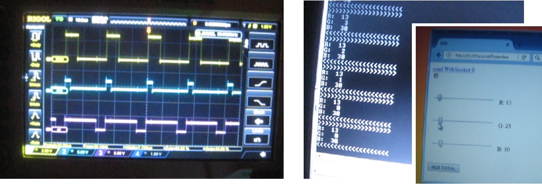

Re: How to use LEDC PWM in low speed mode?
hi guys,
my wsock test with highspeed pwm on RGB on wRover Kit V2
debug prints on uart console
duty set by wifi browser/wsock.
if you want you can see here a short animation sequence
Abridged versions
works.
if i test in an other project the low speed pwm
same procedure, only change H to L
my lowspeed pwm on RGB on wRover Kit V2
works not.
i am not sure in the LOW Speed setup, think there is one or two code lines missing,
do we need to set low clk too then ?
where is my thinking wrong?
rudi
btw:
you find a runing websocket server from Thomas here
tried after high speed register code then an high speed api code and it works,
a try to change the highspeed api to lowspeed api does not work too.
Abridged versions

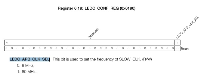

works not.
rudi

/* init PWM */
printf("\nRGB 255 PWM setup by API\n");
led_pwm_init();
/* set R= 155 G= 208 B= 223 */
/* call it in your cb if you need new value on the RGB */
printf("\nset duty\nR=155\nG=208\nB=223\n");
led_pwm_set(155, 208, 223 );

hi guys,taken [url=http://espressif.com/sites/default/files/documentation/esp32_technical_reference_manual_en.pdf]from the technical site 91[/url] wrote:
The low-speed timers l_timerx on the low-speed channel differ from the high-speed timers h_timerx
in two aspects:
1.
Where the high-speed timer clock source can be clocked from REF_TICK or APB_CLK, the low speed
timers are sourced from either REF_TICK or SLOW_CLOCK. The SLOW_CLOCK source can be either
APB_CLK (80 MHz) or 8 MHz, and can be selected using LEDC_APB_CLK_SEL.
2.
The high-speed counter and divider are glitch-free, which means that if the software modifies the maximum
counter or divisor value, the update will come into effect after the next overflow interrupt. In contrast, the
low-speed counter and divider will update these values only when LEDC_LSTIMERx_PARA_UP is set.
slow speed pwm need two things more?
LEDC_APB_CLK_SEL
https://github.com/espressif/esp-idf/bl ... eg.h#L2403
/* LEDC_APB_CLK_SEL : R/W ;bitpos:[0] ;default: 1'b0 ; */
/*description: This bit is used to set the frequency of slow_clk. 1'b1:80mhz 1'b0:8mhz*/
https://github.com/espressif/esp-idf/bl ... eg.h#L1619
/* LEDC_LSTIMER0_PARA_UP : R/W ;bitpos:[26] ;default: 1'h0 ; */
/*description: Set this bit to update reg_div_num_lstime0 and reg_lstimer0_lim.*/
my setup for low speed looks like is missing something
example timer (1<<26)
/* set low timer*/
WRITE_PERI_REG (LEDC_LSTIMER0_CONF_REG, (1<<25)|(0b000000001000000000<<5)|10);
WRITE_PERI_REG (LEDC_LSCH2_CONF0_REG, (1<<3)|(1<<2));
rudi
update
and this change/set to 80mhz works:
LEDC_CONF_REG: 0x1
channel bind works too,
LED get on if Clock set to 80mhz
but i am not sure, that i use the right config for the low speed timer , this (1<<26) is not right.
i play with duty and measurement, can't see a difference, perhabs the update code is wrong?
pausing
rudi
ok, SLOW_CLOCK source can be either#define LEDC_CONF_REG (DR_REG_LEDC_BASE + 0x0190)
//80mhz
WRITE_PERI_REG (LEDC_CONF_REG, (1<<0));
__asm__ __volatile__("nop;nop;nop;nop;nop;nop;nop;nop;");
uint32_t val=0;
val = READ_PERI_REG (LEDC_CONF_REG);
printf("LEDC_CONF_REG: 0x%X\n", val);
/* LEDC_LS_SIG_OUT0_IDX 79 */
WRITE_PERI_REG (GPIO_FUNC2_OUT_SEL_CFG_REG, (1<<10)|82); // Green 79 + cn 3
WRITE_PERI_REG (GPIO_FUNC4_OUT_SEL_CFG_REG, (1<<10)|83); // Blue 79 + cn 4
WRITE_PERI_REG (GPIO_FUNC0_OUT_SEL_CFG_REG, (1<<10)|81); // Red 79 + cn 2
WRITE_PERI_REG (LEDC_LSTIMER0_CONF_REG, (1<<26) | (1<<25)| (0b000000001000000000<<5)|10);
WRITE_PERI_REG (LEDC_LSCH2_DUTY_REG, (dutyCycleG * DUTY_CYCLE_MAX / 100) << 4);
WRITE_PERI_REG (LEDC_LSCH2_CONF1_REG, (1<<31));
WRITE_PERI_REG (LEDC_LSCH3_DUTY_REG, (dutyCycleB * DUTY_CYCLE_MAX / 100) << 4);
WRITE_PERI_REG (LEDC_LSCH3_CONF1_REG, (1<<31));
WRITE_PERI_REG (LEDC_LSCH4_DUTY_REG, (dutyCycleR * DUTY_CYCLE_MAX / 100) << 4);
WRITE_PERI_REG (LEDC_LSCH4_CONF1_REG, (1<<31));
rudi
I think doc forgot to mention you also have to strobe LEDC_PARA_UP_LSCHx bitrudi ;-) wrote:
