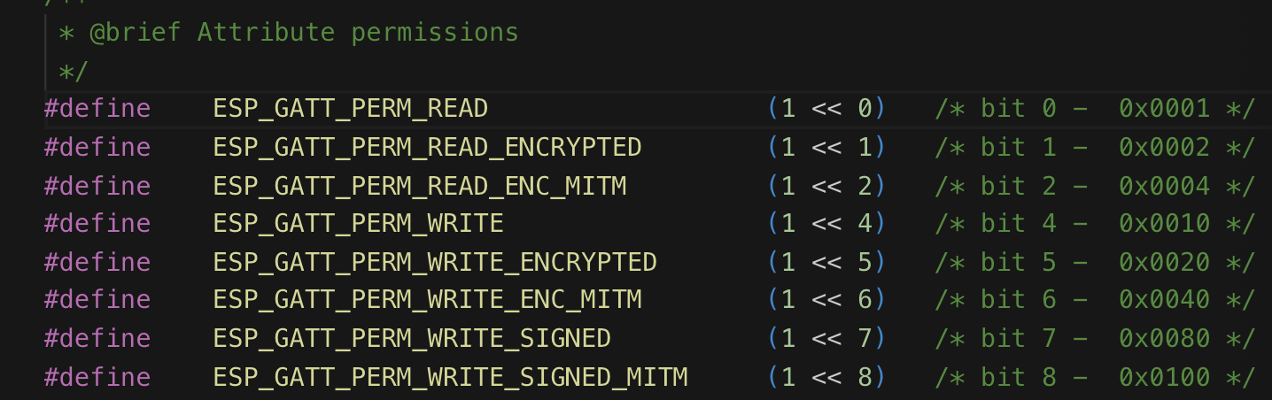

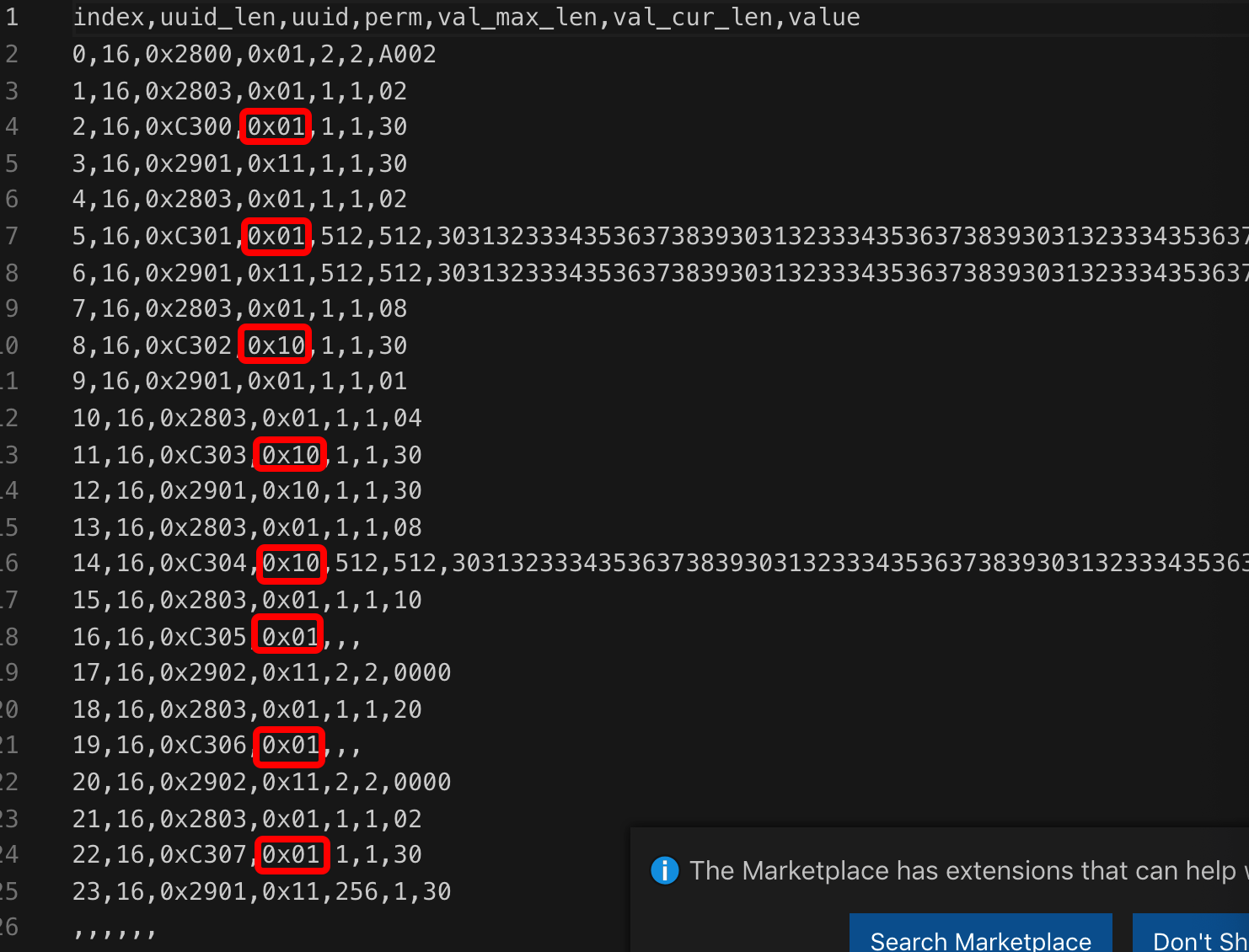

Maybe you can set the permission of the BLE characteristic in esp32-at/components/customized_partitions/raw_data/ble_data/, to make it only able to read/write when encrypted.

Thank you, it works ! I didn't think that it would need an AT security configuration plus a service.bin perm configuration.
