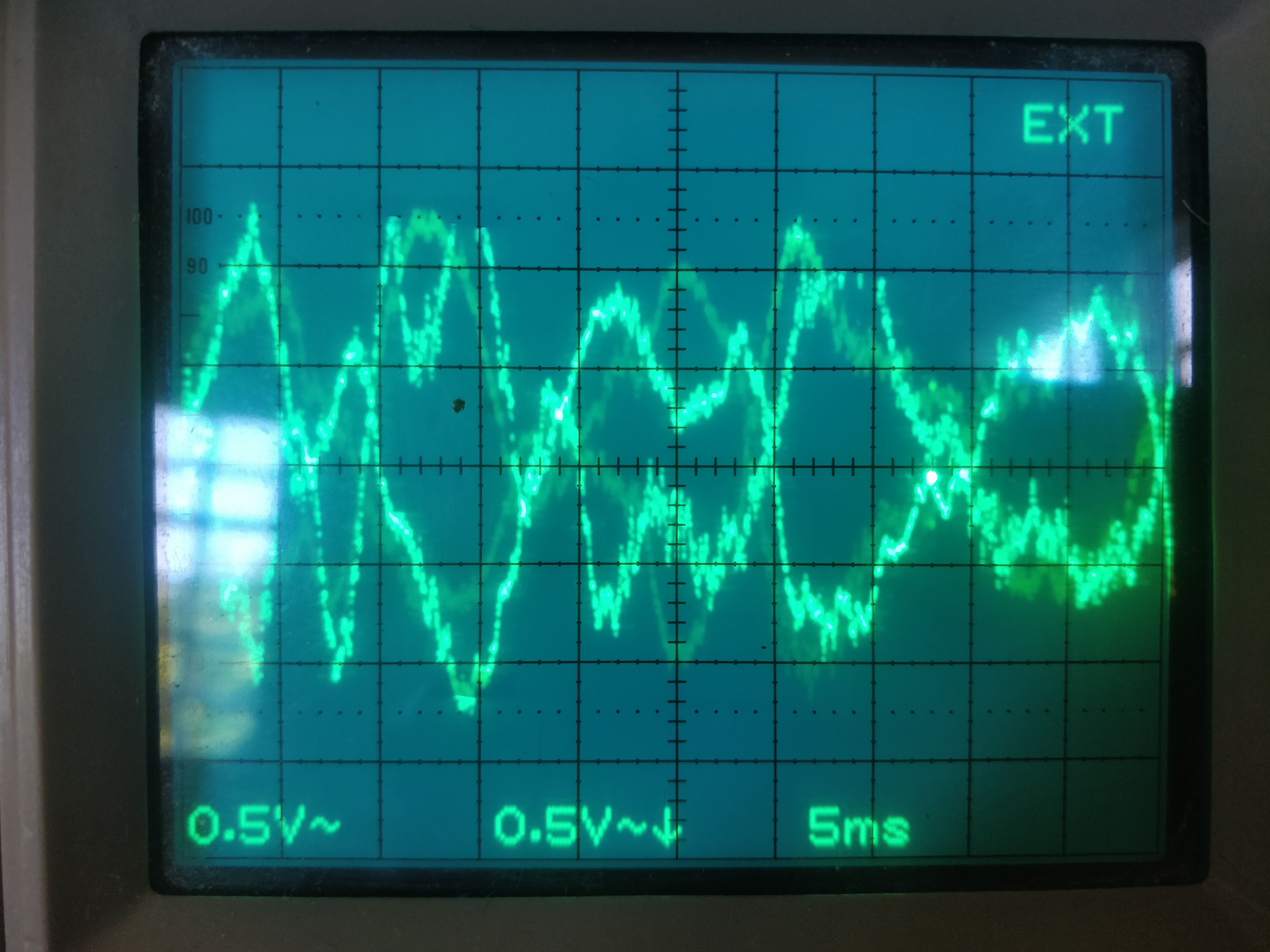

My extremely old oscilloscope gives the following when no audio is playing with gpio 26 channel inverted, so it is pretty much identical with gpio 25. Gpio 26 has a 1 uF capacitor in series :

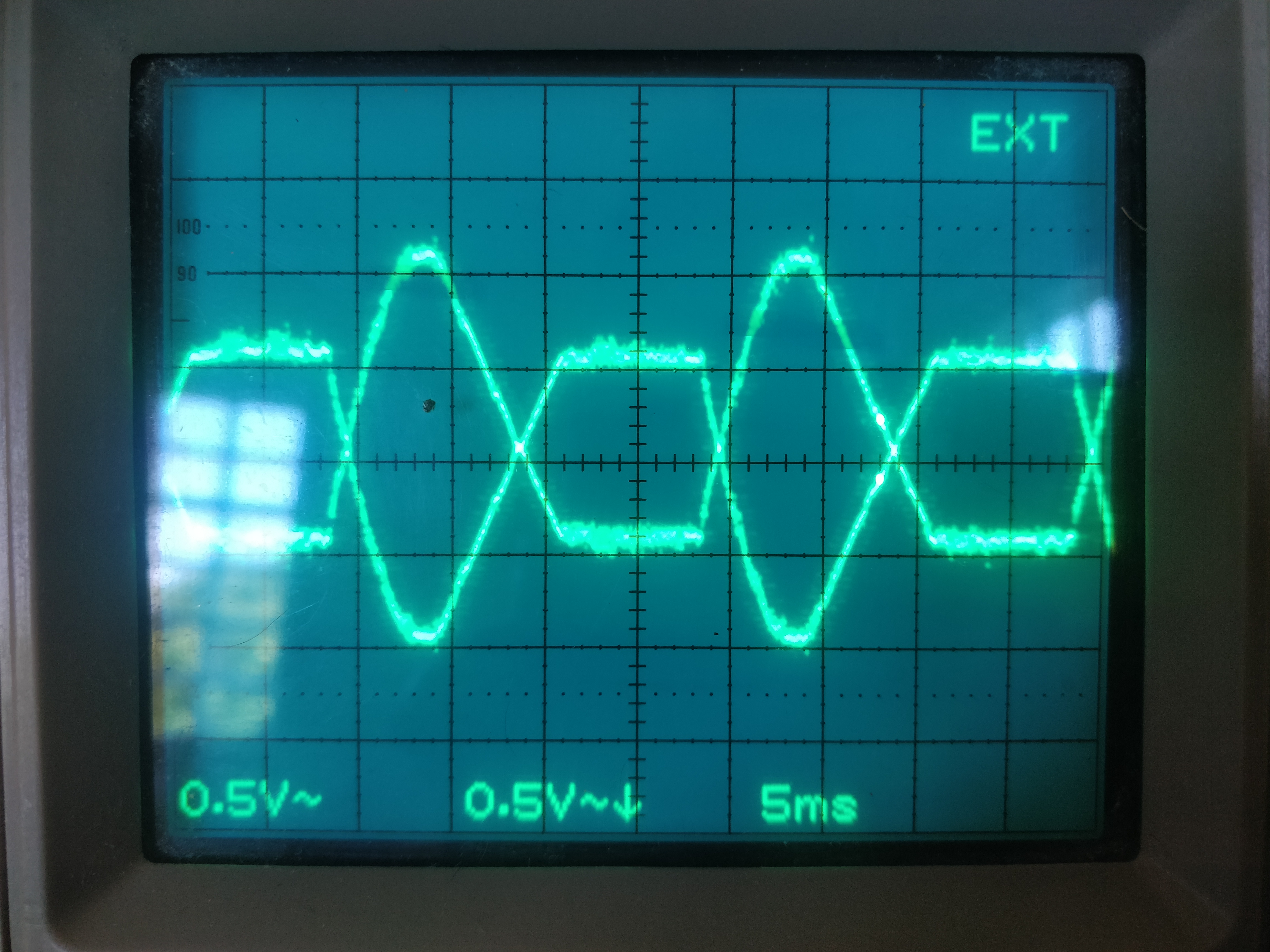

And when playing:
Is this normal? Why the positive voltage peak is cut off? How could i make the volume louder? How could I eliminate the random cliches that hear every 10s or so....?
