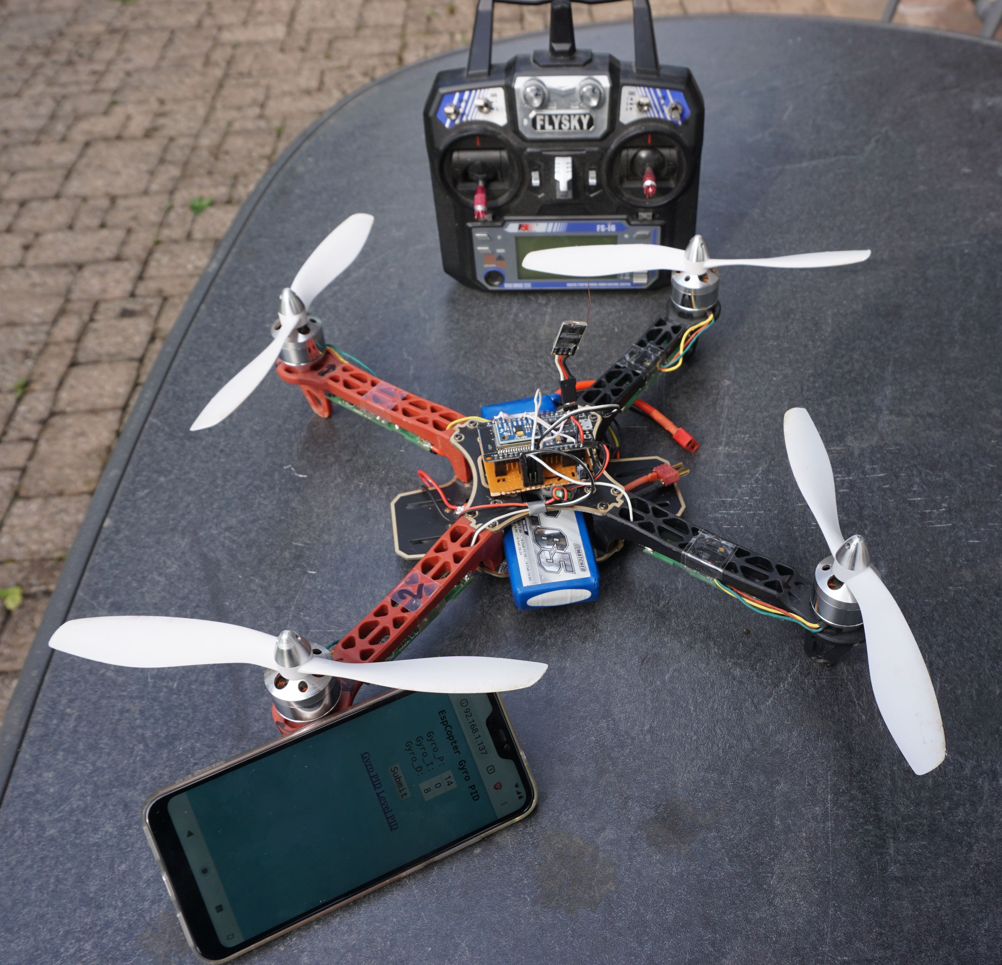

Pinchange interrupt during eeprom write -> crash.
ISR is IRAM_ATTR.
Guru Meditation Error: Core 1 panic'ed (Cache disabled but cached memory region accessed)
Guru Meditation Error: Core 1 panic'ed (IllegalInstruction). Exception was unhandled.
Memory dump at 0x40149a4c: bad00bad bad00bad bad00bad
Detaching IR, writing eeprom and reenabling IR does work.
So finally i am able to change my esp32quadcopter PID's in-flight with my phone. I have o use an extarnal RC radio, a flysky $50 radio wih micro receiver, ppmsum outpu fed to the esp32. Yep, i have a flyable webserver.

Nice diagram.

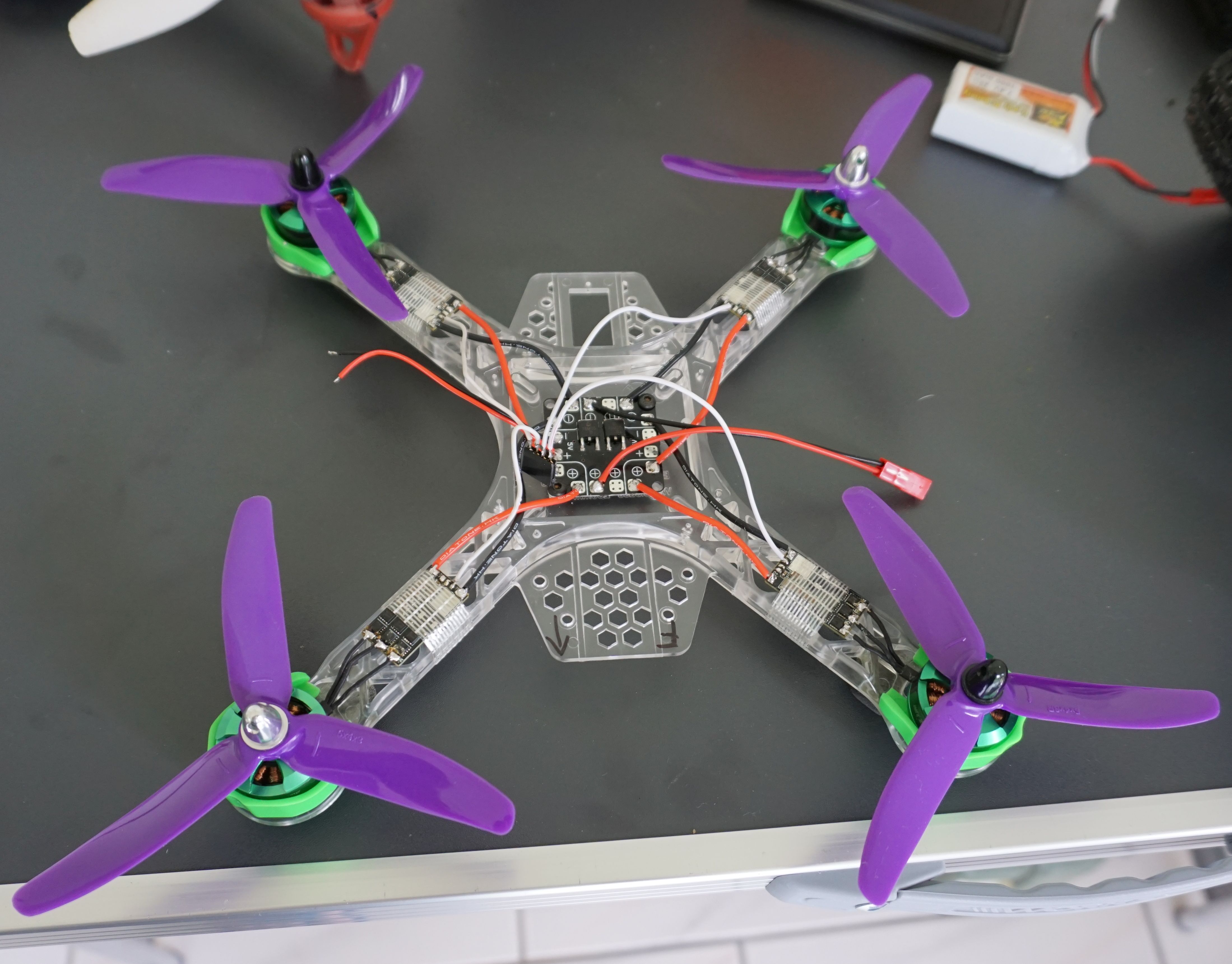

Sub 500g 250 size esp32-cam copter in the build:

- DSC02375.jpg (1015.66 KiB) Viewed 7239 times

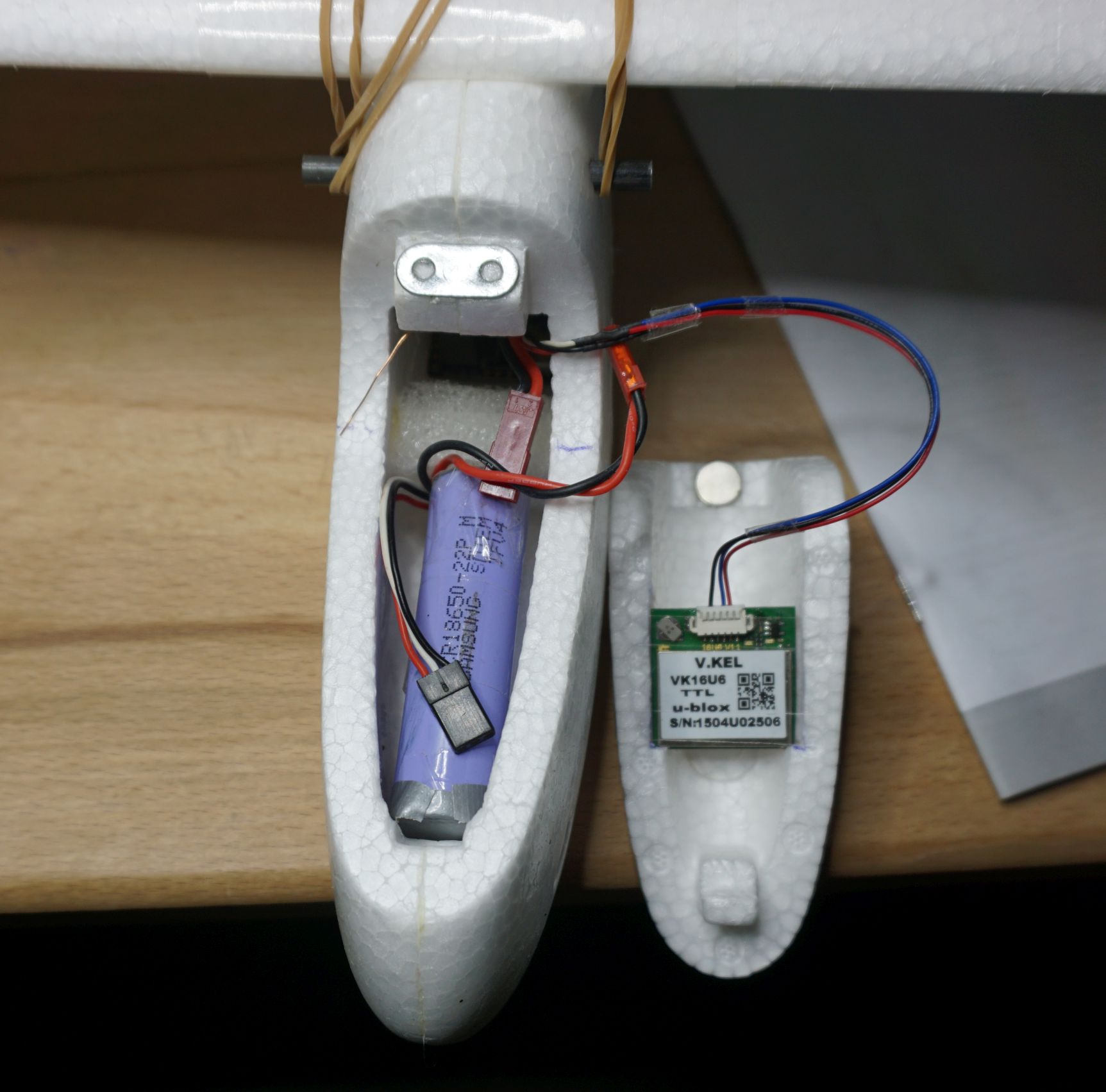

Planes:
My skywalker mini (80 cm wingspan) did 1.5km analog FPV (200mw tx) and 45min flight time with two 18650 cells. 60 min flighttime without fpv. Arduino 32u4 - mpu6050 flight controller, cheapo gps, waypoints and RTH. Nothing an esp32cam couldnt do.
