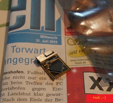

rudi made an image from my LiveStream yesterday where I was showing it off... thanks rudi ;-)

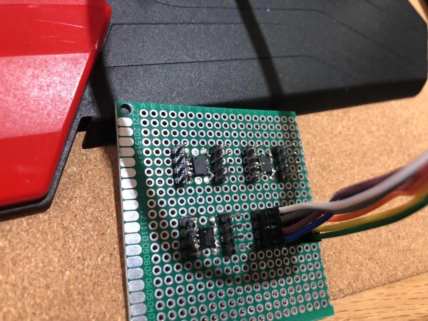

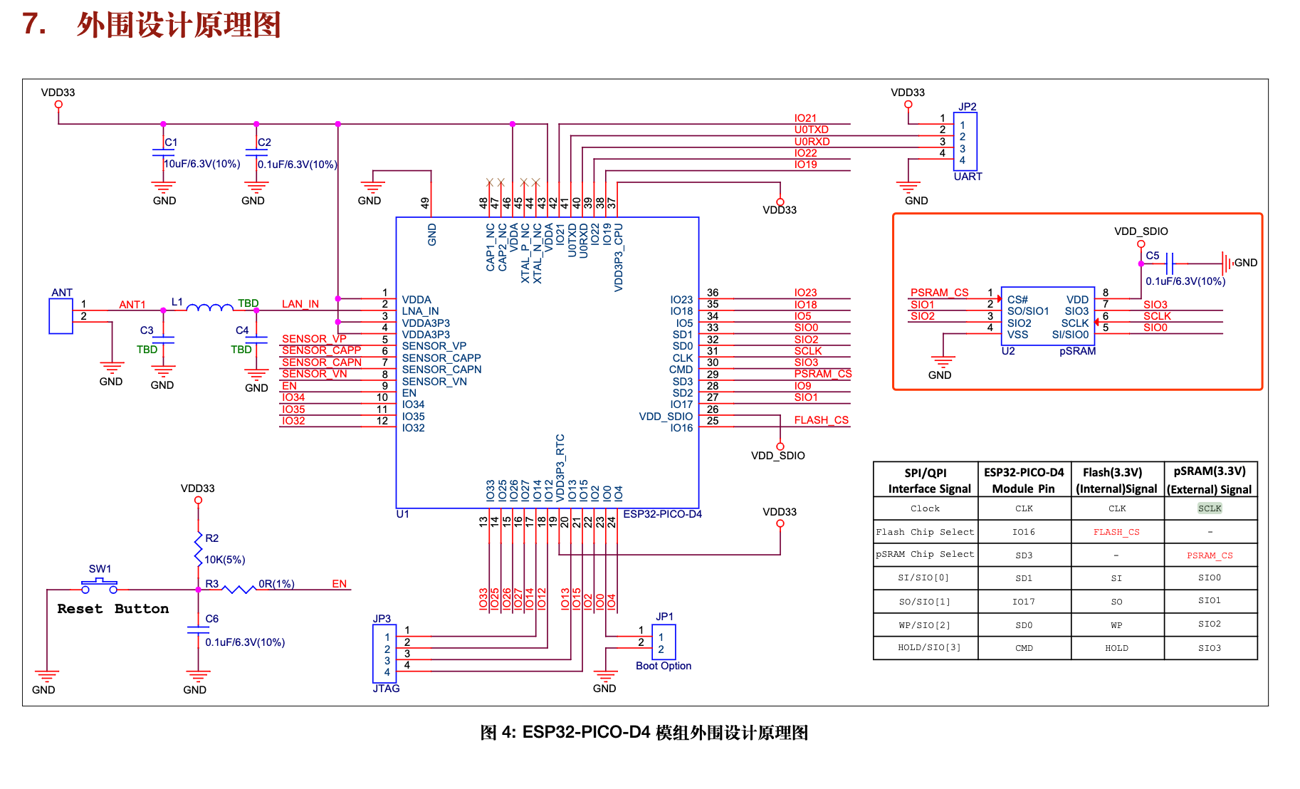

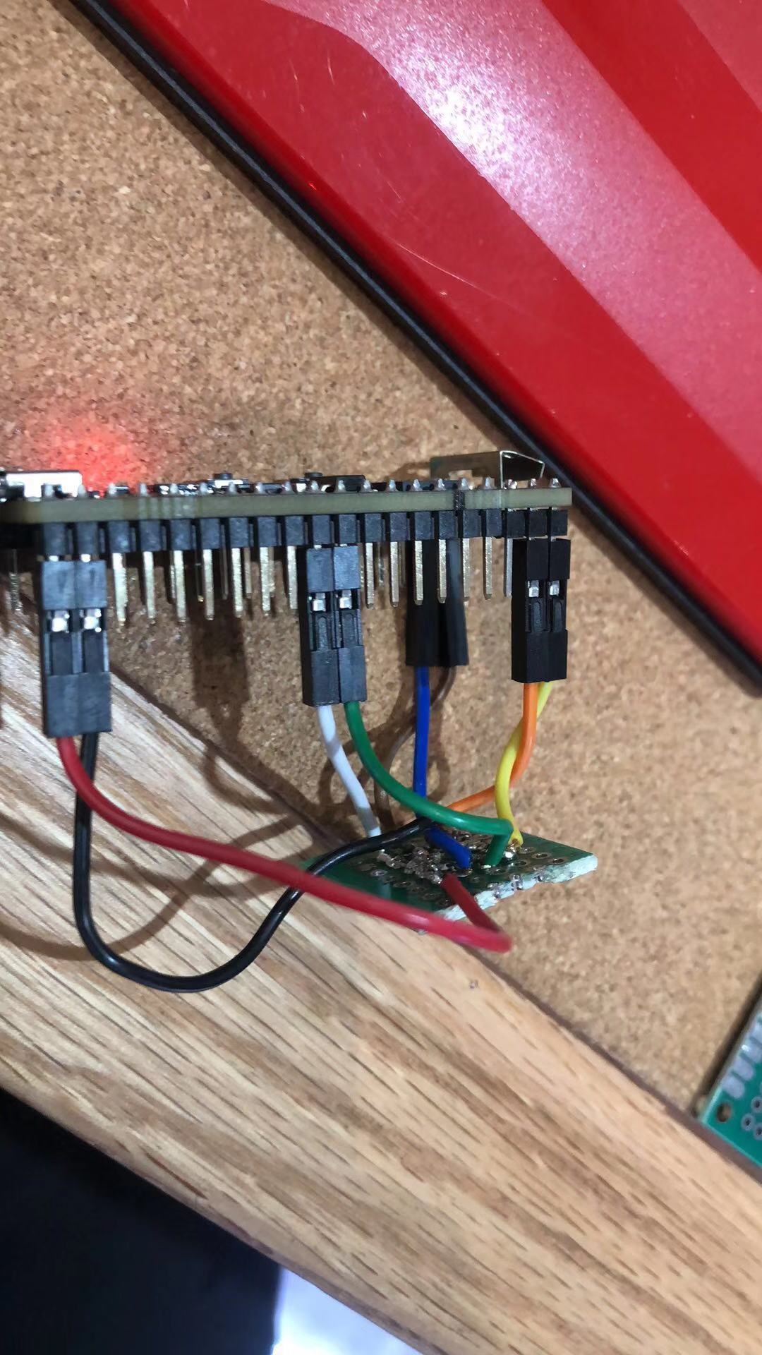

Hello Seonroz, my name is jiy, I am from Shenzhen.
I encountered the same problem a week ago and I tried to add the SPI RAM chip to the ESP32-PICO-D4, but it never worked.
I connected the SPI RAM according to the schematic in Espressif's ESP32-PICO-D4 specification, but when I ran the program, I found that the memory test failed.
ESP32-PICO-D4 peripheral schematic from Espressif
I turned off the memory check in the setup menu and it looks good, but it crashes when the program requests more memory than the ESP32-PICO-D4.
I think this is a memory chip issue. I bought more memory chips: IPS6404LSQ, LY68L6400SLIT, ESP-PSRAM64, I tested it with the DuPont series and the ESP32-PICO-KIT development board, but the results are still the same.
I was very frustrated, then I started looking for relevant information online and then saw this article.
I tried to connect to the SCLK pin of RAM using GPIO9, and GPIO9 will still warn the memory to detect the error.
Later I saw the video you connected to RAM. It took only 3 hours to solve the problem. Awesome!
Then I tried to shorten the DuPont wire and solder it directly to the SPI RAM pin. And I didn't use a 10K pull-up resistor. effective. I also wrote a program to detect the available memory size and found 4491944 bytes, which is so cool. Thank you for sharing and helping me solve this desperate problem! ! !
Later I tried to connect the SCLK pin to GPIO6 and GPIO10 and modified the program according to the hardware, but it didn't work. Then connect SCLK back to GPIO9 and run. I don't know why this is happening? Do you have the same problem?
Thank you for your unselfish sharing and wish you all the best! ! !

Hi Folks
cause ESP32-PICO-D4 is 3V3 we can use the Espressif's ESP-PSRAM64H for this.
It support 3V3.
btw:
ESP-PSRAM64H is used on the New Chip Thing "Chip7 2-2-A" ( ESP32-S2 )
Datasheet ESP-PSRAM64 & ESP-PSRAM64H you find online at espressif
or here for download

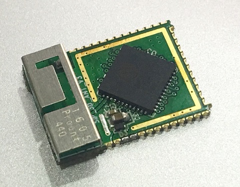

The picture of the module you've posted:
small Pico D4 Board with Proant 440 ( espressif's engineering example): ESP32_PicoD4_Board_with_Proant440.jpg -
is this a module that will be available soon on the market?
Thanks
Posts: 1759
Re: Small ESP32 Modul ( all include in new ESP32-PICO )
Postby rudi ;-) » Sun Aug 04, 2019 6:42 pm

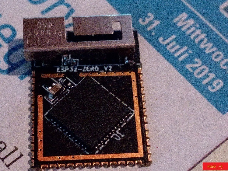

Hi Rudi,
Thanks
hi samsam,
the ESP32-ZERO-V2
was an ESP32-PICO-D4 engineering sample,
not sure, will this / is this given released on the market.
on the market is ESP32-PICO-D4-KIT from espressif. there are few other "maker" samples on market with OLED, PSRAM, or other things.
named TinyPico
or ESP32-PICO-D4-Development Board .. ESP32-CoinCell ...
and more few other.
