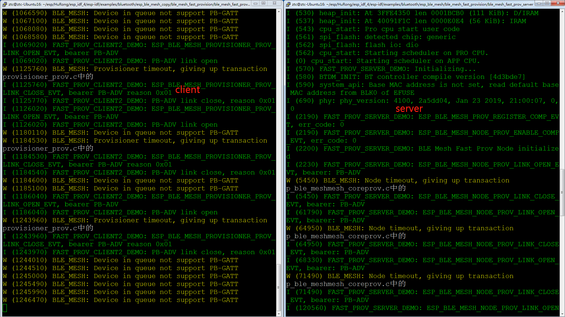

ble_mesh_fast_prov_server和ble_mesh_fast_prov_client没有能够自动连接,二者的Log如下:

请问但从Log上能发现问题原因所在吗

Hi ,
You also check the selection
Component config--"Bluetooth --" BLuetooth controller--"Scan Duplicate Type (Scan Duplicate By Device Address And Advertising Date)
Componet config--》Bluetooth--》Bluetooth controller--》BLE full scan feature supported.

按照你说的设置了,不过还是连不上啊
