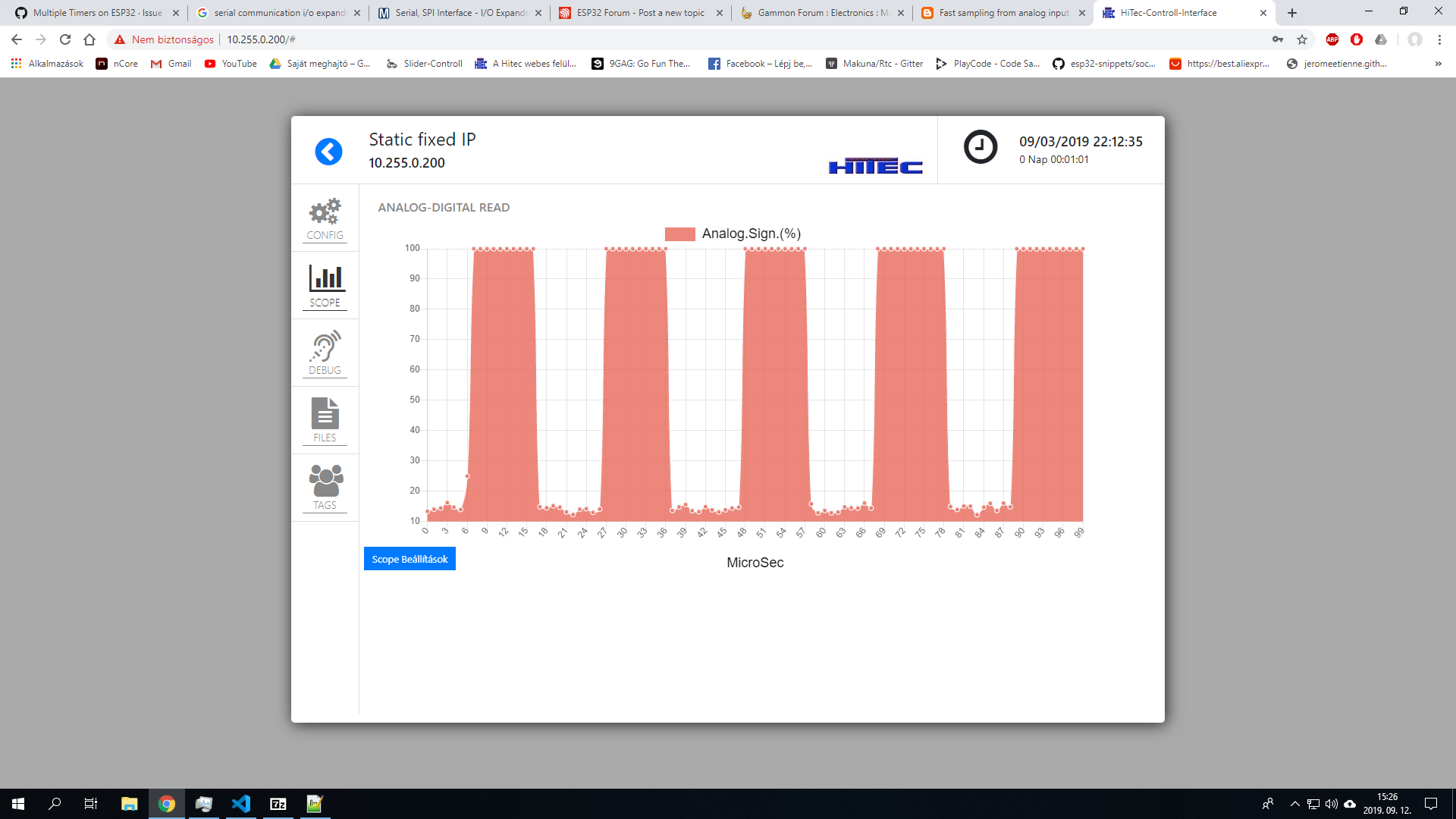

Hello guys!
I want to measure a 4kHZ frequency with my bare ESP32 chip with it's internal ADC and then send the results to it's web server for chartJS.
Everything is working properly, except the continuous part.
My basic idea for the ADC was that:
- Create a task on the 0th core for the adc reading function.
- Measure the 4khz external signal ( from a signal generator for now ) at 8khz in a loop in that task with disabled interrupts on core 0.
- Create a fast function ( on core 1 ) for reading the measured data at some interval ( like 0.5 sec or it doesn't matter ) from the adc
buffer for further working.
- Create a normal function ( on core 1 ) to send the data to web ChartJS for visualization at modifiable intervals ( 1 to 10 sec, depends
on the user settings).
The idea in my code:

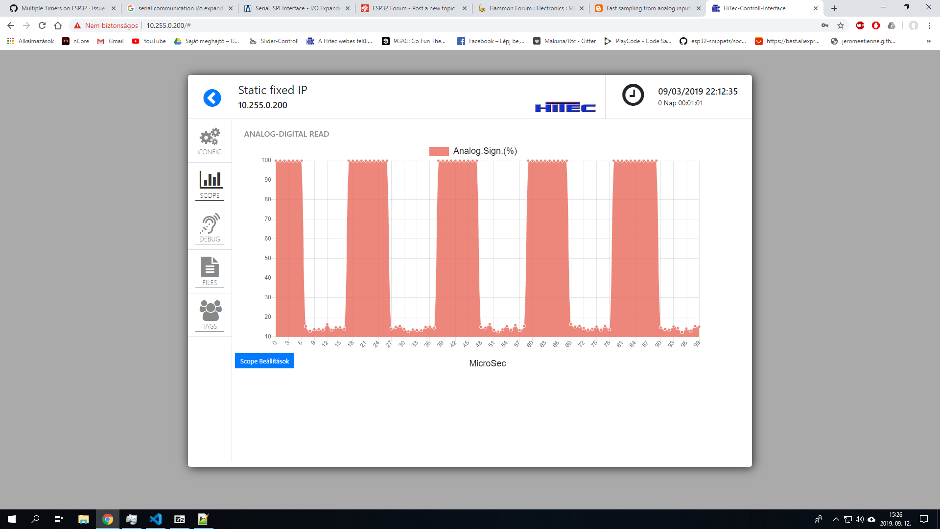

The problem:
Like this the measure function is measuring 100 datas at once and wait delay(1) and god knows how many milisec while it is turning back into the measure function again to measure that 100 data again. The problem is that is not async and not continous. The program can not do anything else during the measure and if it is done , it has to wait because of the watchdog timer and other task that runs on the core0 background. I attached a some pictures how the data looks on the web like this. It is fine, just not continous.
Képernyőfelvétel (11).png (187.48 KiB) Viewed 3376 times
Képernyőfelvétel (10).png (187.92 KiB) Viewed 3376 times
Képernyőfelvétel (9).png (187.58 KiB) Viewed 3376 times
