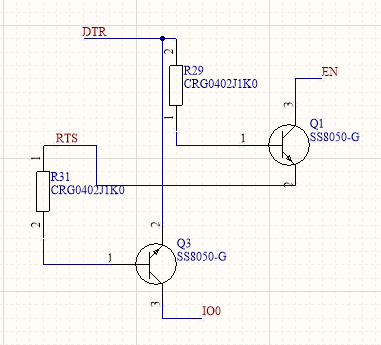

I have a custom board with a ESP-WROVER-B. There is a CP2102N that has the reset and boot circuit implemented as it is in the ESP-DevkitC schematic (RTS, DTR, two transistors, EN and IO0).
The first problem that I had was the fact that my board was not getting into "download mode" in order to flash it. For now, it looks like this was solved by adding a capacitor between EN and GND. After this, the flashing is working, but the hard-reset is not. I had a look here (https://github.com/espressif/esptool/issues/399) and I added time.sleep(2). It looks like it's working.

Re: Hard-reset not working
I'm using this part successfully in several of my designs. First thing I notice in your description is your reset circuit, typically this is implemented with two transistors and two resistors. Here's one of my recent schematics https://cdn.hackaday.io/files/163861701 ... coffin.pdf. Additionally you mention the cap on EN, do you have a pull-up resistor on EN also? I found missing this caused really inconsistent flashing in an early design.

This is my reset circuit:captain_morgan wrote: ↑Mon Aug 19, 2019 3:53 pmFirst thing I notice in your description is your reset circuit, typically this is implemented with two transistors and two resistors
For now, I just have a pull-up resistor (10k) on EN, without any capacitor. This way, it is not working and I placed a capacitor by hand and it's working this way. I can see that you don't have any capacitor on EN. Is it working like that?captain_morgan wrote: ↑Mon Aug 19, 2019 3:53 pmAdditionally you mention the cap on EN, do you have a pull-up resistor on EN also? I found missing this caused really inconsistent flashing in an early design.

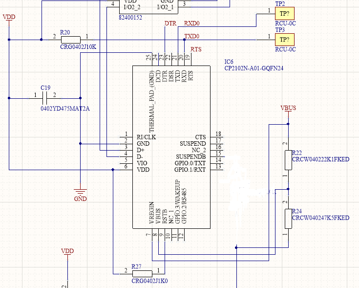

My VIO is not connected to anything.captain_morgan wrote: ↑Mon Aug 19, 2019 3:53 pmIf these don't help you should post the schematic of your CP2102 circuit for further help. But other things to check...
What's the voltage on VDDIO?
VBUS connected? (Ignore my voltage divider, turned out unneeded)
RSTb pulled high? (specifically to VDDIO)
The VDD from CP2102 is connected to the same VDD as ESP32. Should it be connected or not? I can see that it is not in your schematic.

First and foremost from your original post, you should check the date code on your device to see if it does in fact have this hardware issue. After 1639 the issue has been fixed.

I have never included a capacitor on EN and it works just fine.
In the design I showed, the CP2102N is in Bus-Powered mode, meaning the chip is powered from the USB and saves power when using battery. With this setup, you apply 5V to VREGIN and VDD becomes a 3.3V OUTPUT, that is fed back into VIO, which is the supply voltage for all RX, TX, DTR, RTS, etc.
From the datasheet pin description, Table 5.2
Additionally without any power going into VIO, I suspect you are getting low if any voltage out on all your IO pins. Again from the pin description table.
In either case I think you need the VDD pin and VIO pin connected.
Hopefully this helps you progress, I struggled with this chip as well, and personally don't think the datasheet is very clear around these different ways to power it.
https://www.silabs.com/documents/public ... Update.pdf
...back to debugging...
Since you have VBUS connected to VREGIN, you're actually outputting 3.3v back into your VDD net! I'm a bit surprised nothing has given up the smoke.VDD: Supply Power Input / 5V Regulator Output
My best guess at this point is you're half running in bus-powered and half external powered. You need to either disconnect VDD or connect VREGIN to VDD instead of VBUS. These are described in Figure 2.1, 2.2, 2.3VIO: I/O Supply Power Input
I think my CP is 1910, so it should be ok.
Regarding outputting 3.3v back into my VDD net, that shouldn't be a problem I think.
Yesterday I had a problem because I had 2.6V on my VBUS when nothing was connected to the USB. I cut the trace between my VDD net and the VDD pin of CP and the voltage not on my VBUS is 0.4V.
Unfortunately, I cannot solder the VIO to VDD now on my board as the pin is too small.
Regarding the EN capacitor, I think I have to use it because mt reset doesn't want to work without ti at all. I will test that again.
