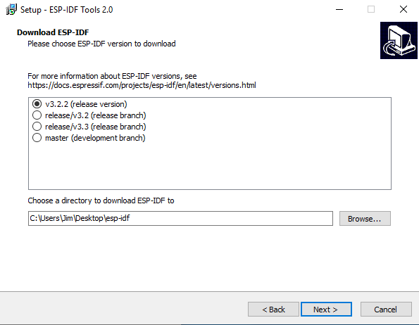

I think my understanding of the releases might be wrong. Can someone please break this down for me.
I use CMake, and with the new notice of "ESP-IDF v3.3 has been released (LTS)" here:
viewtopic.php?f=13&t=12162#p48785
I want to be sure I am using the correct one. The setup for Cmake is here:
https://docs.espressif.com/projects/esp ... setup.html
When I run the tool you are given these choices. Is "release/v3.3" the LTS one ?

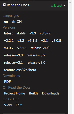

I ask because when you click on the bottom of the web page you get this popup. Which confuses me.
I am only interested in v3.3 LTS, so as you can see there are 4 possibilities.
stable, v3.3, v3.3-rc, and release-v3.3. Can someone breakdown what these 4 mean.

Hi Mikemoy,
Sorry for the confusion, v3.3 is the new LTS release.
The installer metadata wasn't updated yesterday but it should be updated now, so "v3.3" should appear as an option if you run it again. Or you can download the release from Github here: https://github.com/espressif/esp-idf/releases/v3.3
The relevant docs are here: https://docs.espressif.com/projects/esp-idf/en/v3.3/
("latest" docs, as linked from the post, are for the development version, currently v4.1-dev, and they will describe some things differently.)
"v3.3" is the link for v3.3 docs.
"v3-3-rc" was the v3.3 Release Candidate prerelease version. This will be taken down shortly.
"release-v3.3" is the "release branch" for v3.3, "release/v3.3". This branch is updated regularly with bugfixes and other changes, and will be used to make bugfix releases (ie v3.3.1, etc).

"stable" will always be the latest stable release, this is "v3.3" at the moment but will change in the future when a new stable release comes out.stable, v3.3, v3.3-rc, and release-v3.3. Can someone breakdown what these 4 mean.
