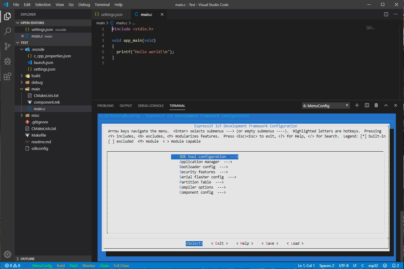

Thanks for the update!

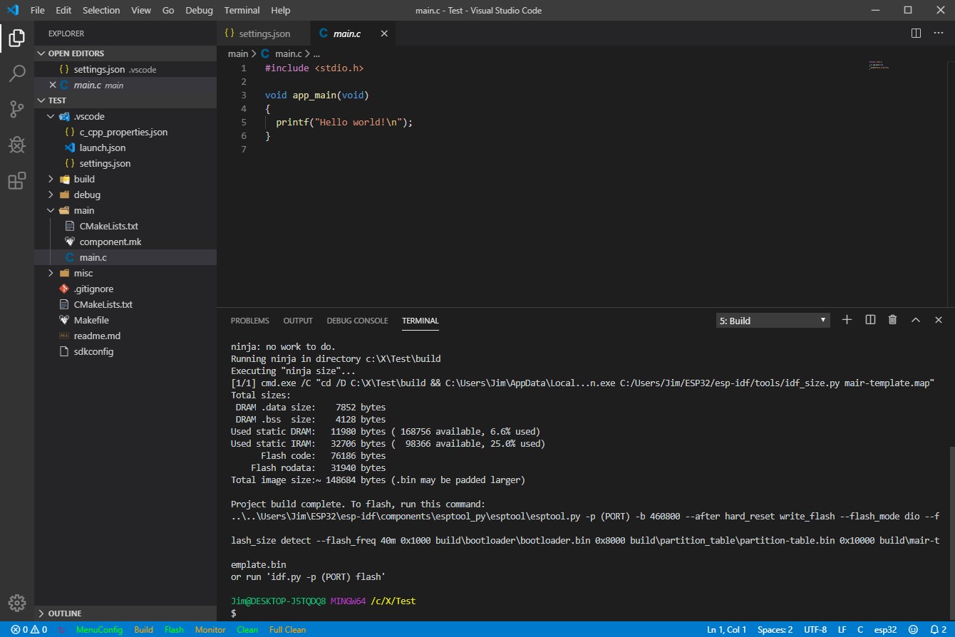

Concerning your VSCode install video. I would like to share something with you that I use to help with all the command line stuff.
You can still do the command line stuff like you showed, but this will add icon buttons to just to click on.
If you look at the bottom of the image your will notice the new buttons to click on.
You can even get to menuconfig as well
You will need to add the following 2 extensions first.
#1) vscode-icons-team.vscode-icons
#2) seunlanlege.action-buttons
After this, you need to alter the settings.json file to add "actionButtons". This is what mine looks like.
A couple of notes.
#1) When you open a project folder for teh first time, the first thing is click "view", then "Terminal" you will get a popup asking for access make sure to click allow, then you will not have to do that anymore.
#2) Concerning menuconfig, if your terminal window is to small it will give a warning saying "Your display is too small to run Menuconfig!. All you need to do is click on the separation line in the terminal with your mouse and slide it up to make that window larger like in my image, then click on menuconfig again and it will open it.
#3) if you make any changes to settings.json, like say you want to change the com port or add a new command, first save it, then click the tiny red refresh icon for it to accept changes.
Lastly, I have this in my c_cpp_properties.json file.
"${env:IDF_PATH}/components/**",
This kept me from entering all the many "${IDF_PATH}/components/bla.bla.bla" folders to it.

"terminal.integrated.shell.windows": "C:\\Program Files\\Git\\bin\\bash.exe",
"actionButtons": {
"defaultColor": "#ff0034", // Can also use string color names.
"commands": [
"name": "MenuConfig",
"color": "lime",
"command": "idf.py menuconfig",
"name": "Build",
"color": "orange",
"command": "idf.py build size",
"name": "Flash",
"color": "lime",
"command": "idf.py -p COM6 -b 1152000 flash",
"name": "Monitor",
"color": "orange",
"command": "idf.py -p COM6{ monitor",
"name": "Clean",
"color": "lime",
"command": "idf.py clean",
"name": "Full Clean",
"color": "orange",
"command": "idf.py fullclean",
"files.associations": {
"*.md": "markdown",
"*.mdx": "tdx",
"stdio.h": "c"
