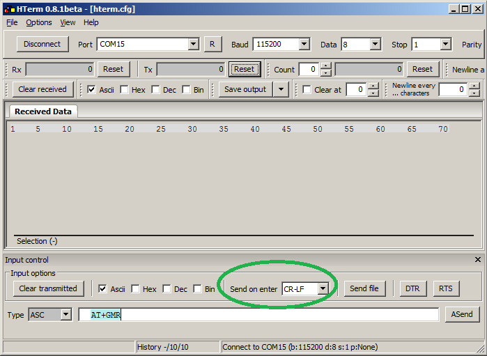

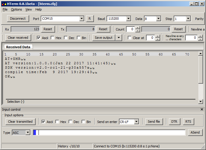

perhabs this helps:
( example windows hterm )
be shure you use CR + LF
result:
used in this example uart1 ( 16, 17 ) for AT Terminal
(edit)
DevKitC and FTDI 232 for UART1
http://esp32.com/viewtopic.php?f=2&t=1103&p=5041#p5039
(/edit)

hi
+try to use the same uart like you flash
example DevKitC uart0
change in sdkconfig ( make menuconfig )
component AT uart1 to uart0
here you see the example on config in menuconfig
uart port = 0
rx pin 3
tx pin 1
http://esp32.com/viewtopic.php?f=2&t=1103&p=5054#p5054
then start
make flash monitor
and you usually get the boot prozess
then the "ready" from AT prozessor
and then you can write AT Commands in monitor
hope this helps

Yay! That worked - Remapped to UART0 and the mentioned pins. Thank you :D
