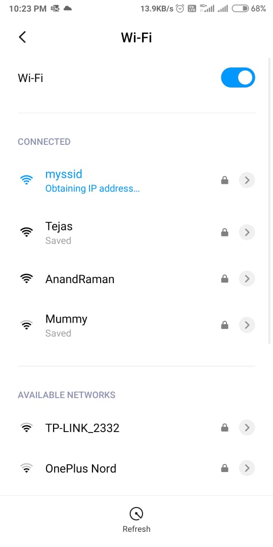

I am also facing the same issue. I can not find "CONFIG_LWIP_DHCP_DOES_ARP_CHECK " option in menuconfig as "rayf15" suggested. I am trying smartConfig Example with "WIFI_MODE_APSTA " Mode. I am able to provision ESP successfully and I can see ssid in mobile wifi list screen. but when I click on it then it showing "obtaining IP address...". can someone help me? Thanks

Re: ESP32 connects to Access Point but can't get IP address
Is your issue has been resolved or still ongoing?I am also facing the same issue. I can not find "CONFIG_LWIP_DHCP_DOES_ARP_CHECK " option in menuconfig as "rayf15" suggested. I am trying smartConfig Example with "WIFI_MODE_APSTA " Mode. I am able to provision ESP successfully and I can see ssid in mobile wifi list screen. but when I click on it then it showing "obtaining IP address...". can someone help me? Thanks

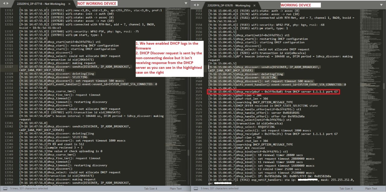

Hi, we are also facing the same issue but for us some of the devices are getting IP and some aren't.
- In the router - MAC id whitelisting is done correctly, we have checked free ips are available.
- Enabled DHCP logs, discover request is being sent from the devices but not all of them is receiving response from DHCP server (router)
CONFIG_LWIP_DHCP_DOES_ARP_CHECK isn't enabled. Any ideas on how to resolve this.
Thanks in advance for your help.
