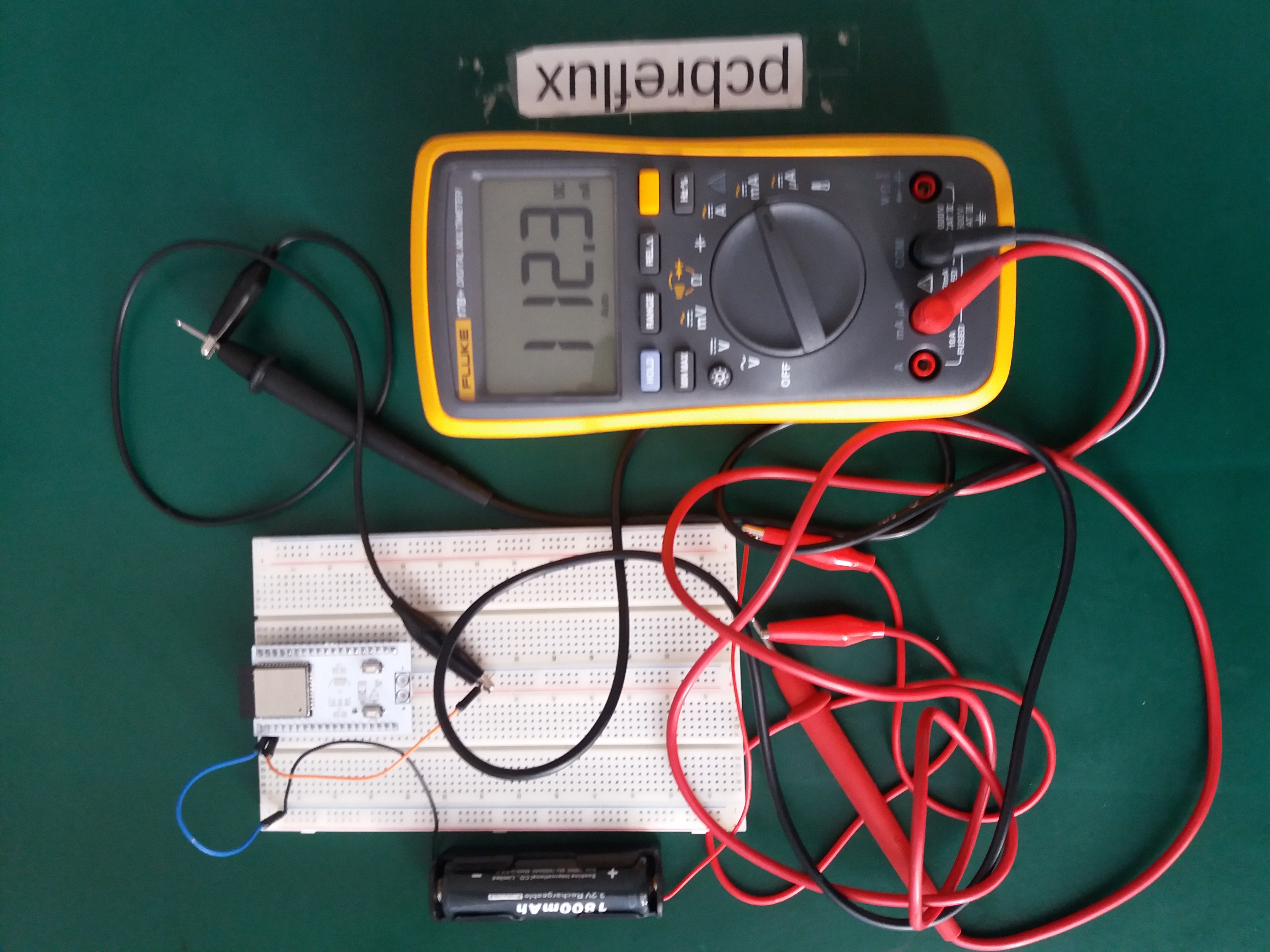

I am looking at the 9mA mesurement but don't see the connected ESP32? only some kind of resistor? Missing some thing? What voltage are the (same?) batteries?

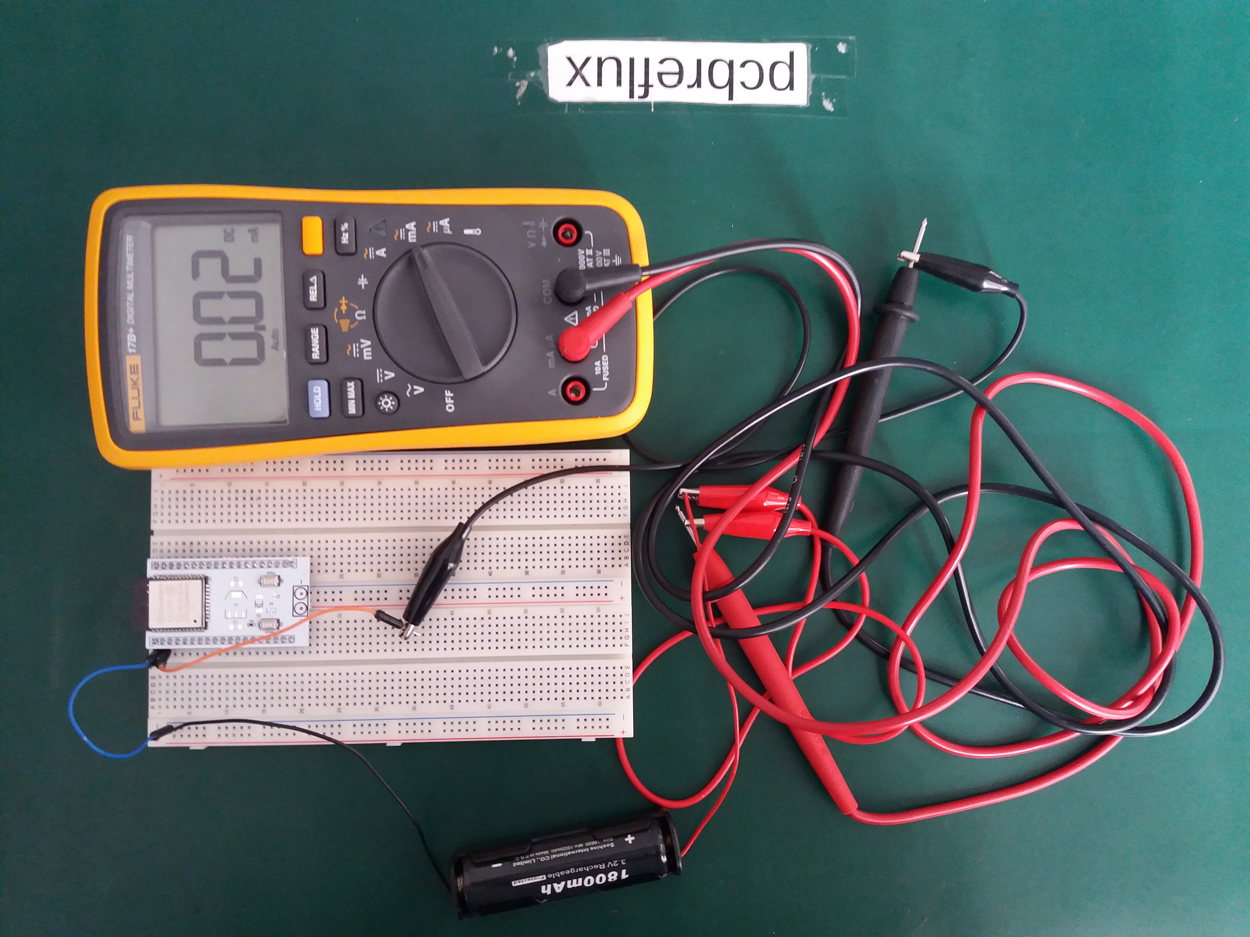

Similar setup with different multimeter:
Source https://github.com/pcbreflux/espressif/ ... leep_timer
LiFePo4 3.4V
Wakeup 55mA
Deep sleep 20uA

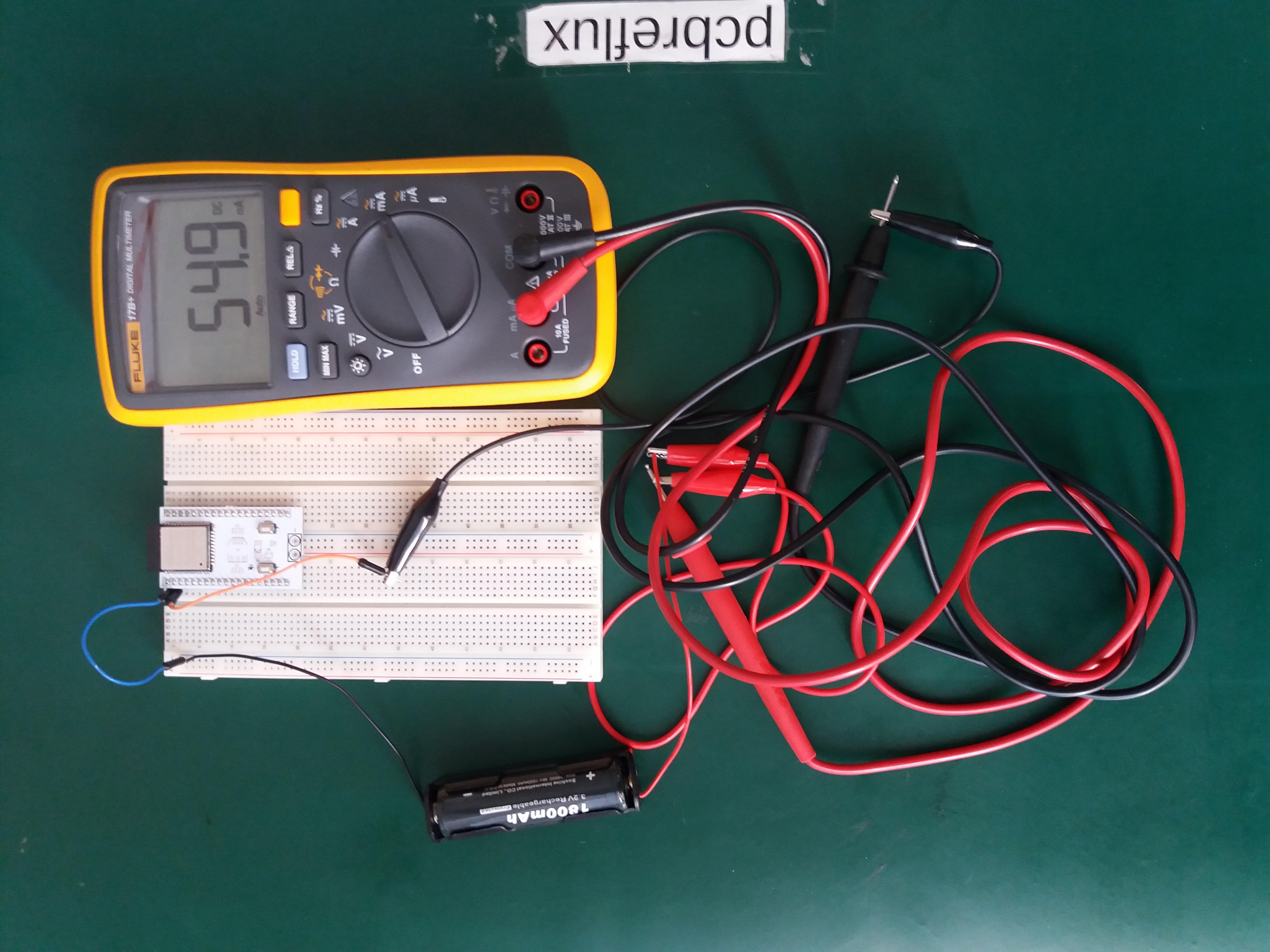

andrew_p
Posts: 30
Joined: Sun Jan 01, 2017 5:37 pm
Re: Deep sleep power consumption - has something been changed in the latest ESP_IDF release?
Postby andrew_p » Mon Feb 13, 2017 7:45 pm
Blue NOA board is disconnected on the picture with 9uA measurement. ESP32 is just not fully visible on the photo, because it's a side view - ESP32 mounted on a small PCB with battery handlers and powered by 3.2v LiFePO4.

Some additions to the mesurements with the Fluke 17B+:
losses: Long leads, battery holder leads,
crocodile clips, breadbord + wires + pcb adapter
dmm accuracy at mA 1.5% +-3 Digit
uA Range ESP32 dont start
burden Voltage?
shunt ?
Start with WiFi (MQTT Example)

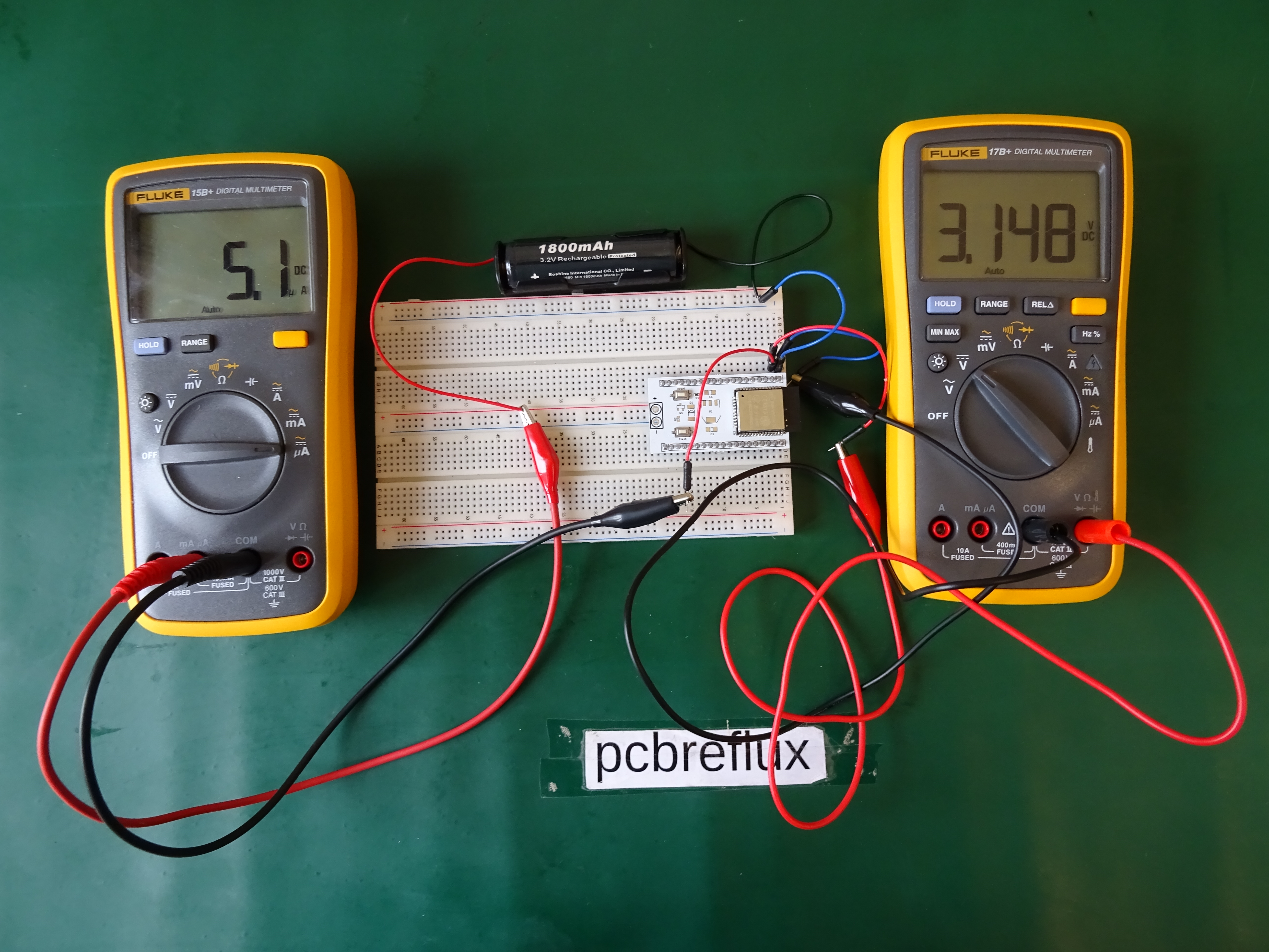

Postby pcbreflux » Tue Feb 28, 2017 9:53 am
New Setup with new esp-idf: looks fine
commit 13dfb5568dcc30aa43363c49f7a4505d04036424
Date: Fri Feb 24 22:23:06 2017 +0800
Module: ESP-WROOM-32
Adapter: only Reset with 10k Pullup and GPIO 0 Button, no other components assembled
LiFePo4: Soshine 18650 3.2V 1800mA
Teststeps:
Step1: Flash deep sleep Test firmware: (https://github.com/pcbreflux/espressif/ ... leep_timer), GPIO_DEEP_SLEEP_DURATION=1000
Step 2: USB to UART converter removed
Step 3: to start Fluke 15B+ is bridged/shorted (assumption: DMM shunt/voltage drop in uA range to high, Volt on Fluke 17B+ ~1.8V)
Step 4: when ESP32 enter deep sleep bridge is removed
Hey, better than before, right? 9.46uA -> 5.1uA? Nice.
