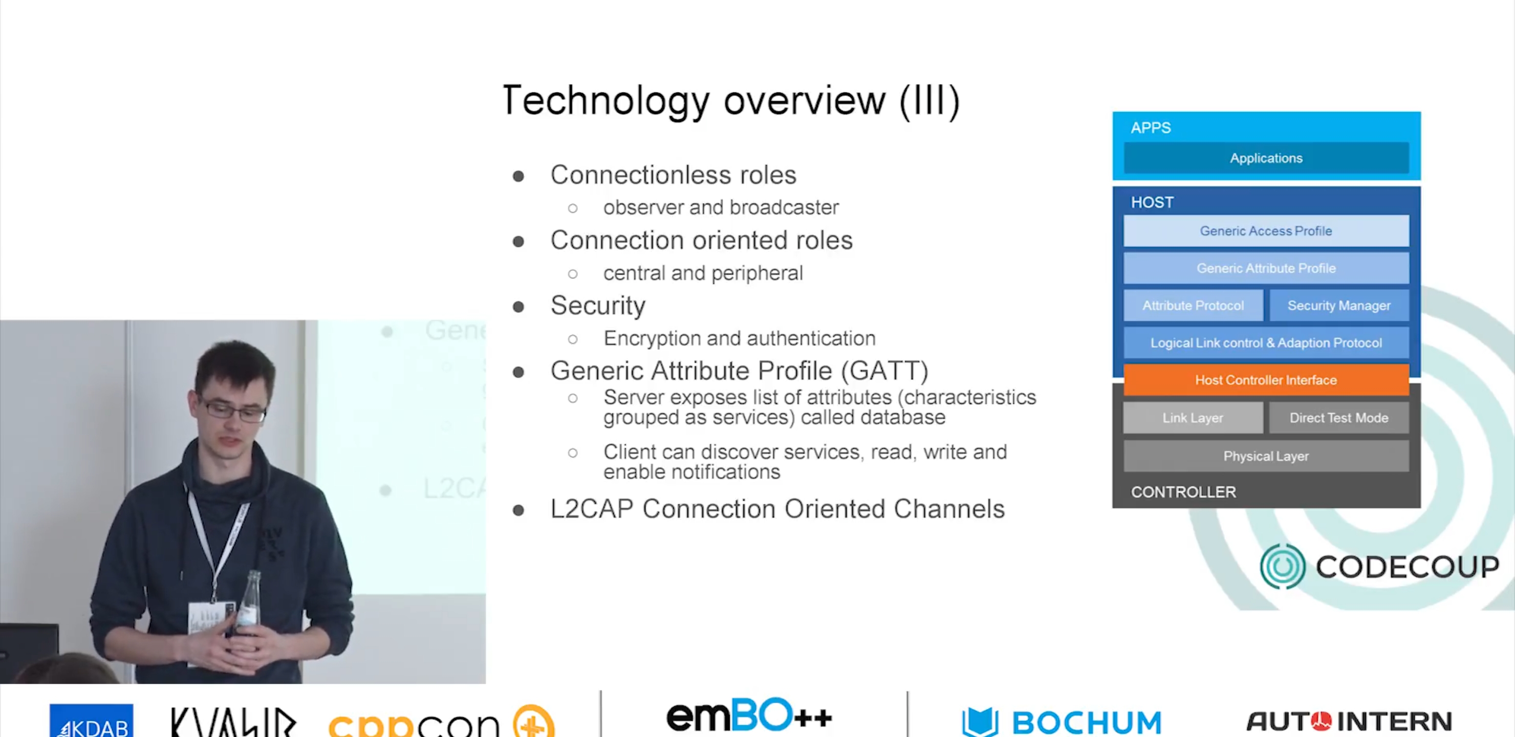

chegewara
Posts: 2505
Re: Disabling & Re-enabling BLE
Postby chegewara » Tue Dec 03, 2019 5:20 am
Maybe this is not about esp-idf structure, but recently I found this video on yt. On this screenshot you can see how controller is separated from host:
And here is video:
https://youtu.be/DAk38x2ou3s
