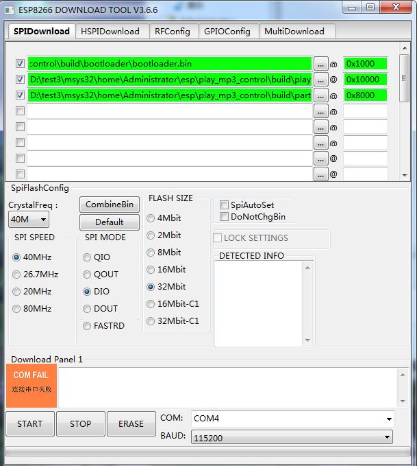

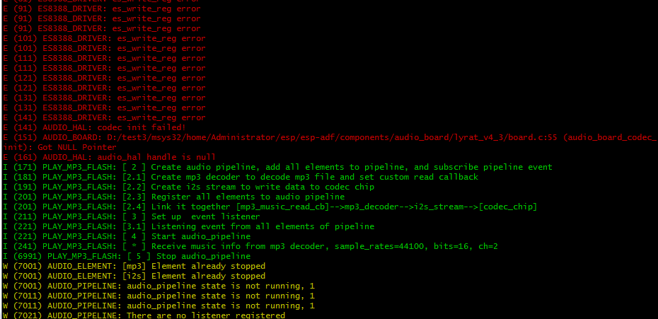

I had some problems with the play_mp3 instance:
The coder init failed displays when I use the make flash monitor command.
The connection serial port failed when I burned it using flash_download_tools

looks like the HAL didn't init or the wrong board is selected.
Have you tried idf.py menuconfig to select the right board?

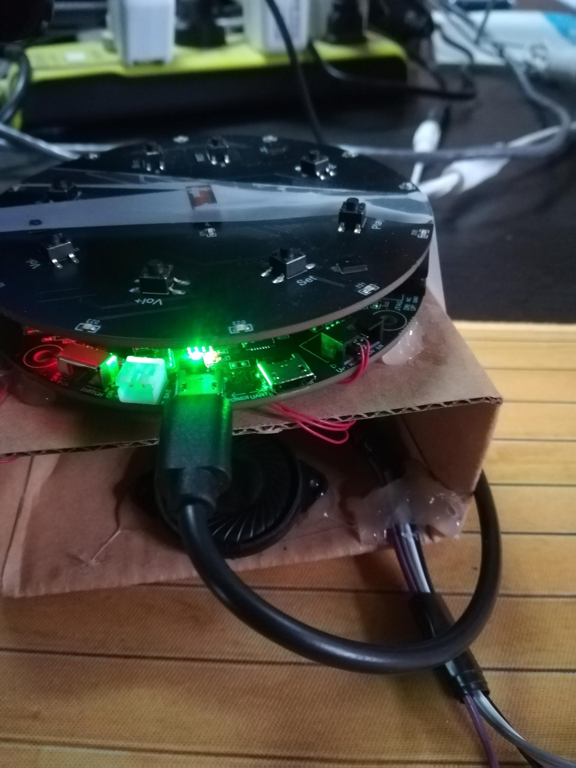

That looks like the LyratD-MSC board, but your logs are showing HAL for Lyrat-V4.3 board.
