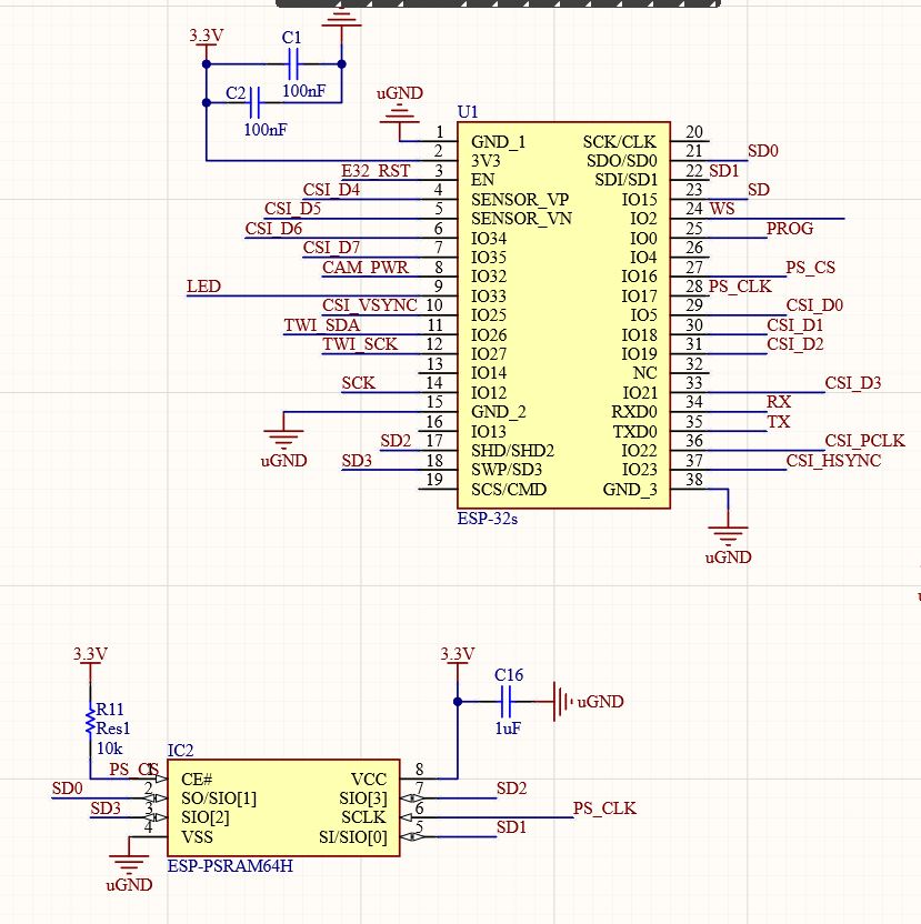

Postby jgustavoam » Sun Feb 09, 2020 1:59 pm
"Board is a personalized design"
Post the schematic diagram of this board.
There are some restrictions on the use of the SPI interface on ESP32.
It may be that your problem is violating these restrictions.

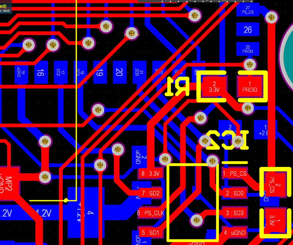

Hello, I have same Problem:
I have designed a board with ESP32-S/WROOM-32, according to AI-Thinker_camera module. I used ESP32-PSRAM64H,but whenever it initialzes it fails in memory test and I get this error:
esp_psram: SPI SRAM memory test fail. 8672/131072 writes failed, first @ 3F800140
What is the problem?
