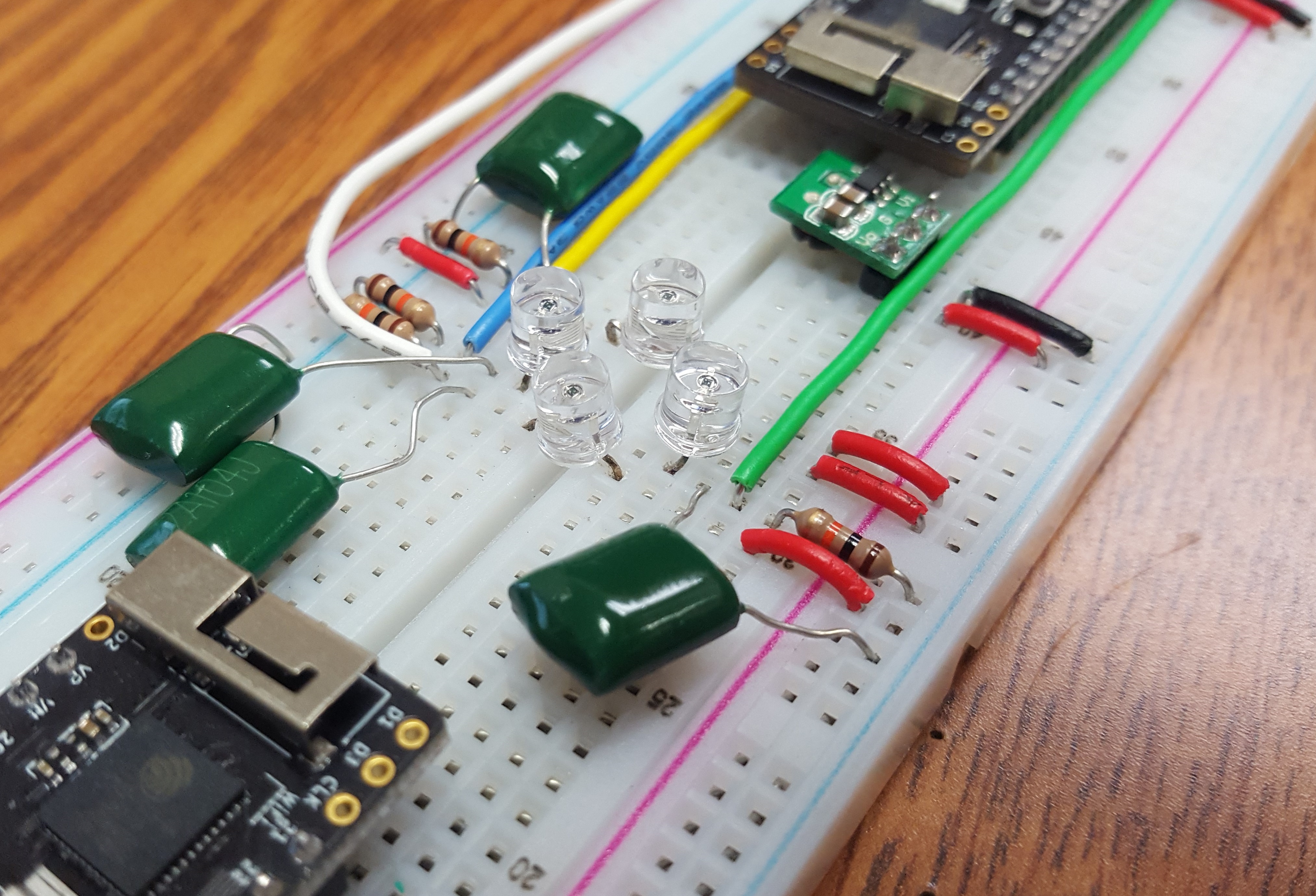

I just posted some code for ADC readings for the ESP32.
It takes values from an array and smooths them out.
viewtopic.php?f=18&t=13053
I get good results after smoothing out the values and using 0.1 uF capacitors.
See this in Espressif documentation:
https://docs.espressif.com/projects/esp ... s/adc.html
Multisampling and capacitors help a lot.
Idahowalker's advice that I got a while back about using the code in post I mentioned above is also good versus using analogRead commands of Arduino IDE.

- Photodiodes ADC values with .1 uF capacitors.jpg (2.43 MiB) Viewed 13862 times
