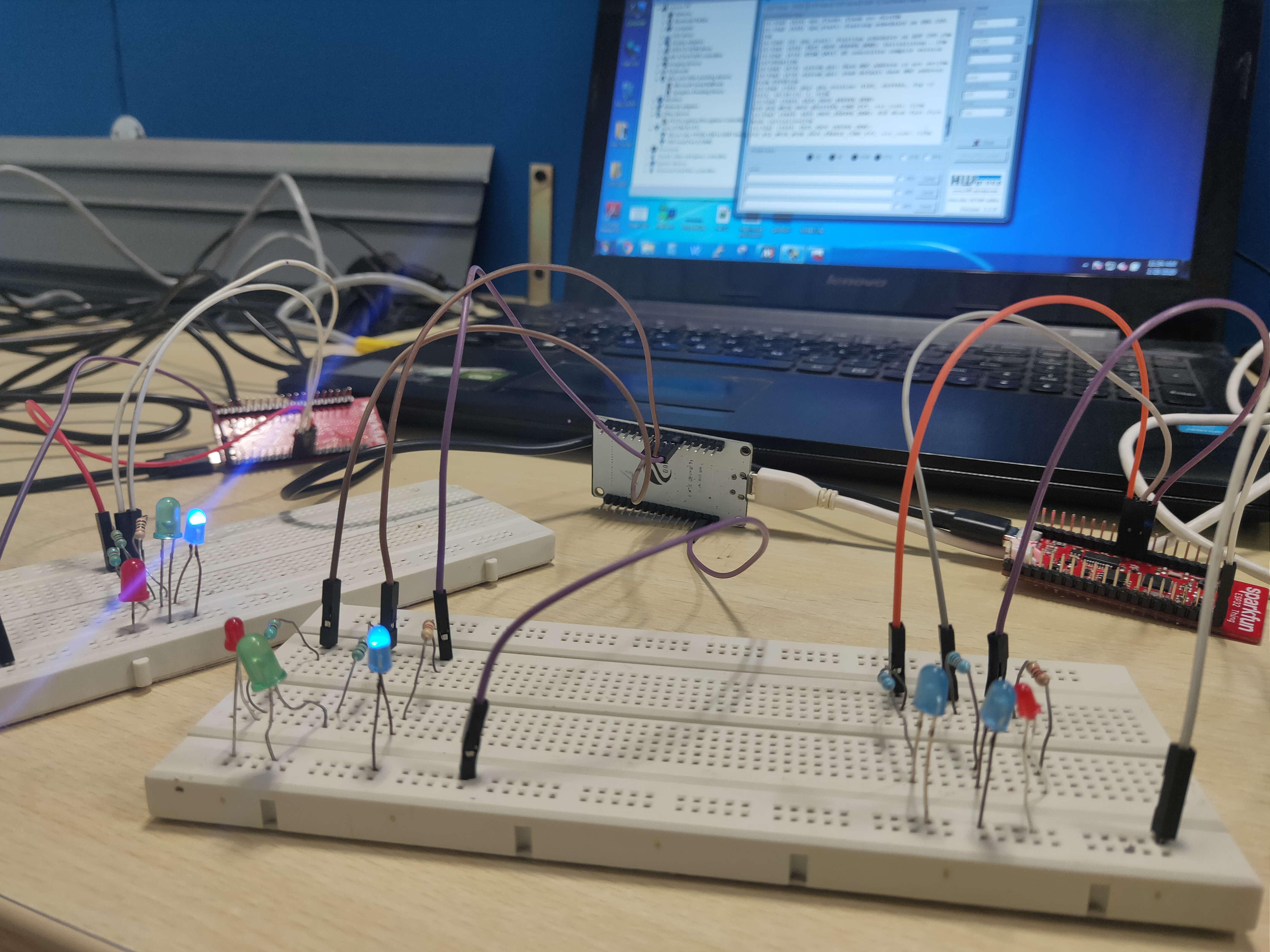

I am using three ESP32 Modules to form a BLE Mesh Network and I have uploaded the following example code to all three ESP32 boards.
https://github.com/espressif/esp-idf/tr ... rov_server
Ultimate aim of this example is that mobile device will provision a node i.e one ESP32 and that node has to provision the other two nodes to the mesh network. I am able to provision only one node and that node is not provisioning other two devices . I followed the below steps :
1.Uploaded the all example code which is in URL to all ESP32's
2.In EspBLEMesh app I started provisioning and then filtered the available ESP32's by UUID "dddd"
3.I was able to find the all the three devices and selected one of them.
4.Before provisioning that node I selected fast provisioning and entered the Expect fast provisioning count as 3
5.My EspBleMesh application is connected and in fast provisioning application i am finding only one node which is connected and i am able to control that.
I Confirmed that connected node is not provisioning other devices by seeing the Blue LED. If the node has got provisioned then the blue light will turn off automatically. But the Blue light of other nodes are not offed as they are not provisioned .
How I have to solve this error ? Do I need to add any AppKey and NetKey to the EspBLEMesh application ?

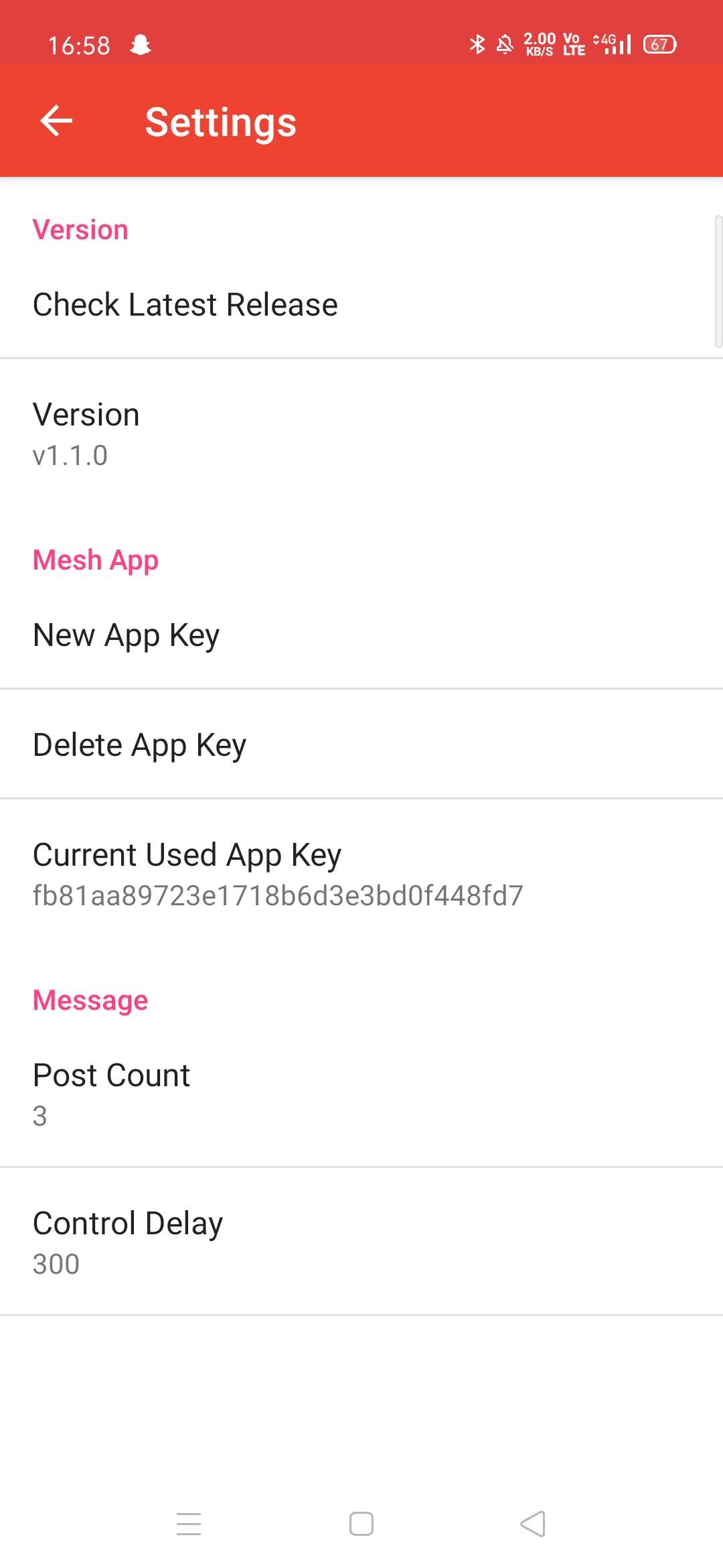

- As one is provisioned only one blue led is in off state and it is not provisioning other devices .
- FastProvison.jpg (3.33 MiB) Viewed 40150 times

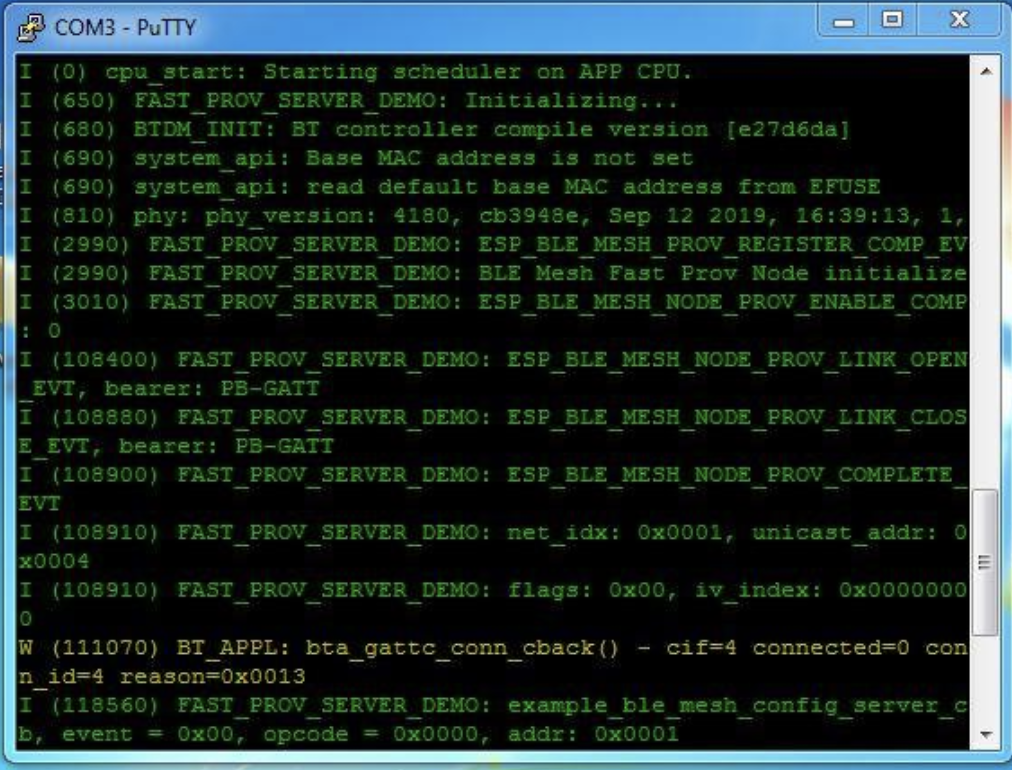

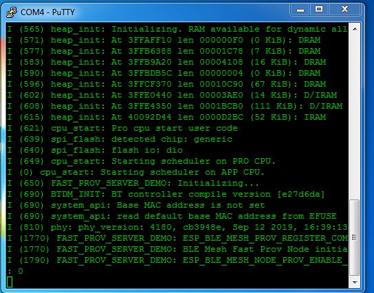

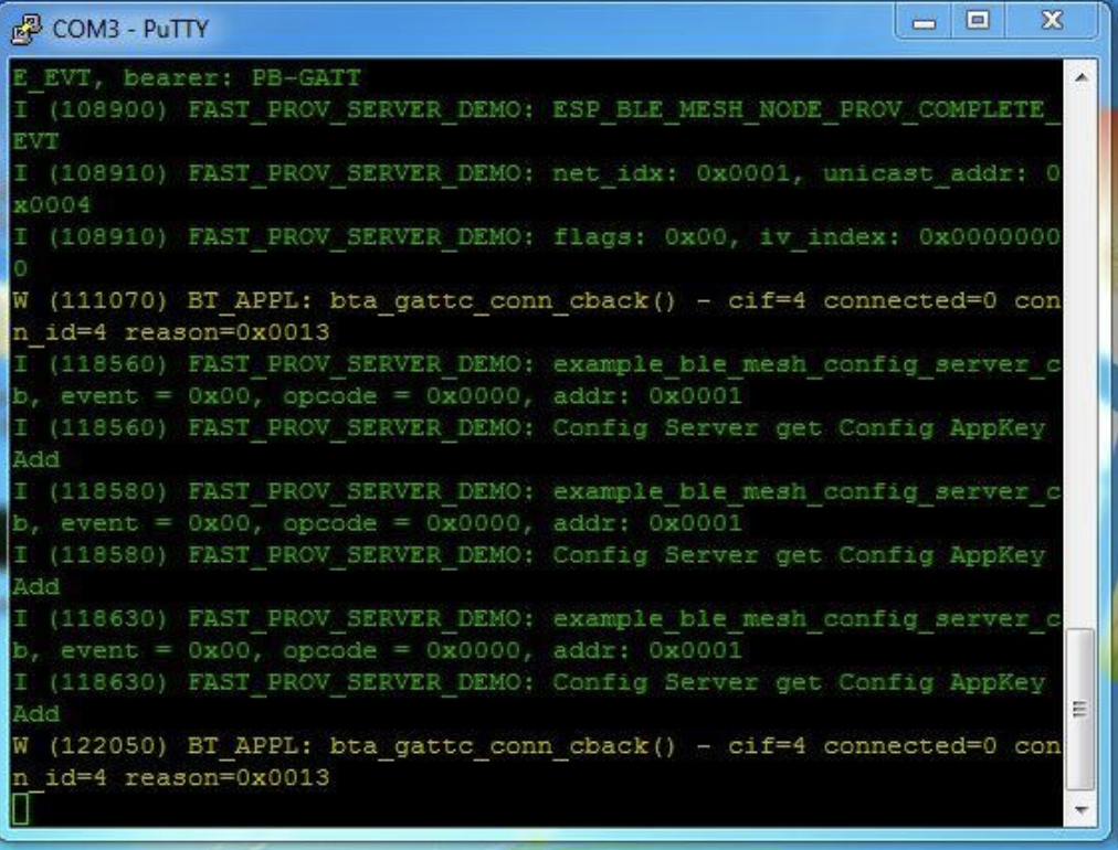

These screenshots are from the device which has got provisioned by the mobile device by EspBleMesh Application.I am sharing the screenshot of other devices which are ready to provision .
- Device ready to provision and not get provisioned by the device which has got provisioned by the mobile device
- three.JPG (80.33 KiB) Viewed 40036 times
- Screenshot 1941-12-14 at 17.02.39.png (1.04 MiB) Viewed 40036 times
- Screenshot 1941-12-14 at 17.02.17.png (1.11 MiB) Viewed 40036 times

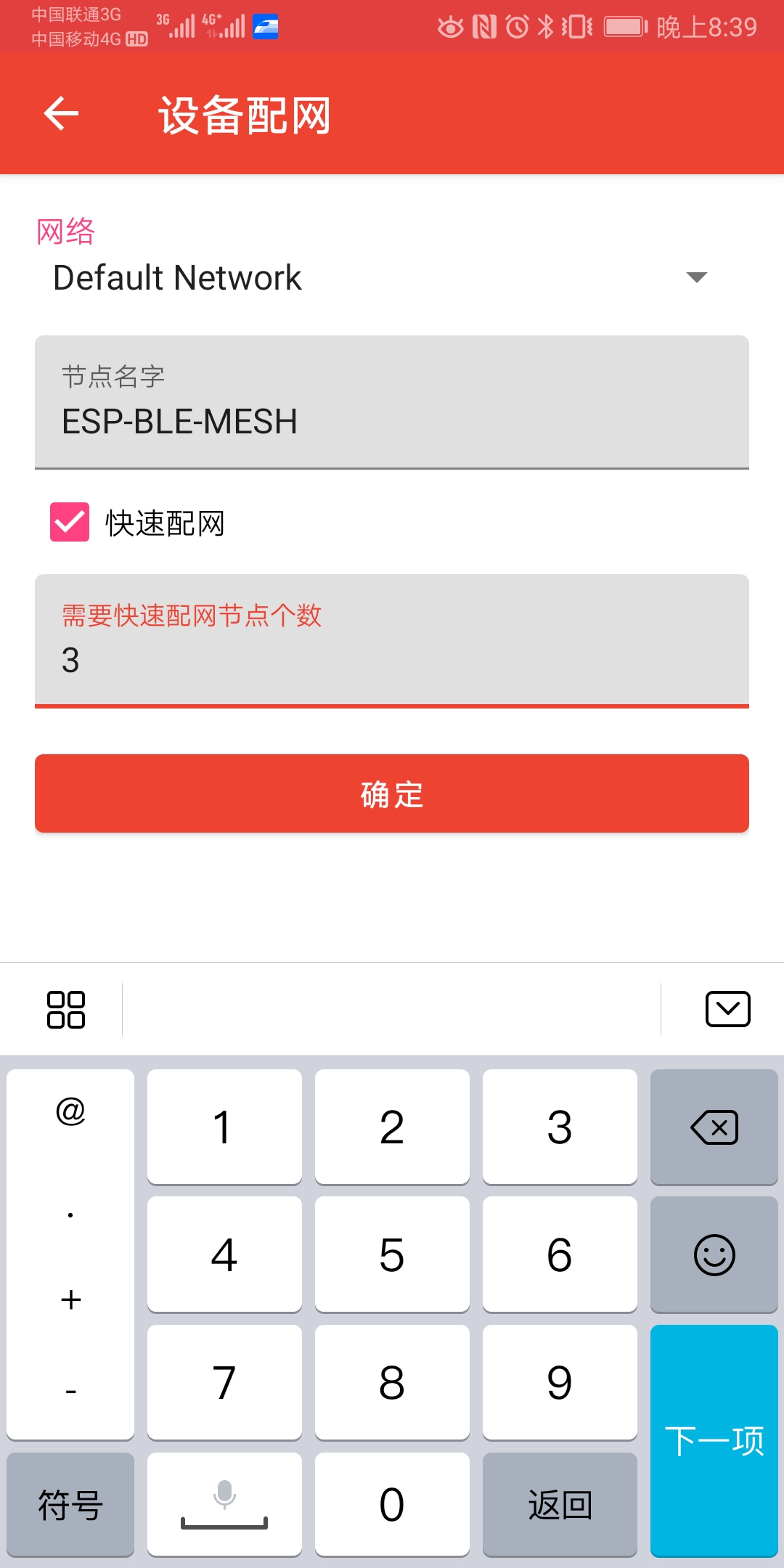

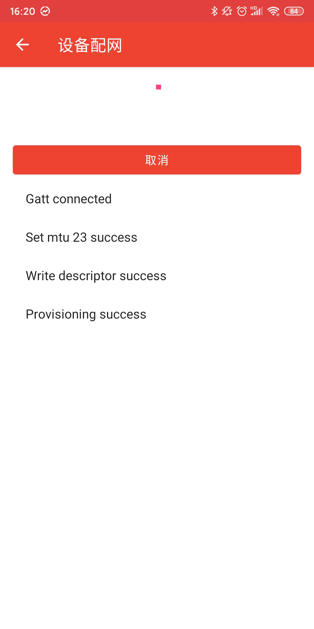

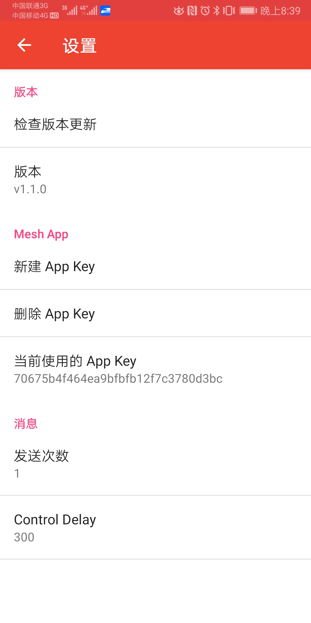

Re: ESP BLE MESH Fast Provisioning
https://github.com/EspressifApp/EspBLEM ... d/releasesThese screenshots are from the device which has got provisioned by the mobile device by EspBleMesh Application.I am sharing the screenshot of other devices which are ready to provision .
I use the master branch of github to try the basic function is normal, you should check the version of the app. The key operation steps are shown in the attached figure:
- Screenshot_20200304_203953_com.espressif.espbleme.jpg (172.67 KiB) Viewed 40018 times
- Screenshot_20200304_203942_com.espressif.espbleme.jpg (238.26 KiB) Viewed 40018 times

After provisioning one node my mobile is disconnecting to the node and that provisioned is provisioning all other nodes. When provisioning of nodes in the network is completed, the first provisioned node is not connecting to the mobile . Thus I was not able to control the nodes.
- lu.jpg (59.86 KiB) Viewed 39813 times
Hi @koteswaraAfter provisioning one node my mobile is disconnecting to the node and that provisioned is provisioning all other nodes. When provisioning of nodes in the network is completed, the first provisioned node is not connecting to the mobile . Thus I was not able to control the nodes.
After all the nodes are provisioned, you need to choose the first provisioned node on the app and connect will it manually.
Thanks.
