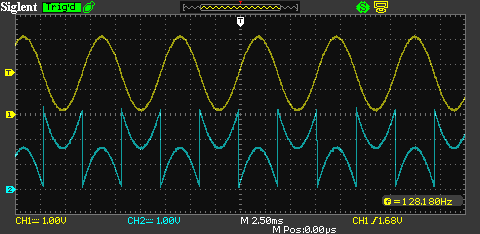

Postby HelWeb » Sun Apr 28, 2019 10:10 pm
From this excellent work as base
https://github.com/krzychb/dac-cosine
I build a signal generator to produce sinus signals from 18Hz to 250kHz.
From 50Hz to 100kHz the difference to the wished frequency is about 1%
And it works without CPU after initialisation.

I'm looking at the esp32 Technical Reference Manual, section 28.5.4, and it says:
A phase-shift of 0 / 90 / 180 / 270 degrees can be added by setting register SENS_SAR_DAC_INVn[1:0].
Do you think this is just a documentation error? My experimentation with the invert values has discovered useful output with values of 2 (what's used in the demo code) and 3 (inverted), but 0 and 1 generate... odd waveforms. They look like a sign error of some sort.

Some interesting trade-offs using this as a waveform generator.
If you use an RTC clock divider of 1, you get lovely smooth waveforms, but you can only generate multiples of ~131.6Hz (at least on my board). Waveforms up to the 500kHz range look pretty decent.
If you use an RTC clock divider of 8, you can generate multiples of ~16.6Hz, but with 8x fewer samples, so you start seeing stepping at 100kHz.
I'm wondering if they had a use case for this, and what it was?
