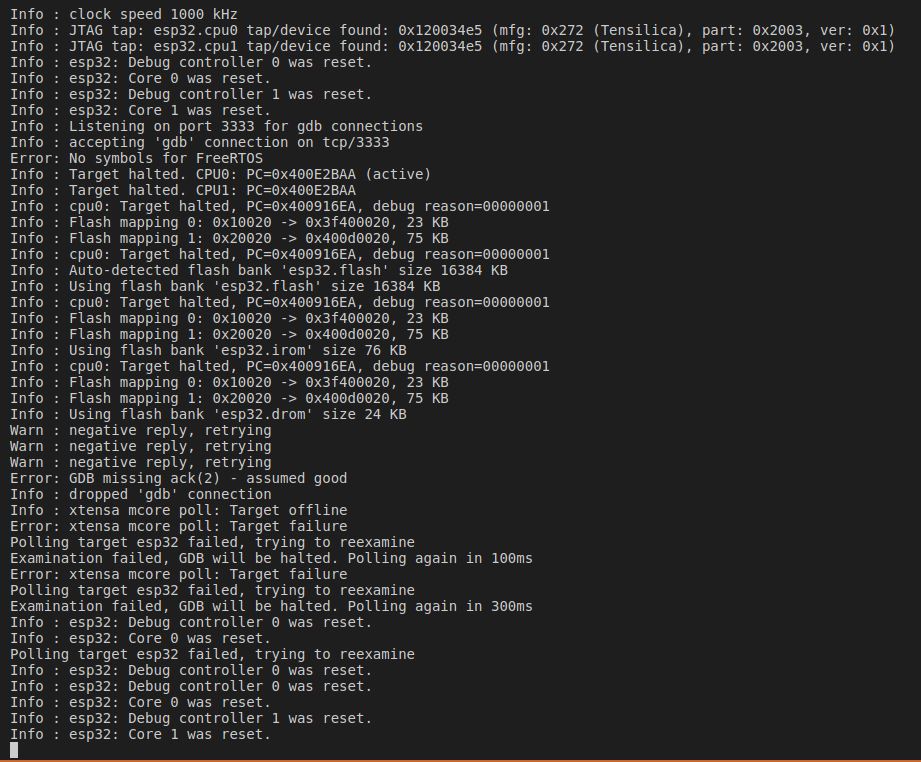

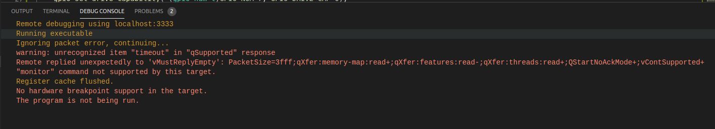

I am working on my own board. The code, letting a led blink, is working, the led blinks.
The tools, all latest version, are running on Ubuntu (virtual machine) under Visual Studio Code. Compiling and programming works fine but I am already busy for two weeks trying to get the debugging working. I am using a JLink and have checked all signals with an osciloscope. The connection is running:
I don't know how to go further. Can someone give me some advice? Thanks in advance.
Debugging with JLink doesn't work
Re: Debugging with JLink doesn't work
Can you post your openocd *.cfg file and any gdb config in .gdbinit (or similar)?
Hi, do you use all the latest versions? Like openocd 20191114? I also tried version 20190313, same result.
Here is the openocd board config:
And here JLink interface:
And finaly the GDB init for which I tried to add/remove every item:
target remote localhost:3333
set remote hardware-watchpoint-limit 2
mon reset halt
flushregs
thb app_main
c
I also did it all manually to find out what goes wrong. I am at the point now that the mon reset halt instruction gives the error that the target does not support the monitor instruction.
One more question to which I can't find the answer: besides the jtag connection, is the serial connection mandatory to make things work? I have the serial connection on ttyACM0 and I can't find how to change the default setting in vscode.
Thanks for the help!
