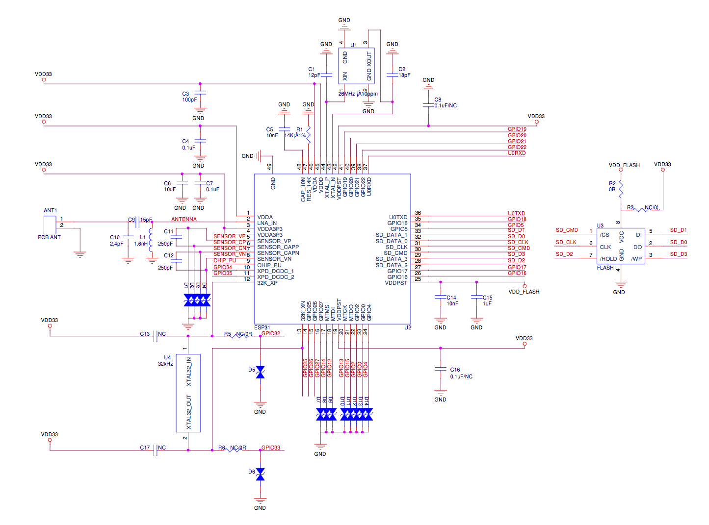

I wasn't able to open .pcb with OrCad Lite but maybe I just don't know how. It seemd to open .brd and bunch of other extensions, just not .pcb. I managed to open and capture the schematic though - attaching it. At least something.
Although the most important thing is for us is ESP_MODULE_PCB_LAYOUT_DIAGRAM.pdf which is in the zip. It should be enough to make a footprint for pcb placement of ESP32 module.
From bom list we can read that ESP32 will be QFN32 5x5 just like ESP8266 and there will be gd25q16ct 16 Mbit flash.
