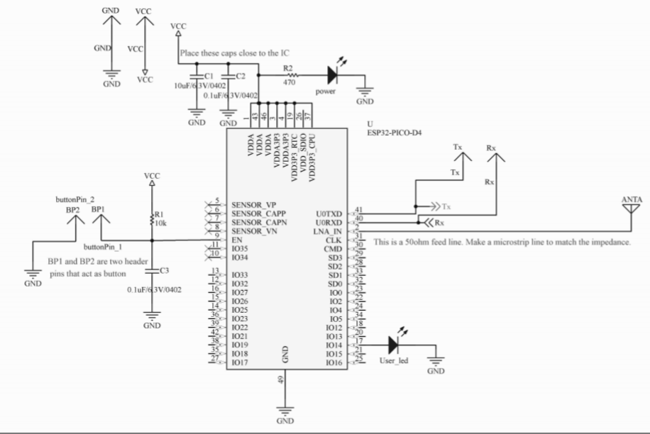

Hi team,
I have attached my schematic here. I sense some problems with my strapping pins. I want to directly upload the code from the Rx and Tx pins. Som for this did I configure my strap pins correctly? Shall I proceed with my Layout?
https://photos.app.goo.gl/ZQi6PmXs7GNxj5Rz8

You missed IO0. This is the pin that puts it in bootstrap mode.

Hi mikemoy, how should I strap that pin? Should I pull down it? I think i wanna strap both GPIO0 and GPIO2 pulled down. Anyways IO2 is pulled down and IO0 must be pulled down for downloading the code using Rx and Tx?
Please do help me out on this. Thank you so much in advance.

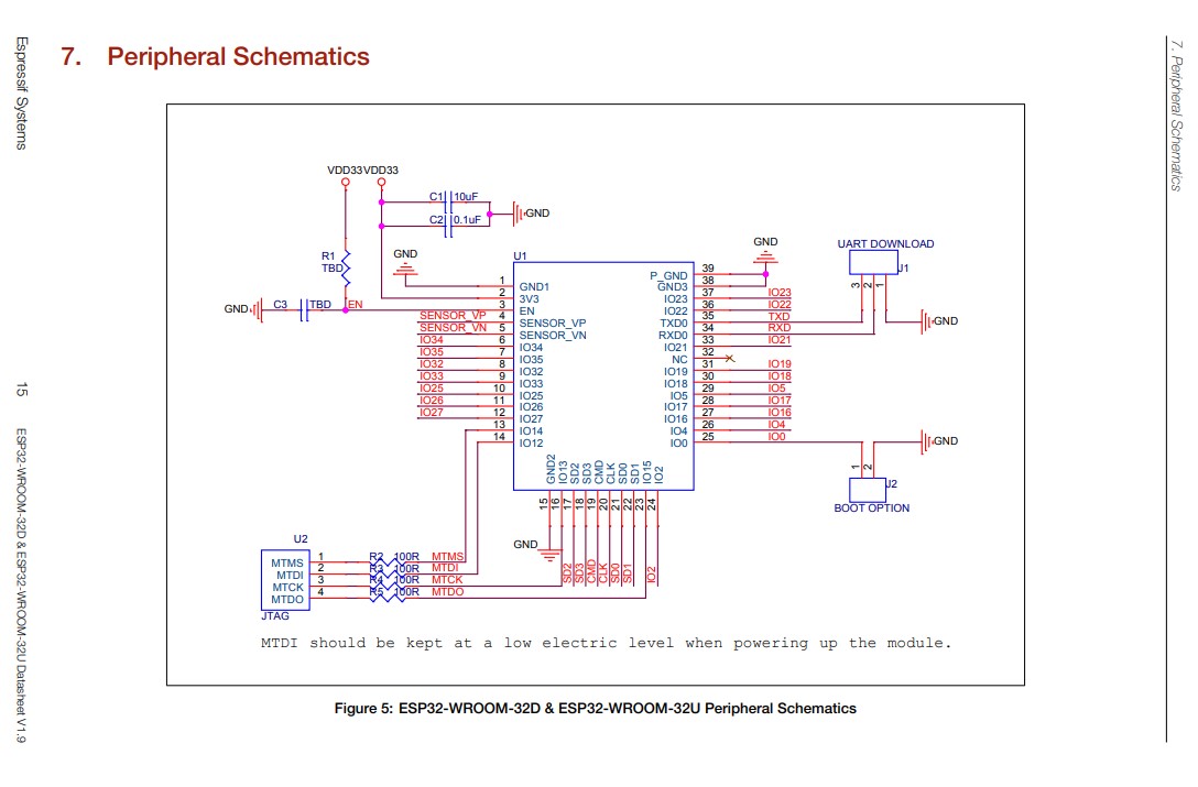

Postby mikemoy » Sun May 03, 2020 12:26 pm
The same way you strapped EN. But you wont need the cap.
Taken from the data sheet.
