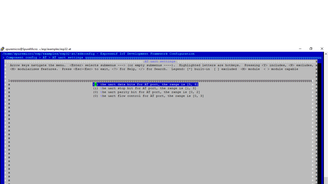

7. Now we need to reconfigure the ESP32-AT firmware by using 'make menuconfig'. A graphical config console pops up and we select:
  • 'Serial flasher config'->'Default serial port' to configure the serial port for downloading. On my Windows machine this is simply 'COM7'. Additionally you may increase the baud rate.
  • 'Component config'->'AT'->'AT uart settings' to set the AT cmd UART to the same as the debug interface (both to UART0 so that debug output and AT interfacing runs via the USB bridge chip). The settings are as follows:
    • uart port number: 0
    • uart rx pin 3
    • uart tx pin 1
    • uart flow control 0 -- by defaul HW Flow Control via RTS/CTS is enabled. Disable it or the UART-USB bridge won't handle it

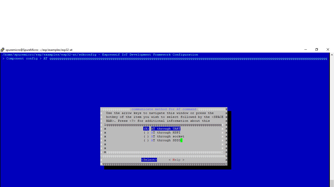

I want to change the AT Uart interface to uart0 to take advantage of my hardware.
I can't get the option under component config ==>AT ==>Uart settings : no uart port option available
just the protocol options available

@polineers, to change the UART pins you just have to edit:
components/customized_partitions/raw_data/factory_param/factory_param_data.csv
Then make clean, make flash.
I believe I put the menuconfig back to the stock settings so this is the only change. Actually I take it back, I made one change in menuconfig: Component config > AT > AT uart settings > the uart flow control for AT port -> set to 0.

10. Set the UART settings
Still in the menuconfig
Component config --> AT --> AT uart settings --> the uart flow control for AT port --> 0 (for no flow control)
Exit the menuconfig and save your changes when prompted
