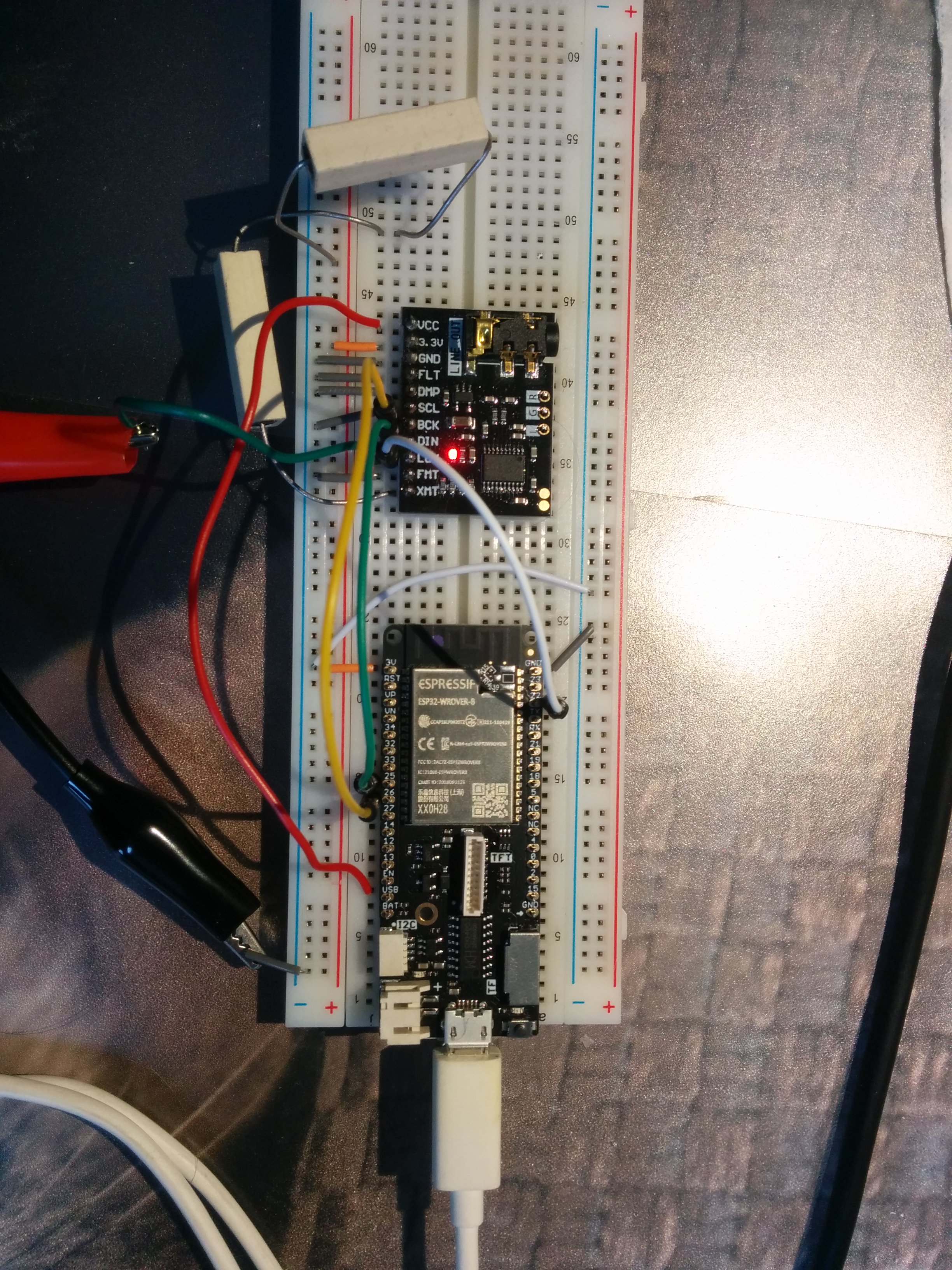

I took some photos so maybe you can figgure it out.

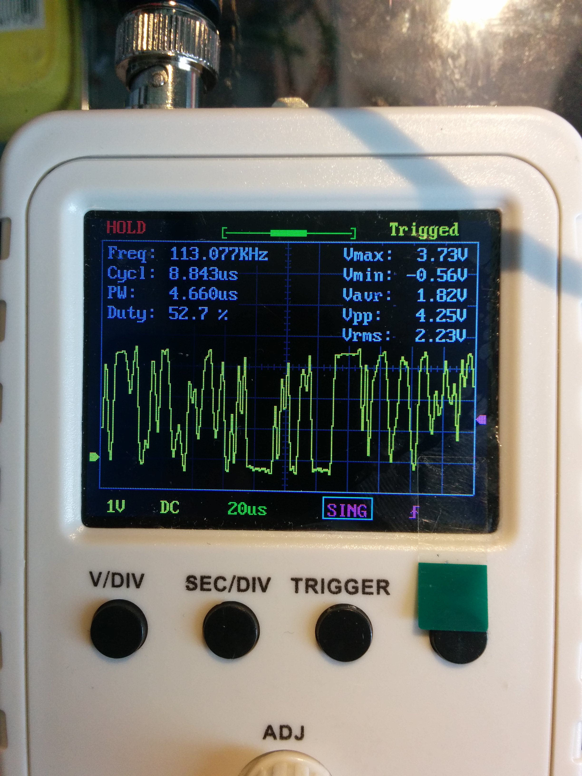

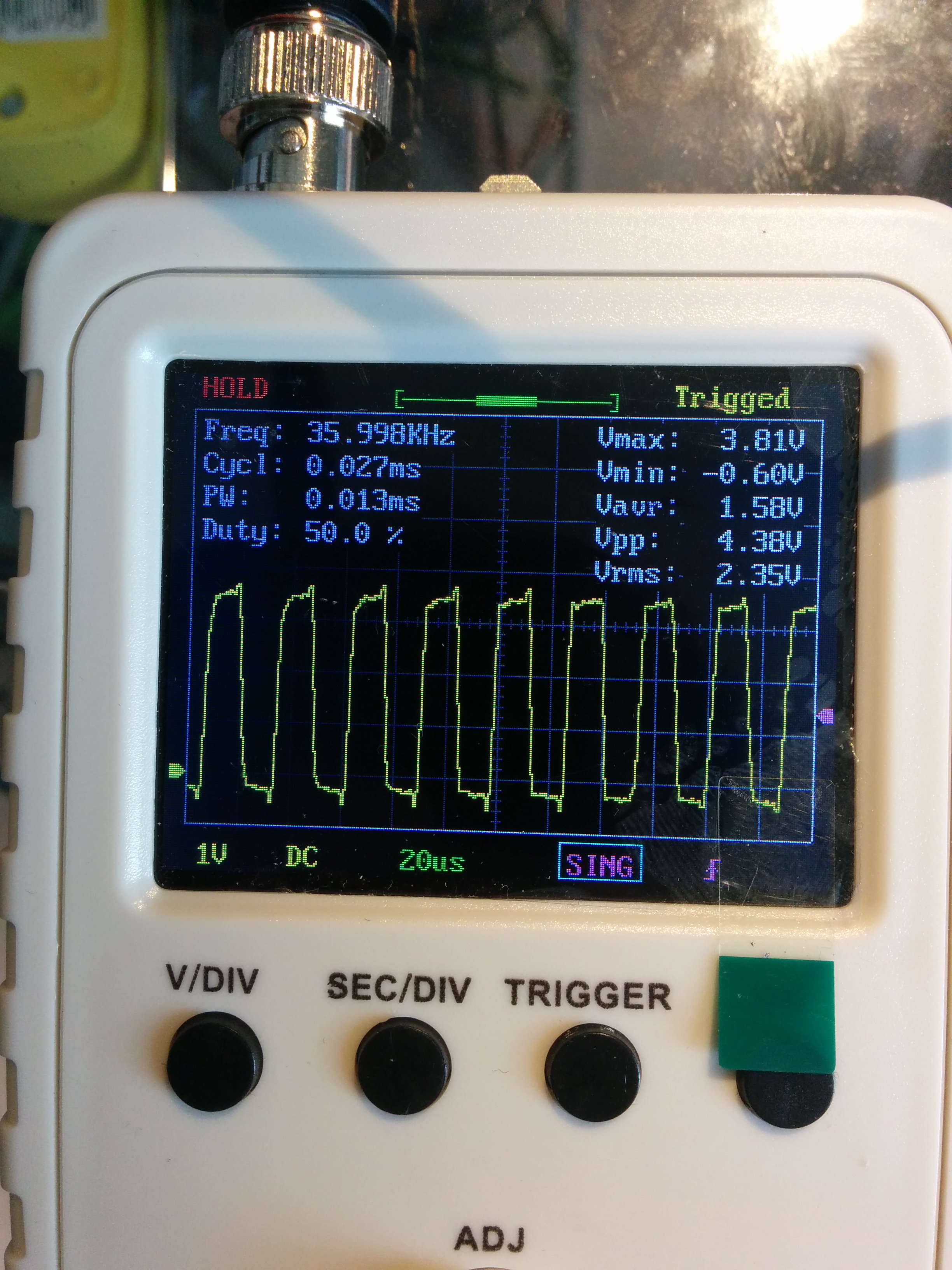

I also took photos of my scope. Wordclock and Data lines seem fine to me, but the bitclock looks off.

- wordclock
- wordclock_LR-clock.jpg (1.02 MiB) Viewed 15341 times

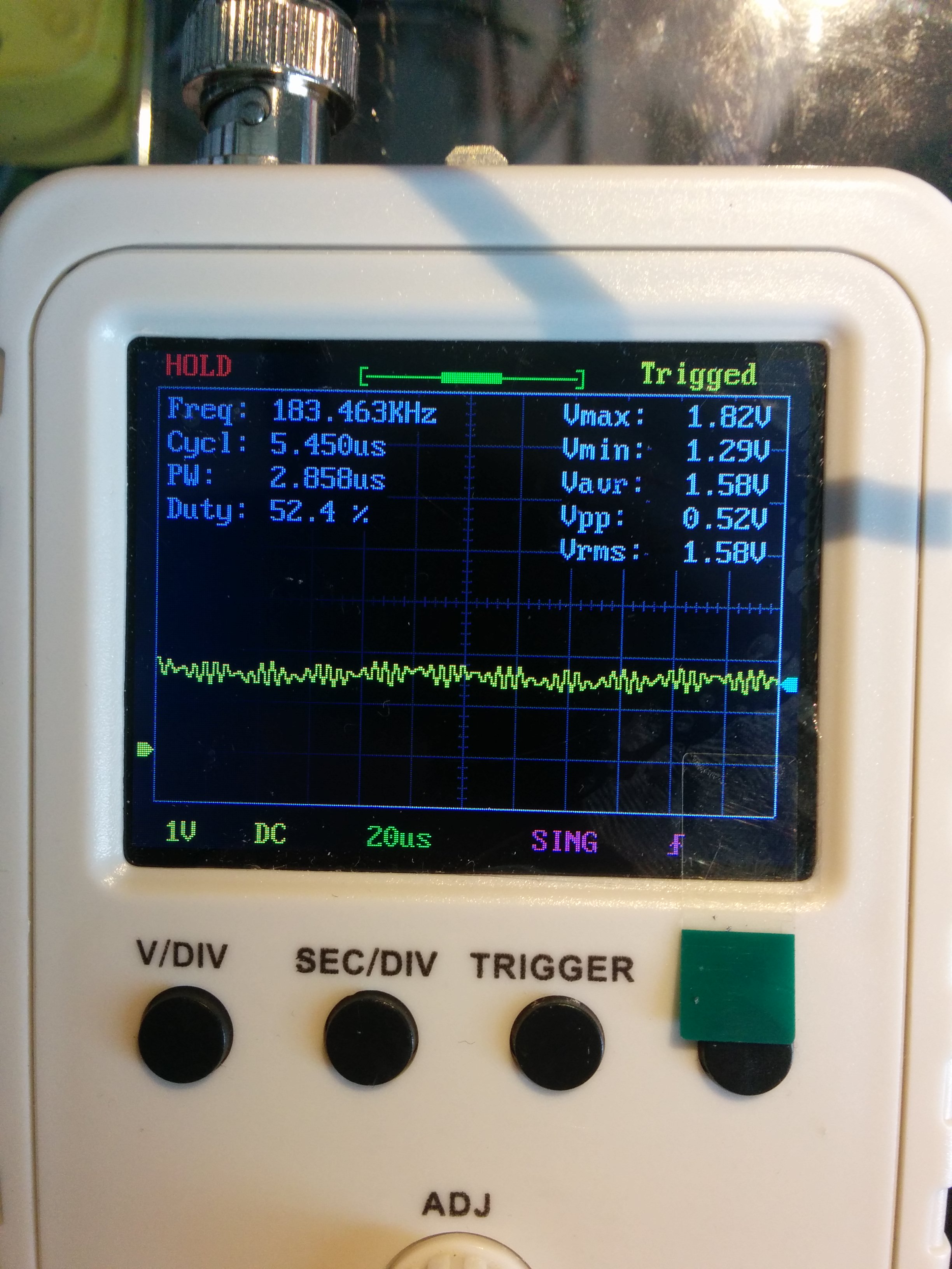

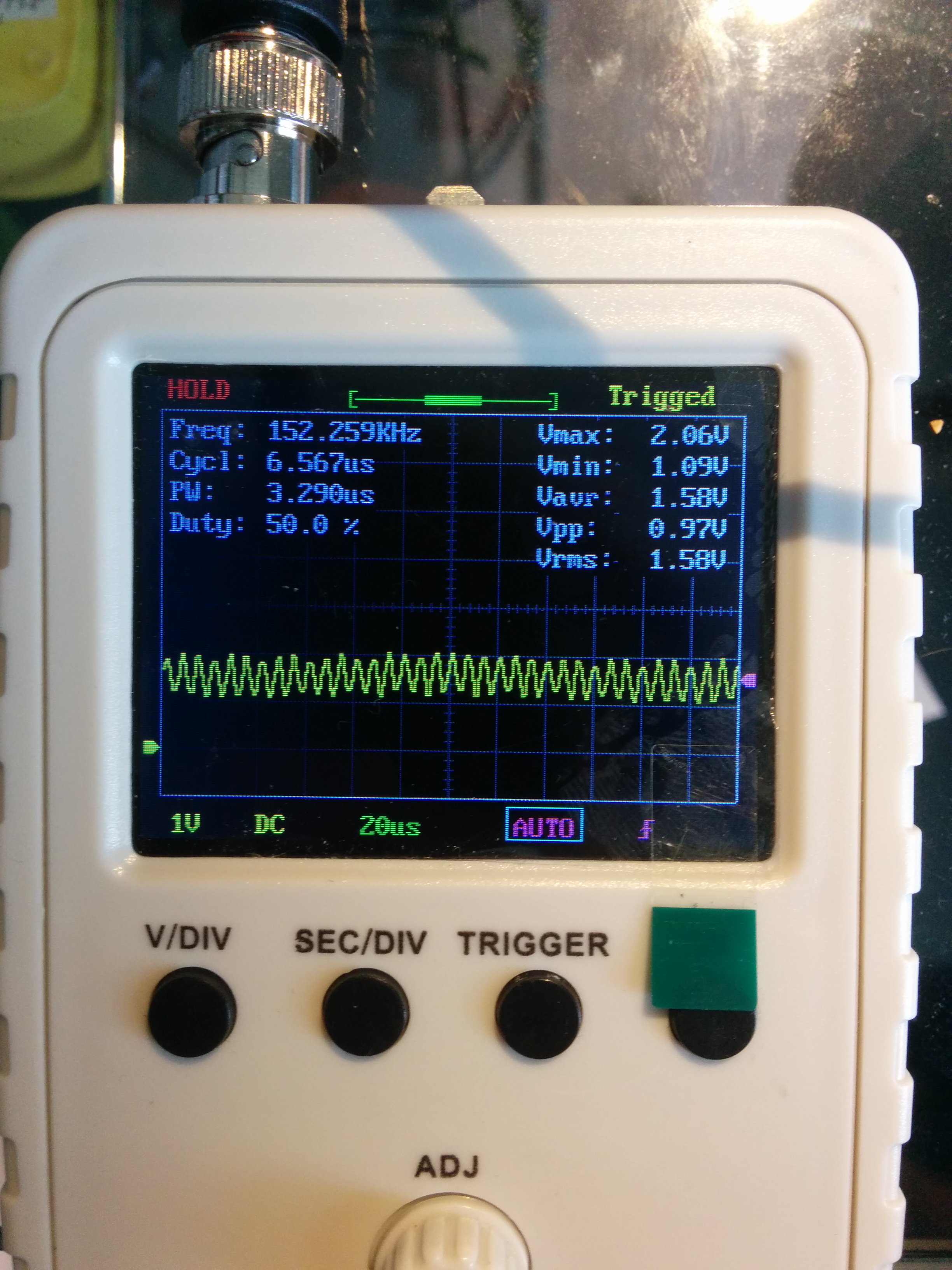

I took the photos of my scope with the simple i2s example running (changed the pins in the code to match the default pins from the a2dp_sink example).
As the i2s example cycles through the bitlengs the bitclock is changing (which it should i guess) but it looks off to me, it has an offset and pretty low signal amplitudes.
The pictures i took are with bitlength 24bit and with 16bit. With 16 bit the signal hat the highes and with 32bit the lowest amplitude.
I also checked that the PCM5102 isn't defective and just checked the signal directly from the esp32 withoud DAC connected, but the signal is directly from the esp.
Am I wrong and that is totaly normal?

Re: I2S BCK problem
Hi
No not normal at all - your LR clock should be you sample rate. I do not know of any setup that will end up with 36 Khz.
If you able to connect you phone audio source over Bluetooth you will be notified on any sample rate change from the source and the resulting call to set i2s clock with the resulting BCK clock.
Try to get that rolling and look for monitor log:

@Jakobsen i used the i2s example and not the a2dp_sink example for the pictures.
there the sample rate is defined as 36000, so everything fine with the wordclock. in the source: https://github.com/espressif/esp-idf/bl ... main.c#L21
@jgustavoam as stated i changed the pin definitions in the i2s example source to match the pins used by the a2dp_sink example.
changed pin definitions of the i2s example:
i don't get what you mean wth the board not having GND and VCC... it clearly has like shown in the picture.
and i don't think i have to make a ton of changes to good-quality examples that where meant to work with this chip i use or with other standards-following chips...
As stated previously the only thing i can't explain are the workings of the bitclock which is just all ower the place but somehow totally ignored by you...
wordclock is atleast a nice digital squarewave wich is more or less 3.3V, but why does BCK have 1.6V offset and <1V peak-to-peak? shouldn't BCK also be a 3.3V squarewave?
#define I2S_BCK_IO (GPIO_NUM_26)
#define I2S_WS_IO (GPIO_NUM_22)
#define I2S_DO_IO (GPIO_NUM_25)
