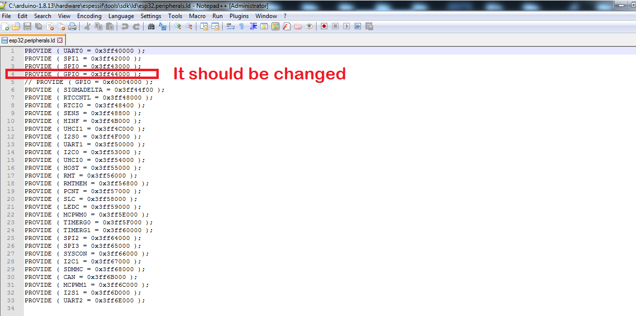

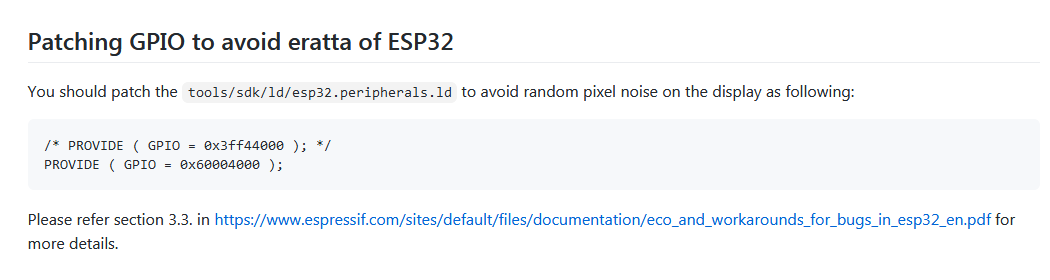

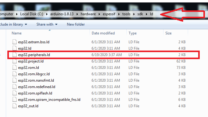

Thank you jgustavoam,
Yes i read it several times and also i had checked my chip version and it seems that it must works fine without any change in GPIO AHB address ( due to version one ), but it does not work fine.
So i decided to use a patch according to [url]https://github.com/NeoCat/ESP32-P3RGB64x32MatrixPanel/blob/master/README.md[/url]
please see the images ( main resource of error ) that i don`t know how i can solve it.
I changed GPIO but i`m not sure this is correct AHB address !!
May be this issue related to Arduino environment !

Re: Unreliable GPIO
Assuming that your issue is silicon then:
Upgrade to latest or rc/beta.
I would be very suprised (& in horror) if there are not both patches and a IDF/Ardunio version which supports this fix.
The silicon issue has been understood for a while and is not a casual 'oops' - the issue is very much in your face (& every library you use).
So I am thinking that you should just checkout latest?
Try a git checkout etc etc
