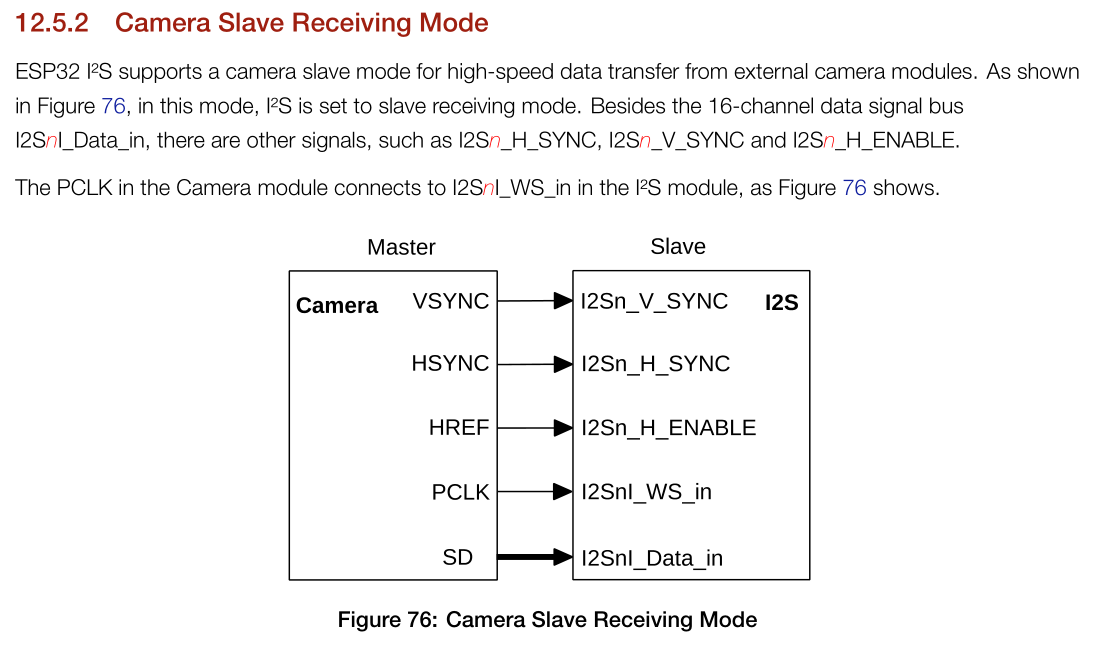

    gpio_matrix_in(DMD_SDATA,  I2S0I_DATA_IN0_IDX, false);
    gpio_matrix_in(DMD_PIX_CLK, I2S0I_WS_IN_IDX, false);  // word select as clk?
    //gpio_matrix_in(DMD_PIX_CLK, I2S0I_BCK_IN_IDX, false); //clk
    //for i2s in parallel camera input mode data is receiver only when V_SYNC = H_SYNC = H_ENABLE = 1. We don't use these inputs so simply set them High
    gpio_matrix_in(0x38, I2S0I_V_SYNC_IDX, false);
    gpio_matrix_in(0x38, I2S0I_H_SYNC_IDX, false);  //0x30 sends 0, 0x38 sends 1
    gpio_matrix_in(0x38 /*DMD_DE*/, I2S0I_H_ENABLE_IDX, false);

Now using 128bytes to represent 128bits seem very inefficient but perhaps that how to do it?
Also, examples I've seen for camera slave mode don't use the I2S0I_BCK_IN_IDX config and instead use the I2S0I_WS_IN_IDX.. this seems odd to me.
Also, I am not using any of the HSYNC/VSYNC/or HREF, but I have tried changing these without success. The esp32 datasheet doesn't give much details into how those signals are used to interpret the pulse stream. I suspect I need to use these...

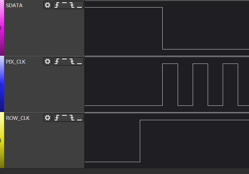

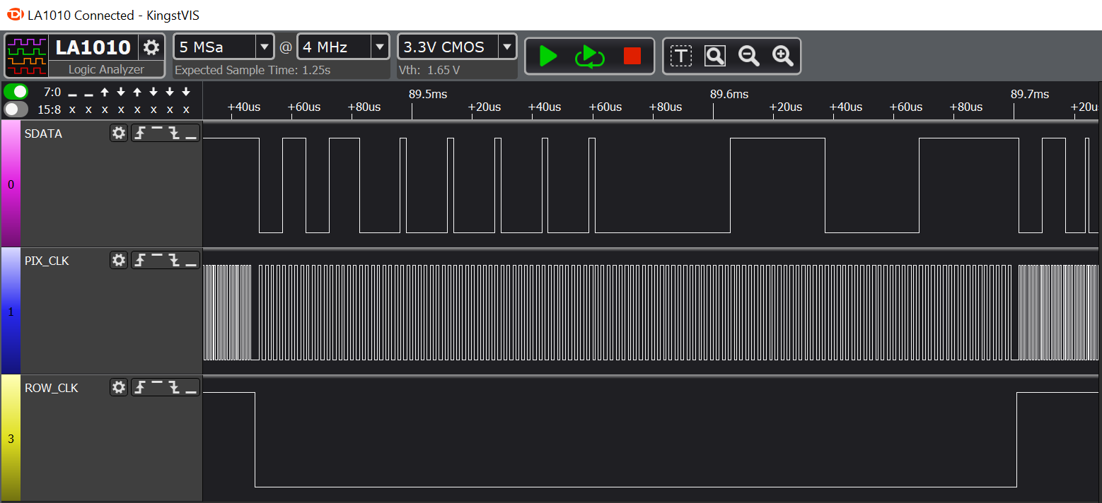

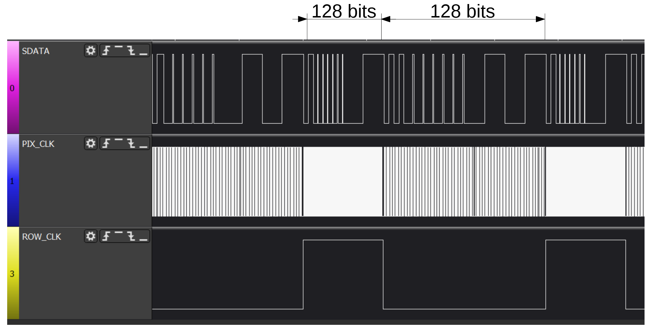

128bit frames.PNG (157.65 KiB) Viewed 3555 times
Not sure how to make it work as one frame is 128 bytes, and ws (ROW_CLK) flips each frame. It seem I should be able to configure this as 32-bit/sample, and 4 samples would make a full frame - and use LEFT/RIGHT channels for Frame 1 and 2? Does that make sense or is the largest a frame can be is 32-bits? Additionally the WS and BCK are not aligned like you see in the examples in the ESP32 tech datasheet.
WS and BCK.PNG (16.43 KiB) Viewed 3555 times
Also, left channel/right channel (in reality these are consecutive frames, the difference of the two make a pseudo grey scale) come in at two different clock rates (500kHz and 1MHz) though the doesn't seem like it should matter for slave receiving mode.
Can anyone assist in configuring i2s for this use case? Eventually I expect to use a queue to handle the reads instead of reading them in in the loop() function.
