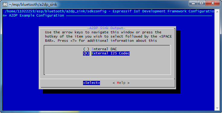

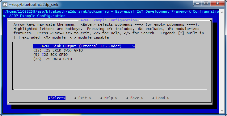

i have config the a2dp_sink example as like below
A2DP sink output as I2S codec;
GPIO setting :
| ESP pin | I2S signal |
| GPIO25 | LRCK |
| GPIO26 | DATA |
| GPIO5 | BCK |

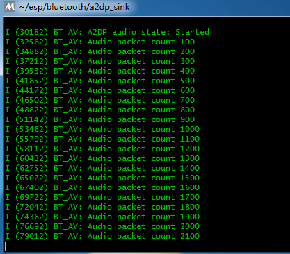

when bt linked to smartphone, while playing muisc, there is a log shows bt is works fine, but there is not any voice out!
does any wrong of the setting ?

Hi mkseven32,
Have you tried pipeline_bt_sink example instead?
The ES8388 codec on board of ESP32 LyratT requires configuration.mkseven32 wrote:when bt linked to smartphone, while playing muisc, there is a log shows bt is works fine, but there is not any voice out!

Re: why does esp32-lyrat running a2dp_sink example without output ?
I2S GPIO assignment of the ESP32 LyraT is listed under https://esp-adf.readthedocs.io/en/lates ... header-jp4 and your setting for the three I2S signals is the same.mkseven32 wrote: i just curious about whether the GPIO setting is right or not?
For the the 'pipeline_bt_sink' there is no need to configure I2S pins using menuconfig.mkseven32 wrote:Hi
do you mean the example of pipeline_bt_sink in the esp-adf ?
it is OK,but i found there is less info about make menuconfig in Readme file .
Related configuration is hidden in the driver 'esp-adf/components/audio_hal'

I (82147) BT_AV: Play position changed: 135496-ms
I (84077) BT_AV: Audio packet count 600
I (86077) BT_AV: Audio packet count 700
I (89407) BT_AV: Audio packet count 800
I (90387) RCTG: Volume is set locally to: 27%
I (90547) RCTG: AVRC register event notification: 13, param: 0x0
I (92287) RCCT: AVRC event notification: 5
I (92287) BT_AV: Play position changed: 145586-ms
I (92437) BT_AV: Audio packet count 900
I (95357) BT_AV: Audio packet count 1000
I (99237) BT_AV: Audio packet count 1100
I (100387) RCTG: Volume is set locally to: 31%
I (100547) RCTG: AVRC register event notification: 13, param: 0x0
