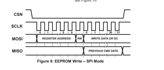

I am interfacing [ACS71020][https://www.allegromicro.com/~/media/Fi ... sheet.ashx] with ESP32. I code ESP32 using Arduino IDE. I want to interface this IC with ESP32 using SPI communication. Its SPI frame like below.
I need to send 7 bits of address 1 bit of read/write which makes 1 byte. But after that, I need to read 32 bytes of data from this IC or I need to write 32 bytes of data to this IC.
If I want to read 32-bits of data, I need to send dummy 4 bytes on the MOSI line so that I will get data on the MISO line. I don't know, which register to read in this case. Can you guide me on this, please? Or do you have better suggestion to interface this IC?

Re: Interfacing of ACS71020 using SPI
Did you understand all about of this information?
" The SPI frame consists of:
• The Master writes on the MOSI line the 7-bit address of the
register to be read from or written to.
• The next bit on the MOSI line is the read/write (RW) indicator.
A high state indicates a Read and a low state indicates a Write.
• The device sends a 32-bit response on the MISO line. The
contents correspond to the previous command.
• On the MOSI line, if the current command is a write, the 32
bits correspond to the Write data, and in the case of a read, the
data is ignored"
EEPROM/Shadow Memory range of addresses = 0x0B to 0x01F. (all with 32 bits)
Volatile Memory range of adresses = 0x20 to 0x31. (all with 32 bits)
You can write or read all of these memory registers.
First try - you must read the value = 0x4F70656E
Register 0x2F
Bits Name Description
31:0 access_code Access code register:
Customer code: 0x4F70656E
