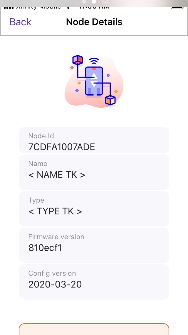

Hello Piyush & Thank you.
Unfortunately we see no deleter/remove button on "Node Details" page.

iPhone SE 2020
iOS 13.6.1
TIA - George

Re: Deleting RM nodes from RM cloud
Hi George,

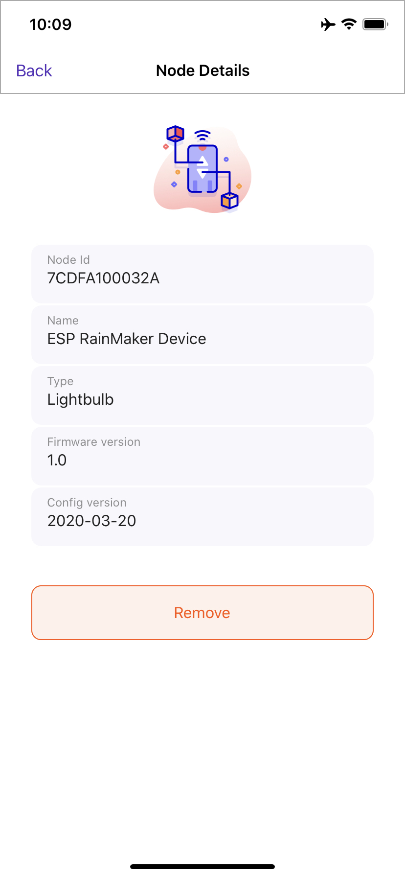

Thanks for sharing the screenshot. There indeed is some rendering issue with iPhone SE. The orange part you see at the bottom is the Remove button. Here is how it shows on iPhone 11.
We will fix this soon, but for the time being, can you check what happens when you tap on that orange part (or remove from some other phone/python CLI)?
LOL! Thank you Piyush. Yes it did work to tap at the bottom edge. It seems a bit shaky ... with a message something like ... "node does not belong to user." Also, FWIW, it is necessary to close the iPhone SE 2020 app and reopen it when it hangs on the 4 th step. - George
