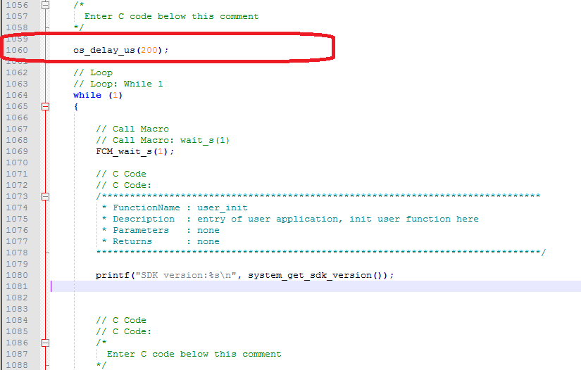

hi Mikhail,
not sure why .. looks like a linker bug to me...
code fails in delay itself.
btw : the wait makro FCM_wait_s(1) is without a function in this example.
thanks
rudi
user/.output/eagle/debug/lib/libuser.a(CSrc.o): In function `user_init':
g:\prem\MEINPR~1\user/CSrc.c:1060:(.text+0x8b): dangerous relocation: call8: call target out of range: ets_delay_us
collect2.exe: error: ld returned 1 exit status
make: *** [.output/eagle/debug/image/eagle.app.v7.out] Error 1
rudi
