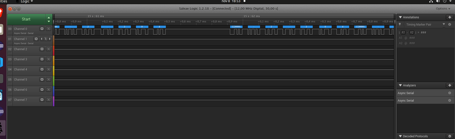

I first noticed the problem because the esp32 is receiving imcomplete messages, so I analyzed the TX, RX lines with a Logic Analyzer, and then I saw multiple discontinuities in the bits. I've contacted the other team for fixing this bug, but for now I need an workaround.
My workaround is to call uart_read_bytes() multiple times untill I receive the complete message, but this is taking way too long than it should, and I cannot figure it out why.

Here is an image showing what I mean by discontinuities.

Note that the UART has an internal FIFO buffer that hardware will try to fill up first before generating an interrupt: only after either the FIFO is decently full or the Rx line is idle for a wile will the interrupt go off. This is configurable, though.
