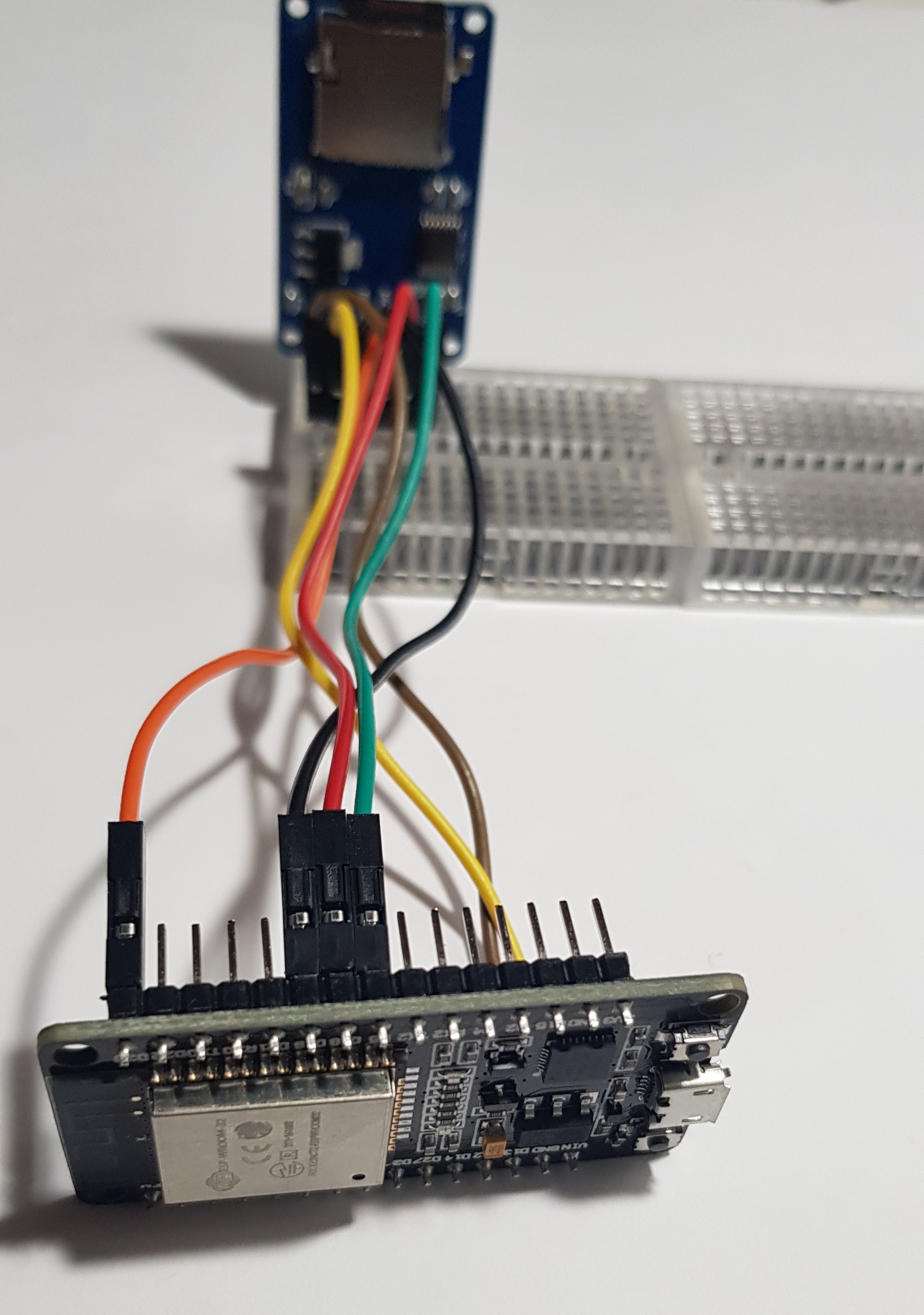

Hello, I am trying to setup SD CARD on ESP32 DevKit V1 board using esp-idf for some time but without success.
When I use Arduino IDE, the card works without issues (SD_Test example sketch).
When using esp-idf example sd_card, i get the following error message:
I (347) example: Initializing SD card
I (347) example: Using SPI peripheral
I (357) gpio: GPIO[5]| InputEn: 0| OutputEn: 1| OpenDrain: 0| Pullup: 0| Pulldown: 0| Intr:0
I (407) sdspi_transaction: cmd=5, R1 response: command not supported
E (427) sdmmc_common: sdmmc_init_ocr: send_op_cond (1) returned 0x107
E (427) vfs_fat_sdmmc: sdmmc_card_init failed (0x107).
I (427) gpio: GPIO[5]| InputEn: 1| OutputEn: 0| OpenDrain: 0| Pullup: 0| Pulldown: 0| Intr:0
E (437) example: Failed to initialize the card (ESP_ERR_TIMEOUT). Make sure SD card lines have pull-up resistors in place.
I have set the define:
USE_SPI_MODE
and configured pins as following.
#define PIN_NUM_MISO 19
#define PIN_NUM_MOSI 23
#define PIN_NUM_CLK  18
#define PIN_NUM_CS   5
Can someone help me out with this please?

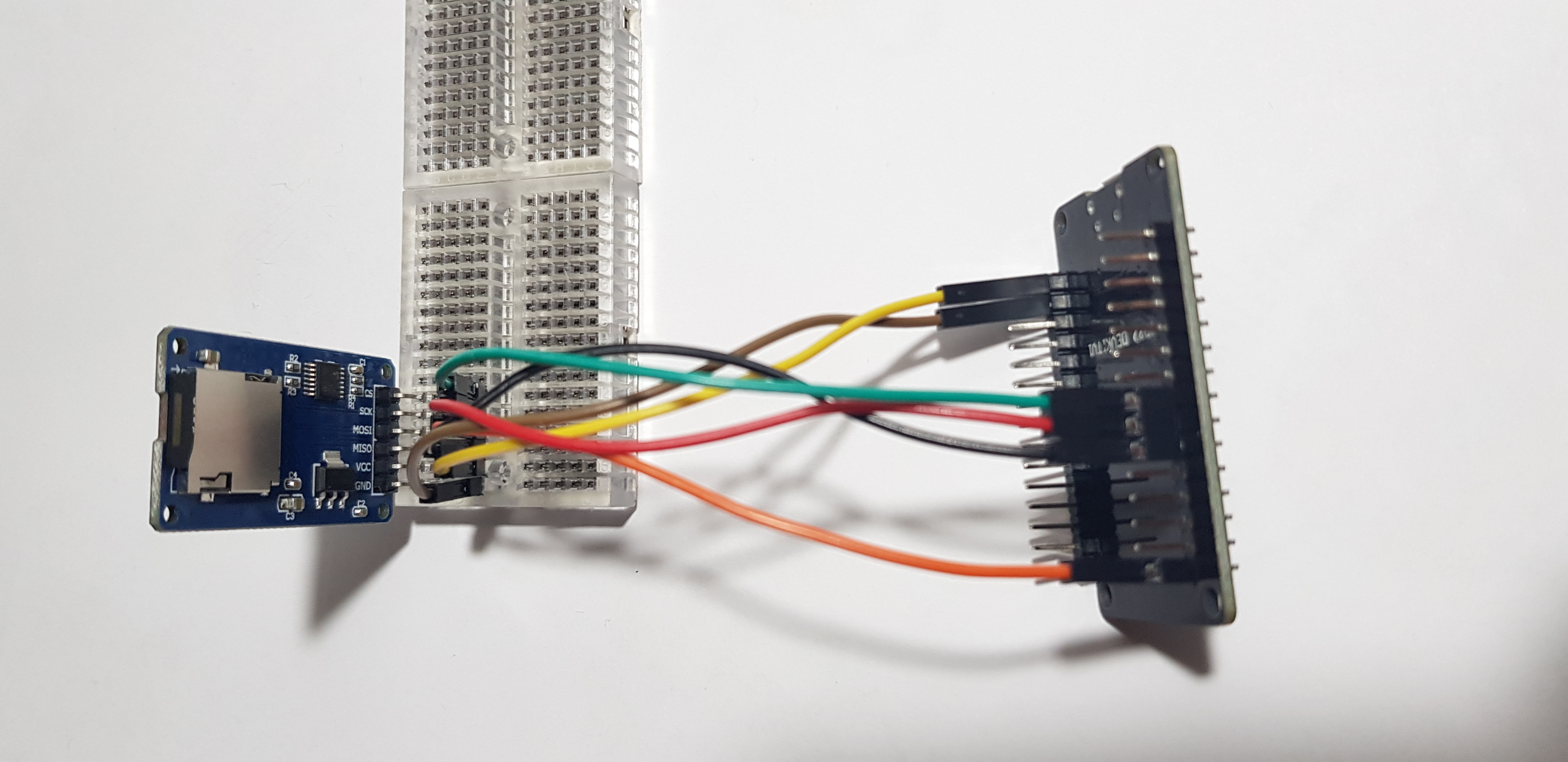

This image shows how I connected the shield:
Setup image (1)
Setup image (2)

Try a really, really slow SPI speed. Like 1MHz. This will help show that the issue is not hardware.

This is 5V SD card adapter.

Thanks! Once I decreased frequency it started working. I get max write speed (1024 to 4096 bytes chunks) at 41KBps. This seams low, any hints on how to improve?
It seams that this is not the issue.

I have an issue with robustness of this solution to sometimes fail mounting or writing to the card. I solved this by reducing as much as possible wires between esp32 and SD module and so far have not experienced issues.

The reason i mentioned about 5V for this sd card module is because i am using exactly the same module and it was the issue i had with it. I found the same answer on arduino-esp32 github. Im not saying it is/was the issue in your case, but i thought its worth to mention.
This module is using AMS1117 which characteristics says that Vin >= Vout + 1,5V.
