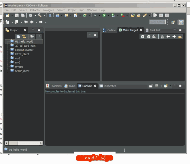

Re: using myapp eclipse esp-idf configuration as template - adding project folder
perhabs this helps:(B.t.w. I could not find the menu item "Make Targets" in eclipse Neon, but "Project Targets".)
project create make is
if you right click to an open project
and then you can selct make targets
the same is then in the right corner,
you see after open the project
your opended project right side in the "Make target" window ( outline..)
you can create new target here or with right click on the opened project
ok this is ok -
I keep all files and directories like it is described inthe guides above.
But:
I just want to organize my projects like this:
/home/development/workspace/esp32project_1
/home/development/workspace/esp32project_2
and so on.
as long as ecipse knows where your workspace is.
cause eclipse works with environment vars
${WorkspaceDirPath}/esp32project_1
can u pls post this error message?Now when I import one of these projects into eclipse as it is written here
http://esp-idf.readthedocs.io/en/latest ... setup.html
and try to build from eclipse I get error messages.
same here, can you post the error messageThen, when I do a clean and try to build from command line I get different error messages.
(Jumping between eclipse and command line, in order to build and flash a project in eclipse is quite tedious.)
example make a screen copy and save the picture
rudi
Hi there,
@Angus: Thank you for the info about the blue question marks.
(reminds me that I was standing in the wood and couldn't see the wood because of all the trees...
@Rudi: Your animated gif did the trick!
(In eclipse Neon.2 the menu item is called "Build Target". "Make Target" seems to be the previous naming).
Eclipse seems to be really picky. I reinstalled esp-idf, eclipse and created a new workspace.
checked all path twice.
Finally I got a running ide!
Thanks to all. This forum is a great help!
