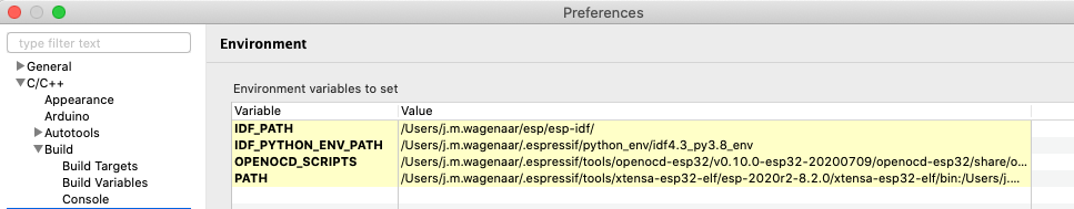

Verify Eclipses environment settings
I'd like you to check the Eclipse environment settings which may be left over from previous attempts. You can find them at preferences->C/C++->Build->Environment
Either this window is empty, which is okay, the plugin will add the values, or there are paths here already. If so, it will be comparable to my OSX settings:
Pasted Graphic.png (49.87 KiB) Viewed 10737 times
If there are values, verify/edit them so that they point to the new setup above. I suspect that you could also delete them and install the plugin but I never tried that.
