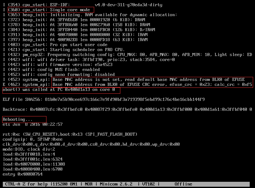

一、基本信息
1.模块:ESP32-WROOM-32X-TestBoard v1.1(ESP32-WROOM-32U)
2.使用例子:
例子1:/home/tony/esp/esp-idf/examples/wifi/scan
例子2:/home/tony/esp/esp-idf/examples/wifi/smart_config
例子3:/home/tony/esp/esp-idf/examples/wifi/power_save
3.使用menuconfig配置freertos
二、问题
为什么,试了3个例子,都是同样问题,出现:
Base MAC address form BLK0 of EFUSE CRC error, efuse_crc = 0x23; calc_crc = 0xf5
abort() was called at PC 0x400d1a13 on core 0
烦请帮忙提供解决办法,谢谢。

Postby Gargamel » Fri Nov 08, 2019 3:01 am
需要确认模组来源,方便的话请提供一下照片。
为了能正常使用板子的其他功能,暂时的 workaround 为使用用户侧的 mac,可以在 app_main 的开始添加以下代码:
uint8_t mac[6] = {0x12, 0x34, 0x56, 0x78, 0x90};
esp_base_mac_addr_set(mac);
注:以上代码仅供临时绕过该问题,进行其他功能开发,不可用于产品中。

用espefuse 工具查出来mac
espefuse.py get_custom_mac -p /dev/ttyS3Connecting........_____..
Detecting chip type... ESP32
espefuse.py v3.0
Custom MAC Address version 103: 00:00:00:07:8c:91 (CRC 0x00 invalid - calculated 0x57)
但是芯片上标记的mac 地址是04:cf:8c:21:80:63
我碰到的错误
I (633) wifi:wifi driver task: 3ffbab54, prio:23, stack:6656, core=0
I (633) system_api: Base MAC address is not set
I (633) system_api: read default base MAC address from EFUSE
E (633) system_api: Base MAC address from BLK0 of EFUSE CRC error, efuse_crc = 0x93; calc_crc = 0xcd
abort() was called at PC 0x4010b404 on core 0
0x4010b404: esp_efuse_mac_get_default at /home/cqh/workspace/esp-idf/components/esp_common/src/mac_addr.c:110 (discriminator 3)
