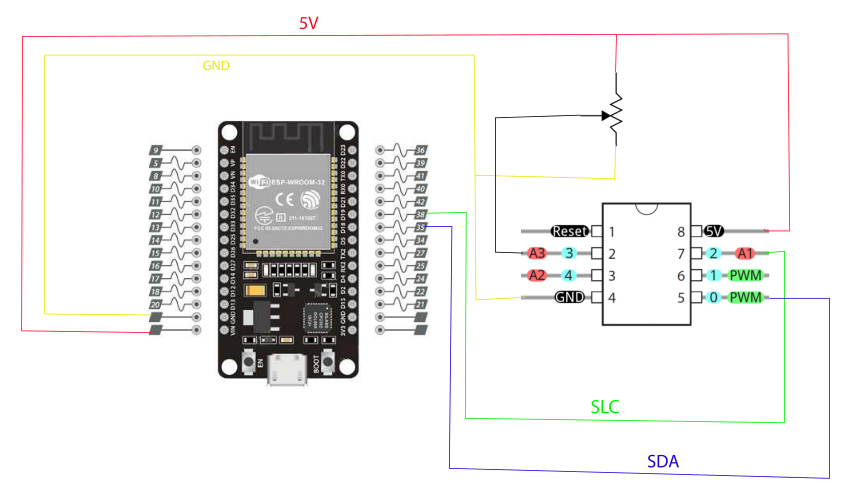

Hi all,
I'm having difficulties connecting a ESP32 to an attiny85 through i2C protocol.
The attiny was programmed with an Arduino UNO (in arduino IDE) and is programmed to read a current and send two bytes with the reading upon request as follows:

I cannot get the ESP32 to communicate with the attiny85.
The wiring diagram is attached.
Can you please help? What am I doing wrong?

Posts: 10609
Re: ESP32 reading from Attiny85 sensor through I2C protocol
Postby Sprite » Tue Oct 06, 2020 7:05 am
First of all, I2C needs pullup resistors to Vcc to work. Suggest you add two resistors (anywhere between say 2.2K to 10K) to the SCL and SDA lines to 3.3V.
If that doesn't work: Can you expand a bit on what results you *do* get? Do you have a logic analyzer or scope to look at the signals?
boarchuz
Posts: 656
Postby boarchuz » Tue Oct 06, 2020 12:57 pm
Also the Tiny at 5V could well be a problem: a logic high on the I2C bus may not be high enough.
Investigate powering it from 3v3 or using level shifters.
I've tried pulling the SLC and SDA lines to 3.3V with 3k resistor on each line without success, I've also connected the tiny to 3.3V with the same result. I'm sorry but i do not have a scope to further troubleshoot the issue...
I've tried a check on the tiny with function i2c_master_cmd_begin() and it returns "ESP_ERR_TIMEOUT".
Can this be an incompatibility between the tiny being programmed by the Arduino Uno (through arduino IDE) and now being integrated with the ESP32 (through ESP IDF)? Or an incompatibility between my programming of the ESP 32 and the wire/tinywireS.h libraries used to program the tiny? I'm not really knowledgeable with the I2C protocol so there can be some specifications that I missed in the ESP32 programming that are not compatible with the tiny?
Considering that I'm not using wire library in ESP IDF, is my approach the correct to trigger the reading on the tiny that is waiting for a command equivalent to "Wire.requestFrom()"?
