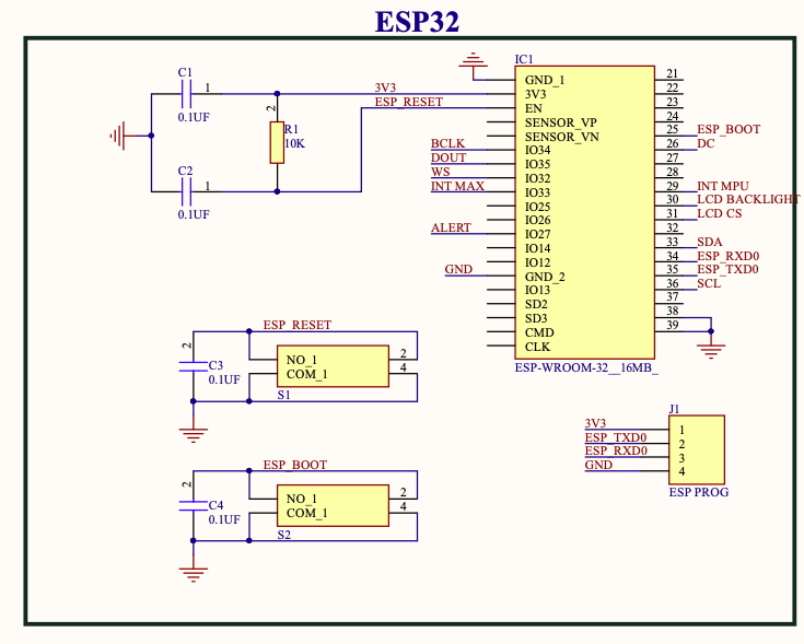

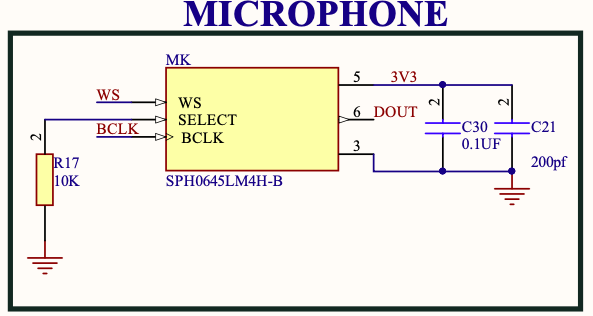

Re: I2S microphone (RX)
I am trying to connect I2S mic to ESP32 with no luck. (using SPH0645LM4H-B mic)
I am using the code below:
#include "driver/i2s.h"
const i2s_port_t I2S_PORT = I2S_NUM_0;

But on running it, I am getting 0 all the time.
Please Help me, I have to use this in my college project.
I have attached Circuit Diagram. Pl find it in the attachment.
