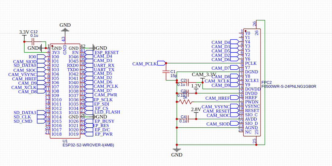

Based on the datasheet https://www.espressif.com/sites/default ... eet_en.pdf, page31, it is stated that I2S can be configured on any GPIO pins. Based on my observation on the camera pins connected to the few versions of the esps2-kaluga boards (https://github.com/espressif/esp-dev-ki ... ADME_cn.md), it seems that any pins can be used for the camera interface. Is my assumption right?
I wonder if it is ok to use the following pins (circuit diagram attached).
Thanks.
