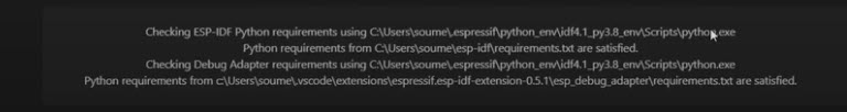

i cannot get the idf for vscode installed any help suggestions - i have tried a number of versions of python... I cannot get my setup to validate the python tools in the last step - it finds the python path for select python version (initial steps)to use and finds Git also no issues. i cannot get the idf to pass if all the tools exist - (at 3.19 in this video) any help suggestions - i have tried a number of versions of python... it fails in verification of tools. see attached image of what i cannot complete on my install
ERROR: Command errored out with exit status 1: 'C:\Users\Gregg\.espressif\python_env\idf4.1_py3.9_env\Scripts\python.exe' -u -c 'import sys, setuptools, tokenize; sys.argv[0] = '"'"'C:\\Users\\Gregg\\AppData\\Local\\Temp\\pip-install-elpd2cer\\psutil\\setup.py'"'"'; __file__='"'"'C:\\Users\\Gregg\\AppData\\Local\\Temp\\pip-install-elpd2cer\\psutil\\setup.py'"'"';f=getattr(tokenize, '"'"'open'"'"', open)(__file__);code=f.read().replace('"'"'\r\n'"'"', '"'"'\n'"'"');f.close();exec(compile(code, __file__, '"'"'exec'"'"'))' install --record 'C:\Users\Gregg\AppData\Local\Temp\pip-record-fmanvioo\install-record.txt' --single-version-externally-managed --compile --install-headers 'C:\Users\Gregg\.espressif\python_env\idf4.1_py3.9_env\include\site\python3.9\psutil' Check the logs for full command output.
WARNING: You are using pip version 20.2.3; however, version 20.3.3 is available.
You should consider upgrading via the 'C:\Users\Gregg\.espressif\python_env\idf4.1_py3.9_env\Scripts\python.exe -m pip install --upgrade pip' command.
The following paths should be added to env PATH
.;C:\Python\Python39;C:\Users\Gregg\.espressif\tools\xtensa-esp32-elf\esp-2020r2-8.2.0\xtensa-esp32-elf\bin;C:\Users\Gregg\.espressif\tools\xtensa-esp32s2-elf\esp-2020r2-8.2.0\xtensa-esp32s2-elf\bin;C:\Users\Gregg\.espressif\tools\esp32ulp-elf\2.28.51-esp-20191205\esp32ulp-elf-binutils\bin;C:\Users\Gregg\.espressif\tools\esp32s2ulp-elf\2.28.51-esp-20191205\esp32s2ulp-elf-binutils\bin;C:\Users\Gregg\.espressif\tools\cmake\3.13.4\bin;C:\Users\Gregg\.espressif\tools\openocd-esp32\v0.10.0-esp32-20191114\openocd-esp32\bin;C:\Users\Gregg\.espressif\tools\ninja\1.9.0;C:\Users\Gregg\.espressif\tools\idf-exe\1.0.1;C:\Users\Gregg\.espressif\tools\ccache\3.7
esp pythom setup.jpg (13.03 KiB) Viewed 31887 times

I have two comments:
  • It's wonderful that Espressif is putting efforts into providing IDEs for ESP32 programming, and the tutorial videos are a great idea. I'm really interested in giving the VS Code version a try.
  • Unfortunately, I had an experience with VS Code Onboarding something like kc0skm's -- a complete mess on multiple trials, in spite of carefully replaying bits of the video and many attempts. There are many places where one can "go in the ditch" and no instructions on how to get back on the road, mostly having to do with environment variables and path names. I gave up after several frustrating hours.
The video in question is very nicely done and a pleasure to follow if everything goes right. But if the user has a question of interpretation about how to set a pathname, etc., there's no immediate second explanation. I know you can't anticipate every question a user would have or mistake they could make. but it would be very helpful to have the following at critical junctures: a sample correct input, and an immediate way to check that your input produced the correct result.
I also tried the Eclipse plugin and almost succeeded. Still have an issue of the wrong Python version being invoked (see separate post on this), but did get much closer on the first try.
