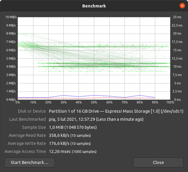

I just added sd card msc example to arduino EspTinyUSB library. It still requires to update local SD library in arduino-esp32, but using code later is very easy:
https://github.com/chegewara/EspTinyUSB ... sd_msc.ino
It is very slow to work with big sd card, like 16GB (it takes teens of seconds before you can use card, when you open root folder first time), but its working nicely and with small effort its possible to add "OTA" update with drag n drop.
Screenshot from 2021-02-05 12-57-47.png (144.16 KiB) Viewed 26977 times
