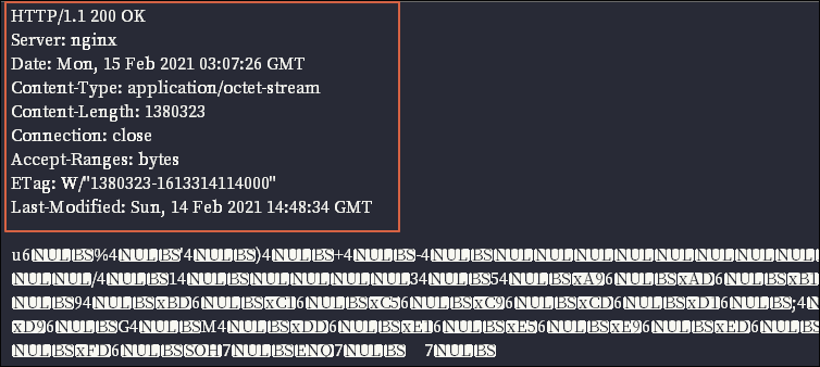

I just download file via WIFI from server.
and then saved it micro sd card.
(Use https request example.)
The problem is, the file saved with some sever information(or server response.) as like this
screen shoot
How solve this problem?
I use this two fucntion from https request example.
esp_tls_conn_write();
esp_tls_conn_read();
WiFive
Posts: 3529
Re: https down error
Postby WiFive » Mon Feb 15, 2021 2:51 pm
You have to either parse http yourself or use esp_http_client API
