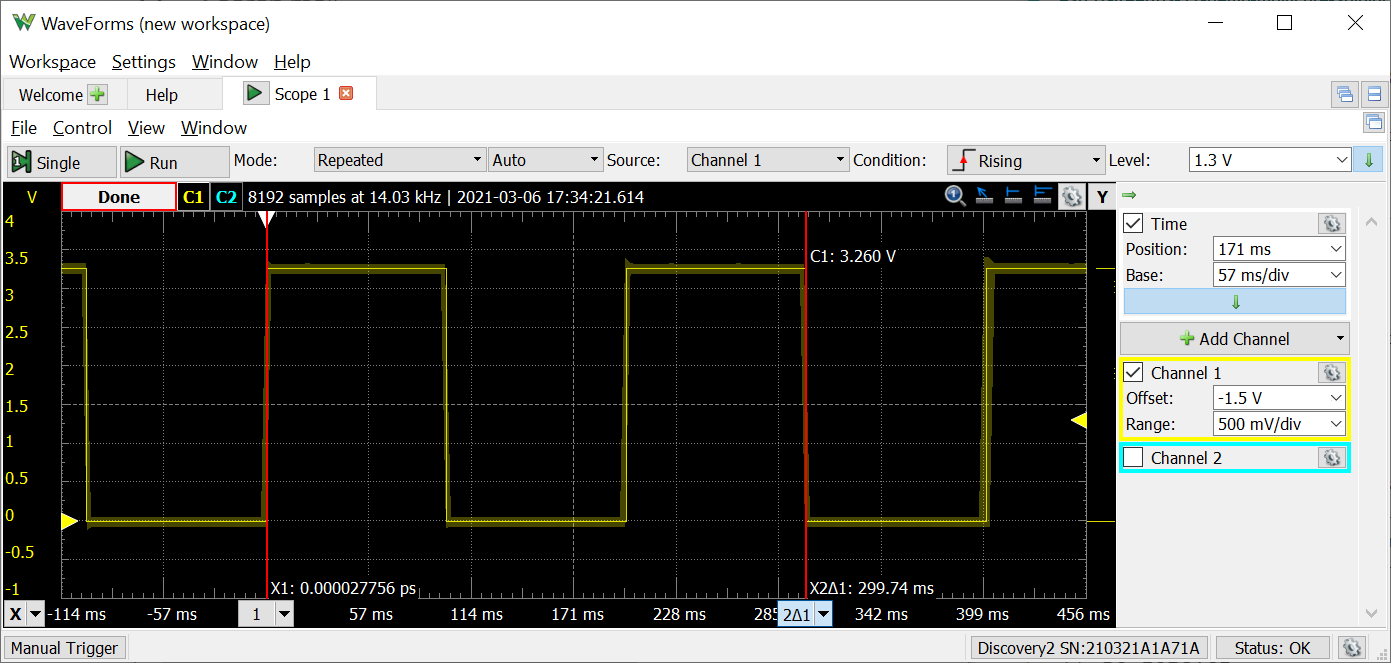

the code works as expected. I see
"Task 0 critical section...
...done"
being printed to the console and the LED pin toggling every 100 ms.

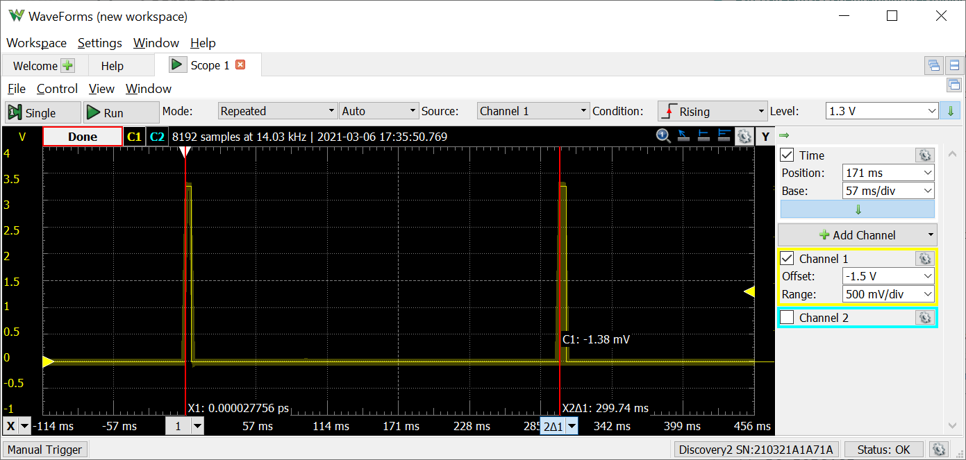

In some instances, yes, it is crashing with a "Guru Meditation Error: Core 1 panic'ed (LoadProhibited)" when I had Serial.print statements in the other core (inside a similar critical section). I didn't know that Serial usage was not allowed inside the critical sections at all, so thank you for that tip.
I removed all Serial.print lines and tried toggling GPIO pins in the different tasks (each in a different core). In Core 0, I perform the following sequence in a task:
  • Enter critical section
  • Set pin 12 high
  • Hog CPU for 200 ms (for loop)
  • Set pin 12 low
  • Exit critical section
  • Yield CPU for 100 ms

Without the critical section, both pins toggle as expected. When I include the critical section lines, pin 13 no longer behaves as expected. Instead of toggling every 100 ms, it turns on for 5 ms and then turns off for 295 ms. Here is the capture from a logic analyzer:

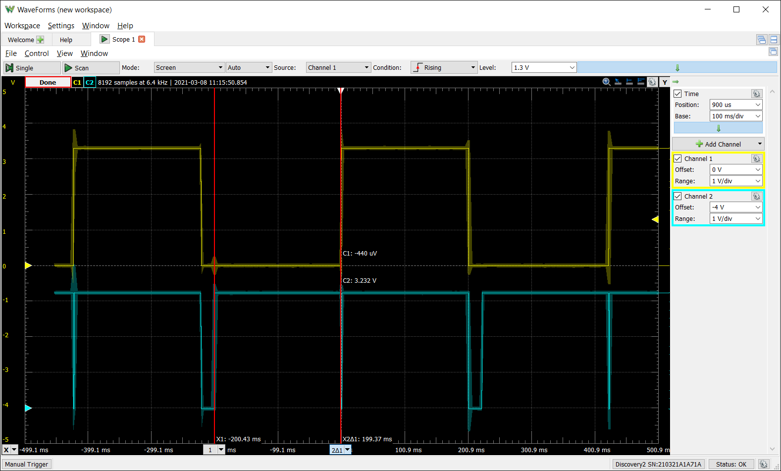

Thank you! That helps to make sense of what's going on. I moved the critical section to Core 1, and it worked as expected (as Core 0 could still update the timer variable). I also changed the toggle time to 30 ms for Core 0 so it's more noticeable on the scope.

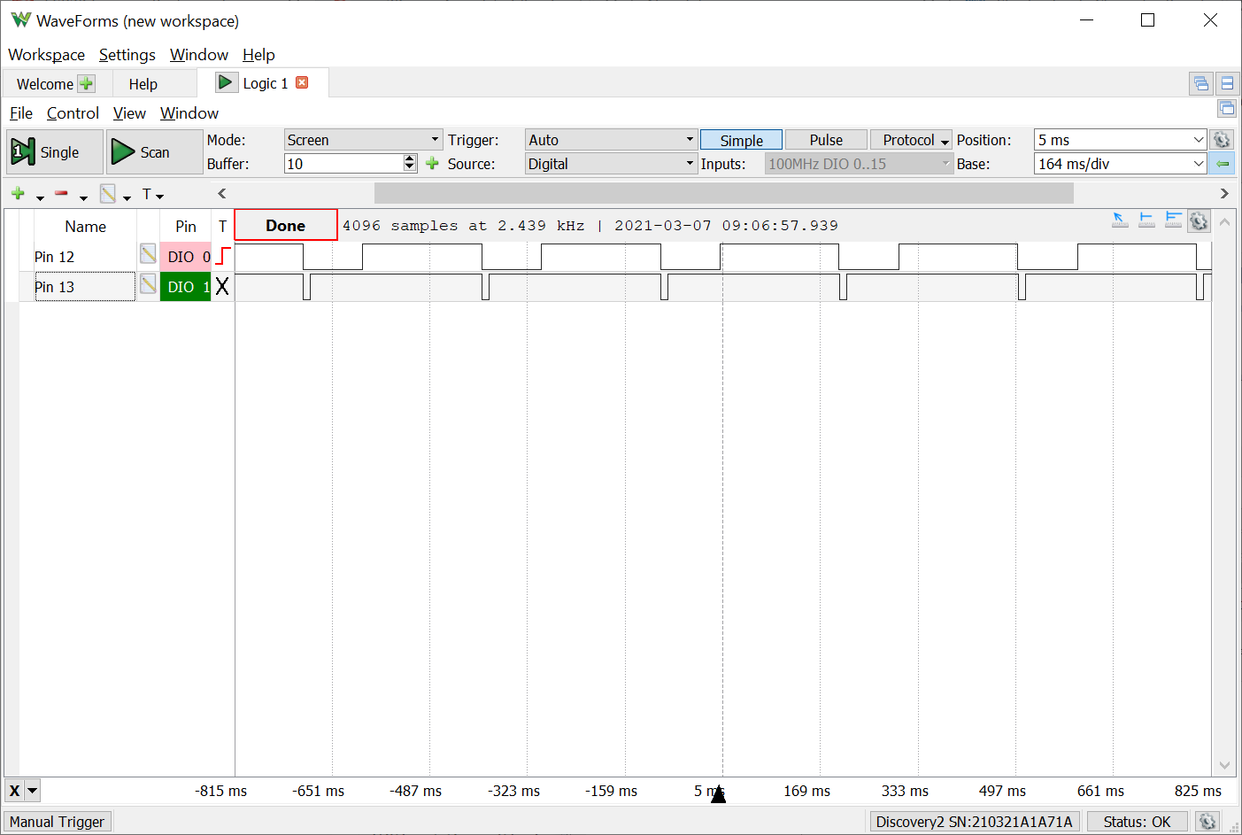

Next, I added critical section markers around the pin toggle in Core 0 to see what would happen (full code below). My expectation is that the pin in Core 1 would toggle as before (high for 200 ms in a critical section, low for 100 ms in the blocked state), and the pin in Core 0 would stay steady for 200 ms (while spinning) but toggle freely (3 times) while Core 1 was in the blocked state.
However, this does not seem to happen. When a core is spinning waiting for a spinlock, are interrupts enabled or disabled? I would have thought that they would remain enabled until the lock was obtained, but it seems they are disabled (as shown by my scope capture). The Core 1 behavior seems to indicate that the "fast forwarding" is happening while Core 0 is spinning waiting for a lock. Can you verify that this is the case? I'm having a hard time figuring out exactly how the "fast forwarding" process of the timer variable is happening.

Scope capture (pin 12 is on top, pin 13 is on bottom):
